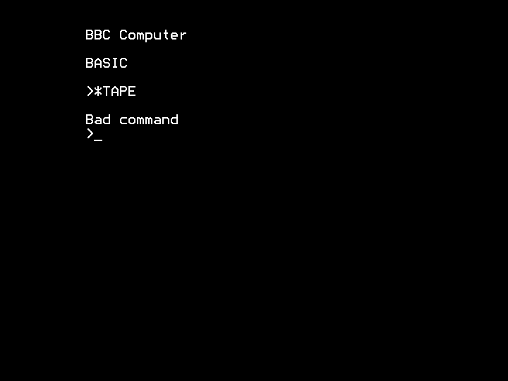

The next one is slightly strange, and I don't think it's interrupt related:
It seems to be something setting the overflow flag when it shouldn't.
Let me dig a bit further....

Here's a trace of this going wrong.

It looks like CLV hasn't cleared the V flag, as evidenced by the BVS E310 being taken, the resulting in a "Bad Command" error.
But this would get picked up by the Dormann tests, so it must be more subtle!
Dave

I can reproduce it in sims, but only with the PLA right before the CLV.

Ah, found the problem. In the ALU, I reconstruct the internal carry from bit 7 by XOR of both inputs and the output.
wire BC7 = adder[7] ^ R[7] ^ M[7];
Where 'M' is the last value read from memory. The problem is that I changed the ALU a while ago to use a separate register 'BI' instead of 'M', in order to speed up the BCD logic. I had forgotten to change it in the carry logic as well. Normally, that's not a problem, because M and BI will be the same. The problem is that the CLV is a single cycle instruction, which means that, unlike every other instruction, does not load the M/BI registers itself, but inherits them from the instruction before it. Edit: there are other single cycle instructions, obviously, but none of them use the M/BI register, because there's no time to load them in a single cycle.
Normally, that wouldn't even be a problem, but the CLV uses a trick to load V with the ALU overflow output, instead of clearing it to zero.
Quite subtle indeed, and only a problem for the generic code. The Spartan-6 specific code just grabs the value from the internal carry chain instead.
Fix in github.

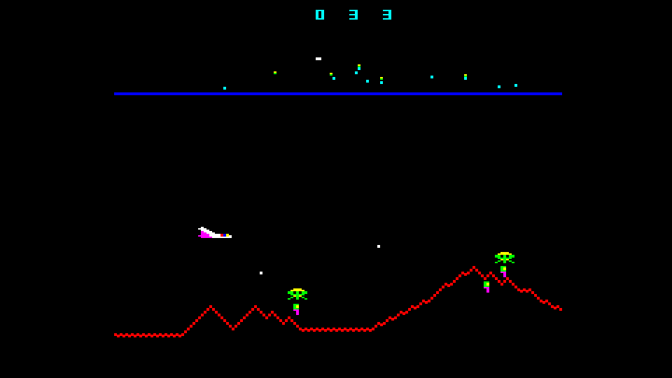

Arlet wrote:
Fix in github.

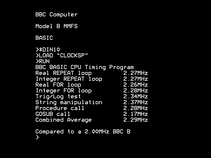

Great, now I can play Planetoid (badly!):
I'll let you know if I find anything else.
Next, to try running at speed!
Arlet
Joined: 16 Nov 2010
Re: My new verilog 65C02 core.
Post by Arlet »
I loved playing Planetoid when I was a kid. I didn't have a Beeb myself, but every Saturday I would go to this computer store where they had a bunch of demo machines set up.
