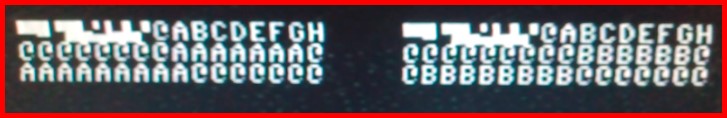

After a couple of days spent with the logic analyzer, I've positively identified the problem. When a ForceLoad is issued to a timer, when counting anything other than PHI2, if the ForceLoad is done one cycle before the timer underflow, the underflow is missed, and so is the interrupt.
On the left of the red bar, is a real 6526, on the right, the 74HCT6526. The cycle highlighted in red is the cycle next to the forceload command. You can see /CS going down the cycle before, with the register 15 selected (Control Register B). TimerB output is active on PB7, and even though a ForceLoad was done, the underflow takes precedence. A Timer pulse is sent, and this also triggers the interrupt.
However, on the 74HCT6526, no TimerB pulse is present on PB7, so no interrupt either. We need to wait to the next TIMERA underflow 0x10 cycles later to trigger a TimerB underflow, and then, the interrupt.
The issue comes from the "underflow&reload" segment of the timer pipeline.
Oddly enough, the underflow triggers on my Logisim model.
This test, morover, has undercover two more issues. Timer pulse is offseted by half a cycle. Also, not shown in the capture, when the ICR is read, /IRQ takes two additional cycles before clearing.
So close... yet... still so far!

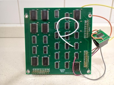

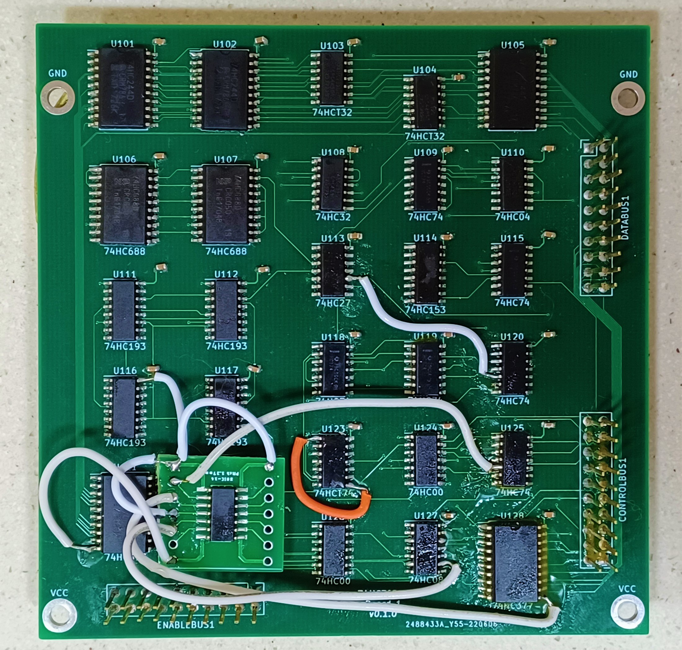

Back from the break, I devised a way to upgrade my current B1 Board from its current form (v0.1.1) to the version with this fix included, (v0.2.1).
This is how the board looked before starting the conversion. There's already an extra FF hanging from the board, with the second FF on the IC used by another fix in the ICR... So ugly!
Much better now. This is in fact the same version as before, but with a dedicated 74HCT74 for B1. I also tidied up the wires on the board.
And the, the final version, with the second FF added to delay ForceLoad, and with a few cut traces and bodge wires to amend my problems.

I first tested the full stack on my SBC6526. All good, hopes are high. Time to test on a C64... and boom. Nothing works. The whole stack misbehaves. Failures are intermittent. It kinda works... for a few tests then everything falls apart.
All the work has been done on B1, so I removed all the bodges, reflow all the ICs, added and rechecked all connections... and I was getting the same misbehaviour!
After two days of headbanging against the walls and no progress... I decided to give the board a deep and nice cleanup. All the works I've been doing, there was flux all over the places.
Unexpectedly, everything worked. It seems all the flux on the board was adding enough resistance that the LS logic in the C64 was not able to handle it, but all the CMOS parts in my SBC could.
So... clean your flux! That was two days lost! Shame on me!
But after the clean up... the success. With all the changes to B1, everything still is as cycle accurate as it was before, which is amazing. I still have the issue with the missed interrupt, just because it's TIMERB the one skipping it. I chose to make the changes to TIMERA first, as the board was already heavily modified.
