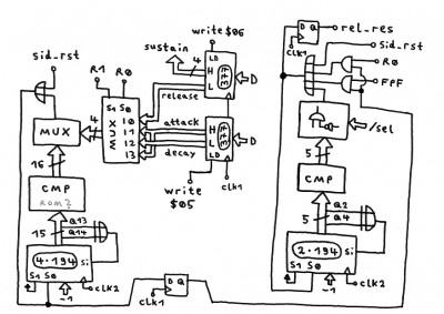

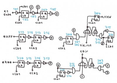

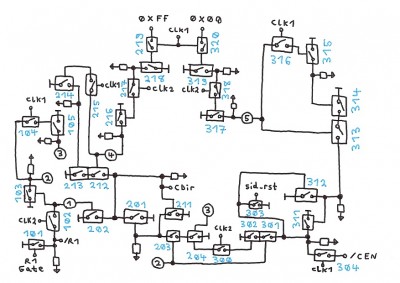

Back in 2016, when trying to draw a schematic for the SID envelope DAC counter control, to me the results somehow looked odd.
viewtopic.php?f=8&t=4150&start=90&sid=6 ... 0ec#p47184
After gaining some "mental distance" from this adventure, I eventually found the time to dig into that part of the silicon again.
First, a polygon picture with some parts not related to the circuitry to be dissected deleted:
Now for what I think that's supposed the equivalent of the circuitry drawn with switches and pullup resistors.
clk1 actually means sid_clk1, same thing for clk2 and sid_clk2.
Switches and resistors are placed in the schematic similar as they are placed in the silicon
Ignore that odd numbering convention, it's just that the chip layout is dense and a bit hard to follow,
so numbering the switches really is helpful for cleaning up the circuitry.

Looks like my schematic from 2016 is wrong... don't know if my schematic from 2017 is right.

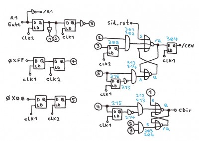

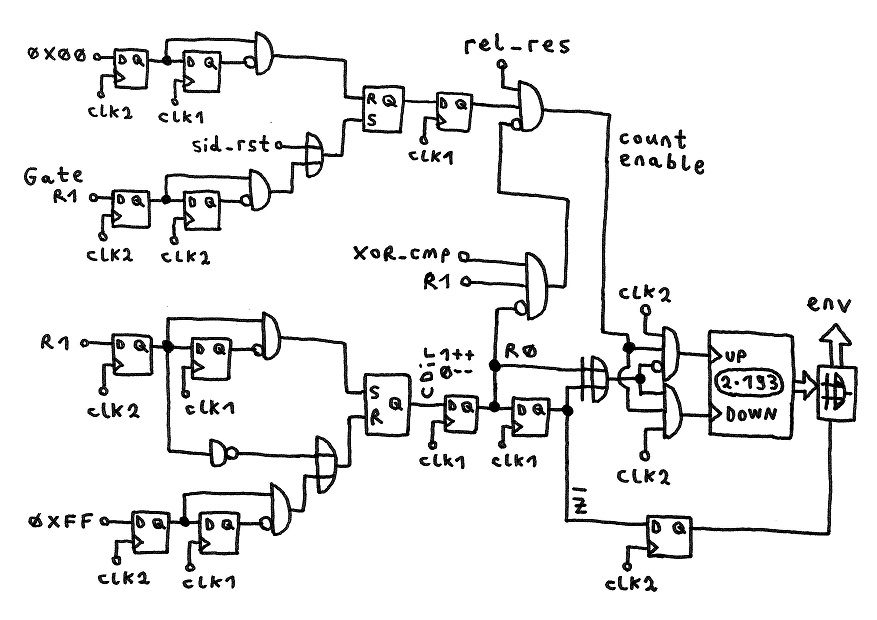

Just a little attempt for translating the envelope circuitry to sort of a TTL equivalent,
sorry for the bad quality of the pictures.
I'm sure, this stuff contains quite some errors, and probably a few of the flipflops could be optimized away.

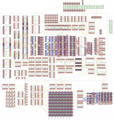

Since Drass is away for a while, I have tried to "translate" some of the results of our SID dissection into sort of a conceptual TTL schematic.
Pre_Farnell Eagle 6.4, because I happen to have the full version and I'm used to it (as in "drawing goes faster this way").
SID_8580_TTL_ConceptualSchematics.zip
(277.27 KiB) Downloaded 252 times
Edit: sid_main.sch, page 7:
Looks like something went wrong with the notation of the signal names: A0..A4, should be _A0.._A4, sorry.
Anyhow, it's only a "test balloon".
Decided to aim for the 8580, because I lack some info for implementing the 6581 filter.
Nevertheless, resistor values in the waveform selectors are like in the 6581, take care.
Schematics are _not_ verified, and I shouldn't try to do a verification because I'm too deep into these schematics.
Would be better to check if 'PHI11' and 'PHI22' are assigned correctly to the circuitry.
Schematics might contain some errors, and I wouldn't trust the envelope control circuitry too much.
Really, you better question/doubt anything in the schematics. Take them with a grain of salt.
Couldn't resist "to try making the bus interface 20MHz", because we have that 20MHz TTL CPU.
Of course, the oscillator\envelope logic probably won't be able to go faster than 2MHz,
running the design with two phase_synchronous PHI2 clocks (registers 20MHz, oscillator\envelope 1MHz)
might create some _other_ problems...
...also, because there probably won't be enough PCB space for even thinking about double buffering the control registers.

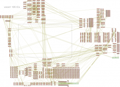

It's going to be a stack of four PCBs:
Three identical PCBs for the voices (oscillator + envelope + the related DACs), //3* 105 ICs
One PCB containing the bus interface, the filter and the rest. //1* 56 ICs
Since the schematics are not verified, it doesn't make sense to spend any thoughts yet on if/how that stuff might be going to fit on the PCBs,
371 ICs in total, have fun.
Bus interface, with the wrong sort of connectors of course:
One voice, three such PCBs required. //Note the massive use of BAS40-05 and BAS40-06 Schottky diodes.
It's a beauty... at least to fans of Boris Karloff.
Edit:
After some tinkering with the 'voice' schematics and PCB layout, I would dare to say that there is no way to squeeze this into a 160mm * 100mm form factor.
I'm sorry to say this... but maybe we should spend some thoughts about an alternative concept.
