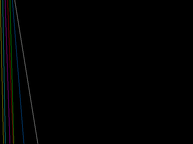

I've added support for drawing multiple lines on the fly, like in a vector display. Sources on github. Here's a still image, but the slope of the lines is adjusted every frame, so they move on the screen.
I noticed that the bottom line sometimes flashes on. It looks like this happens when a line crosses the bottom right pixel. Also, on the very right, you can see some stray pixels (not in this picture, but only at some line angles)

I've tested for shorts on the /Program line on the 2 bare boards I have and found none.
I happened to download your newest github post about 30 min's ago. Works good, except when dy>dx. Also the white line looks 2 pixels thick. As you mentioned, I've also noticed the stray pixels on the very right edge, and flashing horizontal line on the very bottom.

Yes, the "dotted" line when dy > dx is a known issue. It's not hard to fix, but I decided to work on other stuff first. The other bugs I have no idea yet what's causing them. The problem is that it takes a while to show up, and simulating more than a few frames is a pain, so I need to set the initial conditions such that the bug appears right away.
Of course, I also need to provide proper start and endpoints, instead of extending the lines all the way across the screen. I didn't notice anything exceptional in the white line, but I'll take a closer look.

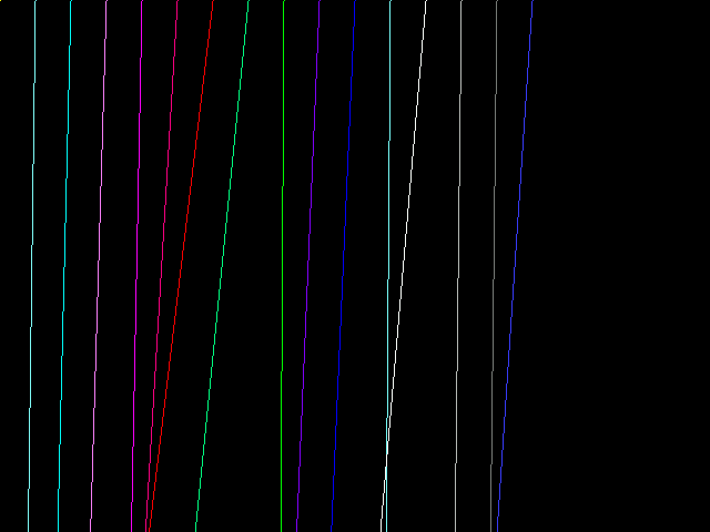

If you look closely, that results in stairstep patterns. Also I'm not supposed to have negative slopes yet :)
I've checked in a fix for the dy > dx case. I'll look at the other bugs after this.

Interesting to note also, the "random" pixels on the right are gone. Maybe a clue there even though the x <= x - 1 is wrong...

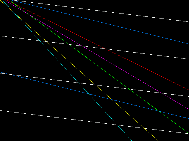

Fixed the flashing bottom scanline. I also don't see the stray pixels on the right anymore.
Edit: added support for negative dx, and added some more lines in the demo.

I was trying to add more lines too in order to see if it affected speed, I'll compare your code. Thanks!
I also traded out the DLL_SP for a PLL_BASE, even though the tools optimized it to a PLL_ADV. With the 7 lines the system can run @133MHz with 640x480 @25MHz pixel clock.
I got the resolution up to 1024x768 @71MHz pixel rate, but the system clock max with 7 lines is about 88MHz. It was a quickie test and it ran, but without switching all other parameters in your code, you can imagine it looks like a mess, but I could see the general behavior well.
I will try your new code now and observe top speed limitations at both resolutions.

Ah sweet! I kept the settings for 1024x768 and it still passes synthesis with no timing issues with the 16 lines.
