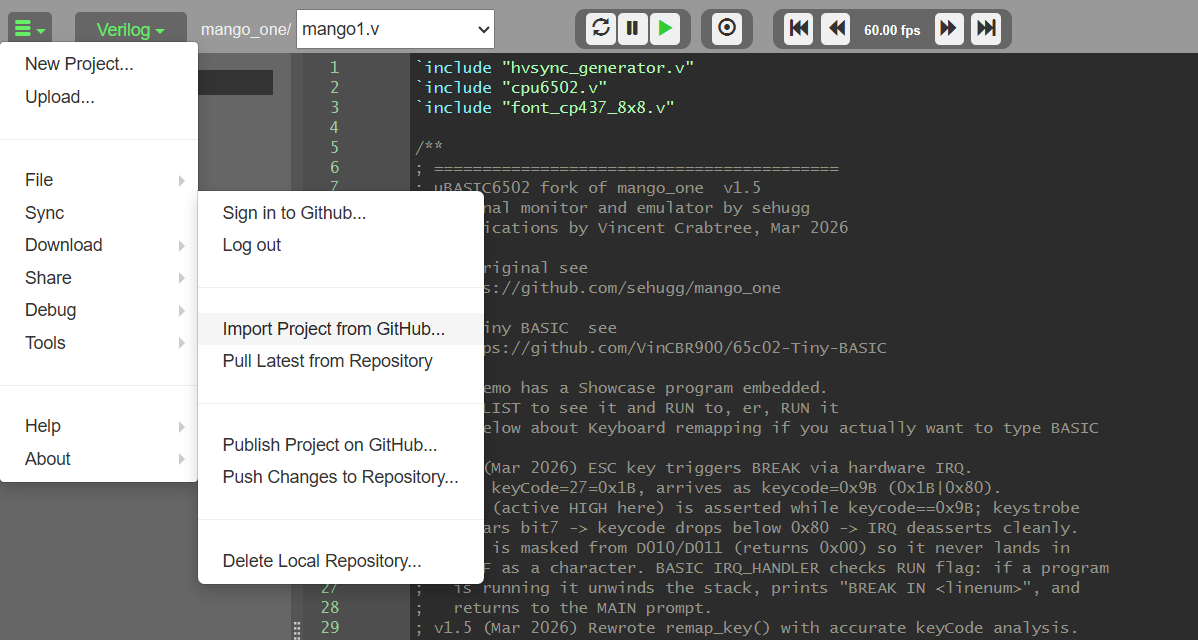

You can open this project in 8 Bit Workshop and try it Out.
http://8bitworkshop.com/v3.12.1/?redir. ... e=mango1.v
You should see a Green CRT on the right. Type LIST to view the embedded BASIC program and RUN to execute it - Pressing ESC aborts running program.

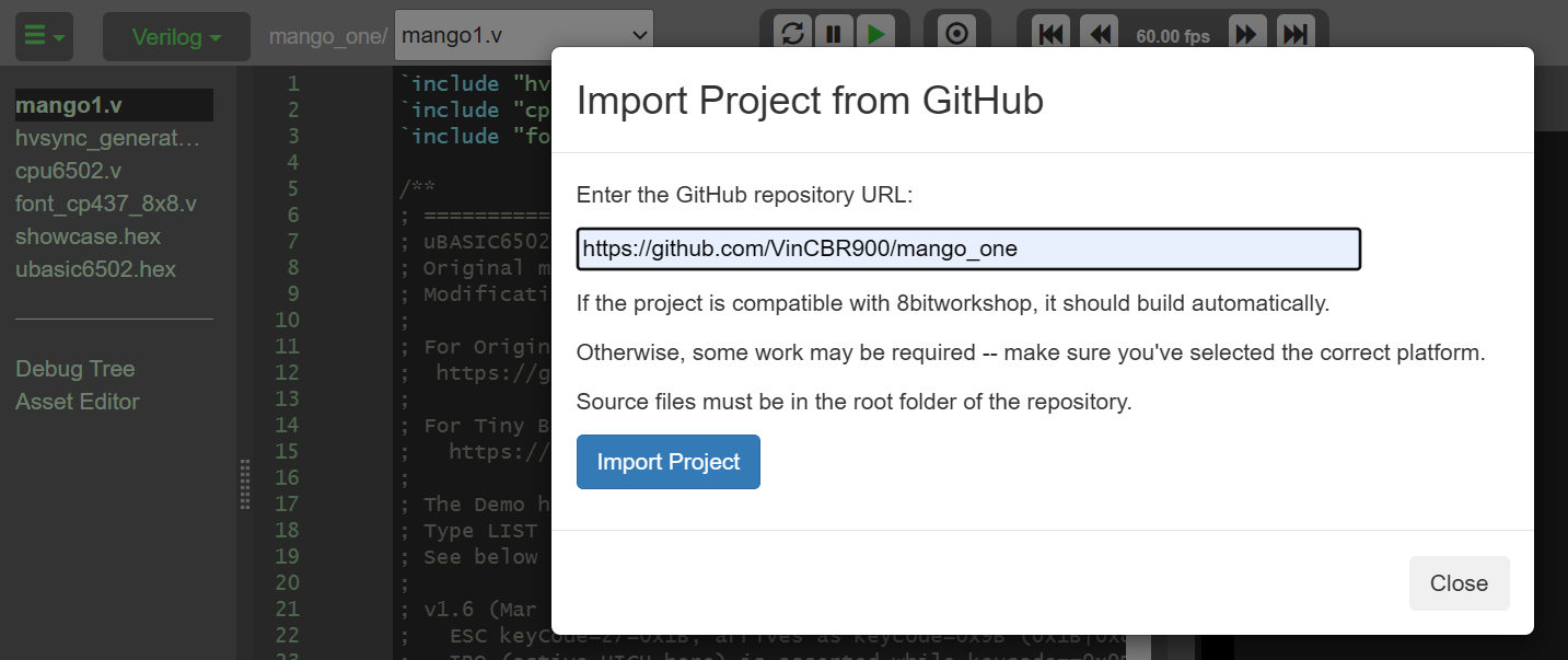

If you get Could not find file "mango1.v" error, Click on 3 bars -> Import Project from GitHub, enter https://github.com/VinCBR900/mango_one/
