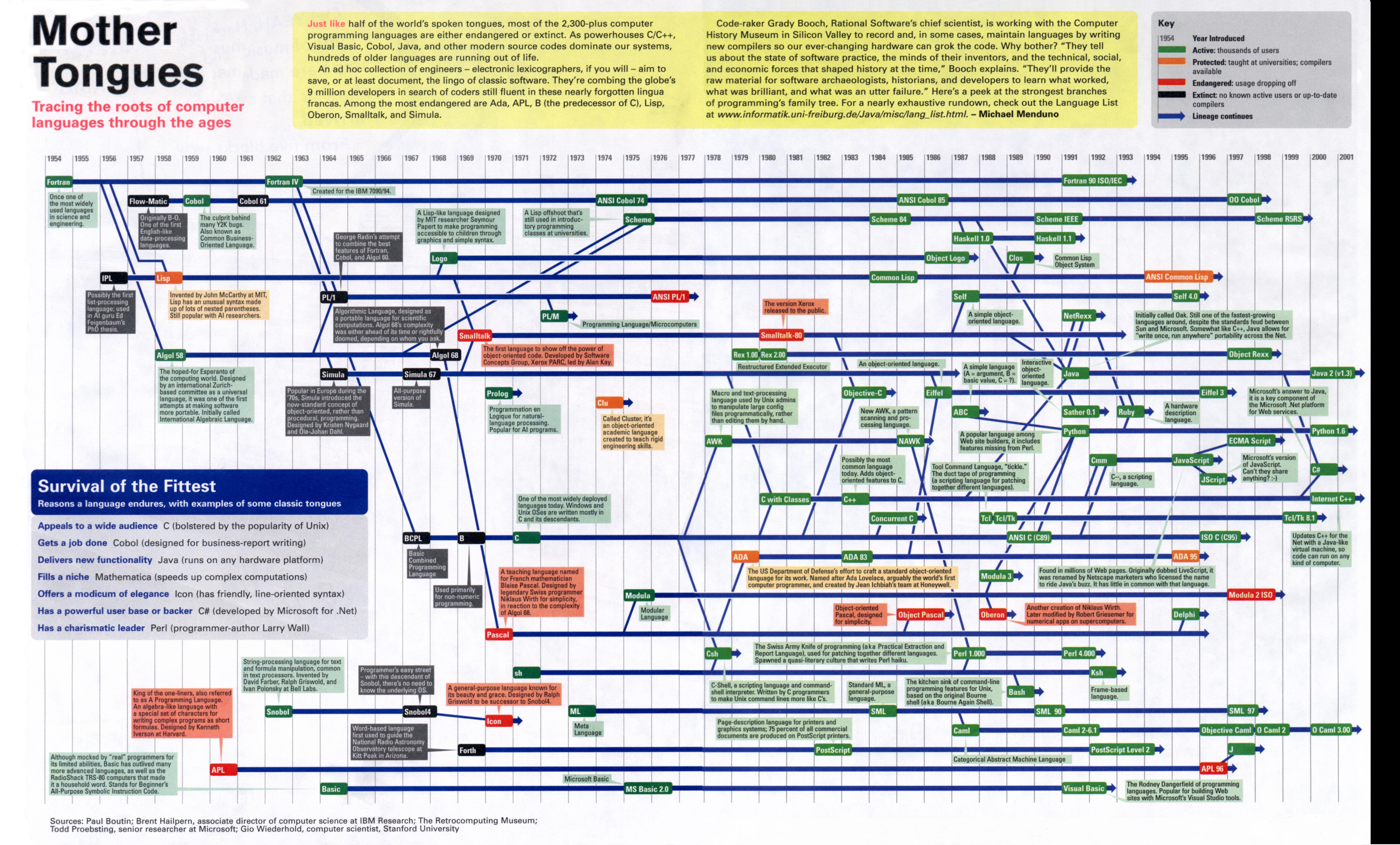

Re: dawnFORTH: Yet another crude Forth for the 65C02.
and got a good laugh out of it

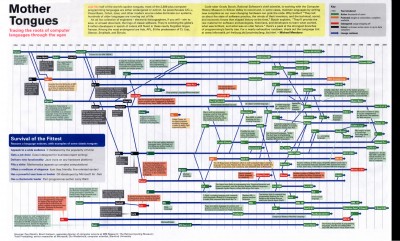

But before I read it I remembered I had another item related to the history of programming languages. My intention was to post the item, and FWIW I may as well go ahead (see below).
Forth appears as the blue line that's third from the bottom.
- BigDumbDinosaur
- Posts: 9425
- Joined: 28 May 2009
Interesting that your chart has no mention of the progenitor of all computer programming languages. Also, it completely misses the boat with BASIC, omitting any reference to the two principal timesharing BASIC versions that dominated minicomputers in the 1970s and 1980s, not to mention the various Micro-Soft renditions that shipped with many home computers.
Speaking of timesharing BASIC, I still do some work in Thoroughbred Dictionary IV, which is a powerful, semi-compiled form of BASIC that is capable of highly-structured code, as well as huge database management. It runs liked a scalded cat on my eight-core, Athlon-powered Linux server.
electricdawn
- Posts: 34
- Joined: 23 Nov 2025
What? Forth is extinct? And what about my favourite shell: Zsh. It's not even mentioned? Bah! *snort* I shun this report. SHUN it!
electricdawn wrote:
Forth [...] extinct
But before you shun the document, you might wanna double-check what it's trying to say...

Interesting that your chart has no mention of the progenitor of all computer programming languages...
Well, it says the lineage continues for Postscript, but the black icon of Forth indicates that it is supposed to be dead. >(
