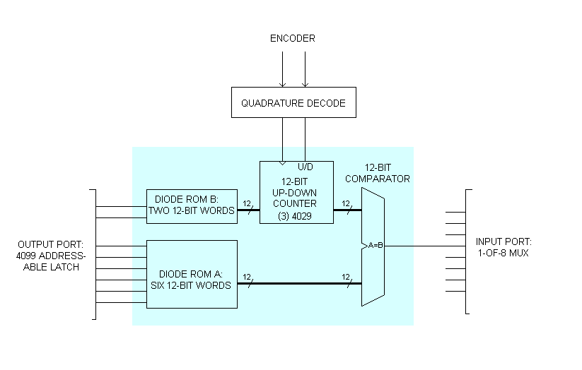

I'm late to the party, but maybe now is a good moment to slip in with another sublime/ridiculous case study on the diode ROM theme. :) The photos above show a circuit board with a diode array on one side and a DIP switch array on the other. Every diode has a switch in series, and the result could perhaps be called a PPROM, or Pencil-Programmable Read Only Memory! (Or, rather than a pencil, you could use a prod or other poking-tool instead.) :mrgreen:
I created the board to measure and control the motion of film in a giant camera used in the printing industry. My client wanted the camera to do double exposures (ie, "step and repeat"), and I was hired to retrofit this non-standard feature. (An engineer from the camera's manufacturer had already tried, but failed to achieve the necessary precision because his time delay-based approach relied on repeatable performance from the clutch/brake mechanism used to start and stop the film.)
My approach was to start and stop the film according to quadrature pulses from a rotary encoder which I added to the camera's transport mechanism. The block diagram below shows the counting logic, which used 4000 Series CMOS to evaluate 12-bit data words. The 12-bit counting mechanism was separate from the processor that did the actual sequencing of machine operations. The latter (located at the far right of the board) was an original, discrete-logic, 1-bit design running at about 100kHz! Quirky, but it worked. Nowadays I would use a different approach, but in 1981 (?) the available technology was rather limited, and so too was my experience. :roll: There's more on the project here.
Blk_Dgm excerpt.png (6.62 KiB) Viewed 451 times
