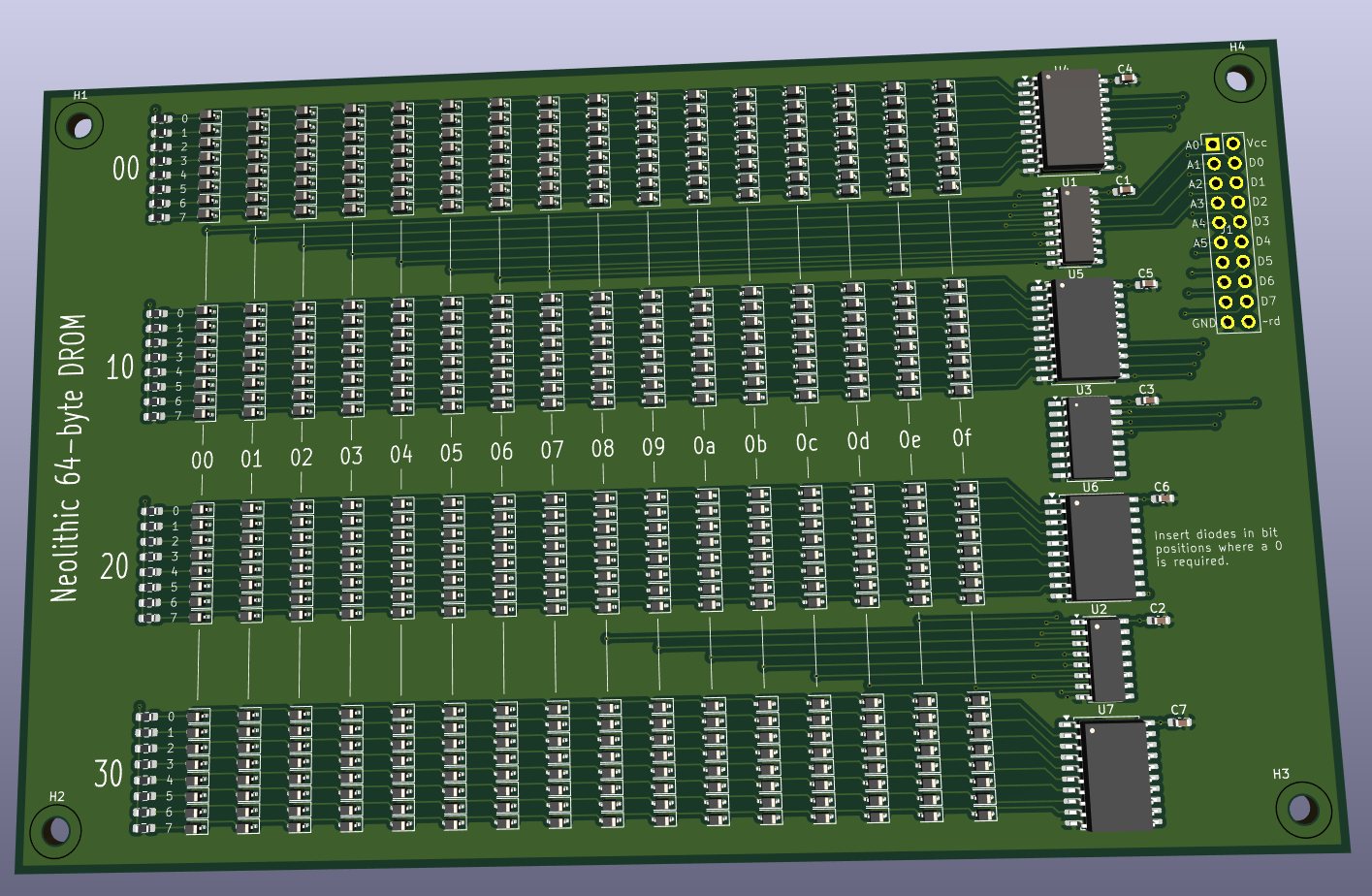

Aesthetic enough?
I extended it slightly to use the full eurocard; a second card would hold the processor.
Two '138s select one of 16 lines; four '541s and half a '139 choose the desired block. There's no 'chip select'; a single ~rd signal is sufficient.
With 10k pull-up resistors, I calculate a maximum current of 16mA (and an average of half that); speed should be on the order of 150ns. Reducing the resistor value will increase the speed (charging the input capacitance of the '541s faster) but also increase the current consumption.
As drawn, it requires a diode to be inserted where a zero is required in the data byte with the link left open where a one is needed. As an alternative, replace the '541s with '540s (inverting) to get ones where the diode is inserted.
If anyone wants the gerbers, let me know. I probably won't build this, but it would be nice to know if anyone does. The total cost looks affordable: JLC are quoting me ten dollars (plus postage) for five PCBs, and the BOM is around eleven dollars (minimum quantities of five for the chips and the connector, and a thousand diodes - probably enough for four ROMs), again, plus postage.
diode_prom.pdf
(1.89 MiB) Downloaded 31 times

(It occurs to me that there is half a '139 left over, and some spare input pins: one could supply A6 and A7 and select with a link to create a memory bank with the heady size of 256 bytes!)

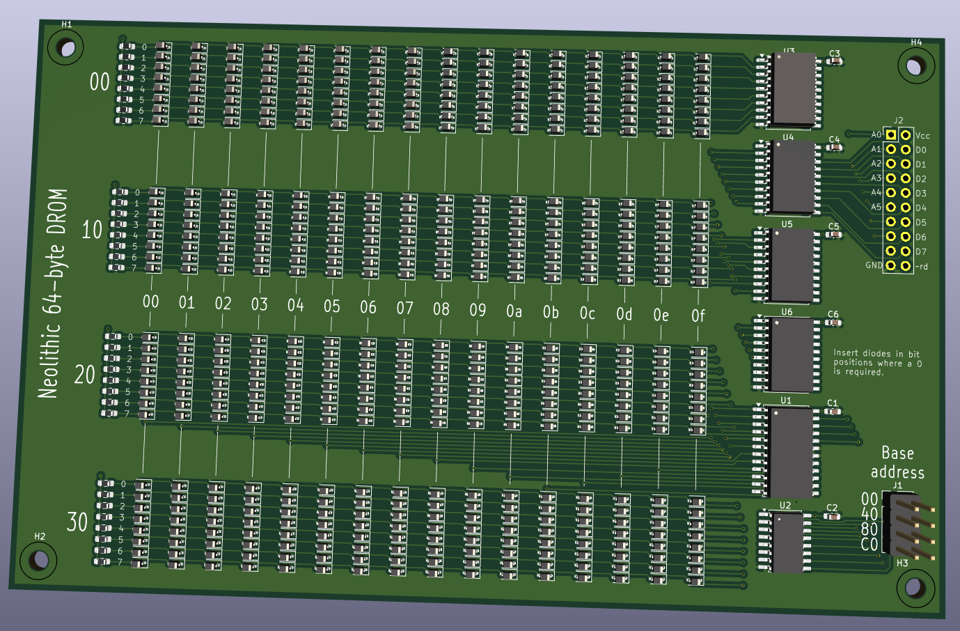

I played around with Garth's suggestion of the '154, and added a block select link.
I think that 64 bytes is as many diodes as can be _conveniently_ placed on one side. Using both sides will definitely require a four layer board - effectively, it's two of these glued back to back, and I think that's getting a little silly :) If you want more boot, build up to four of these for :shock: 256 bytes! :shock: (which, incidentally, was the total memory of my first computer).

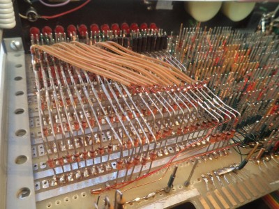

Posts: 3525
Re: From the sublime to the ridiculous - 8-byte PROM

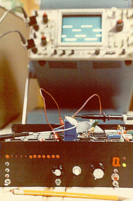

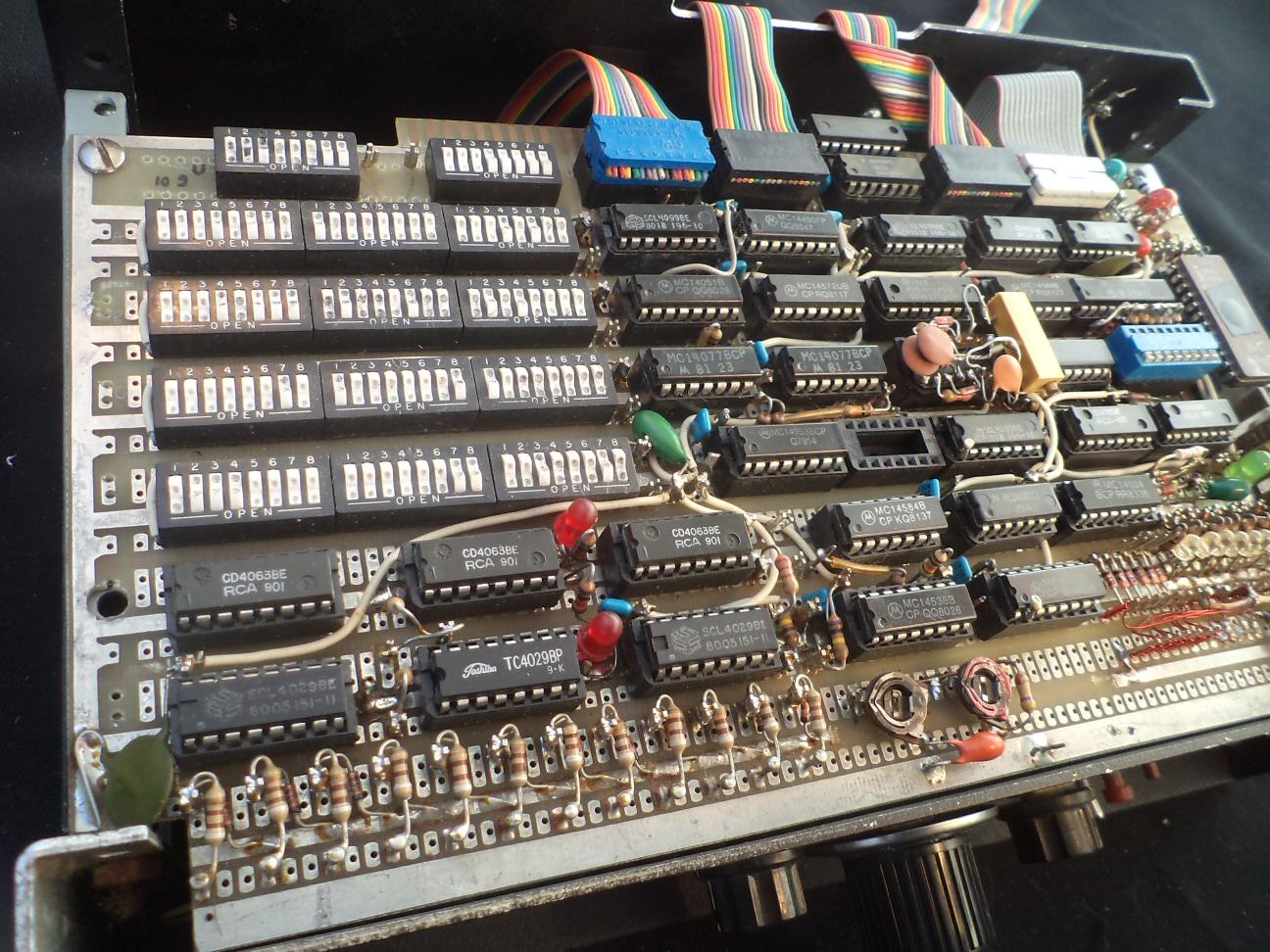

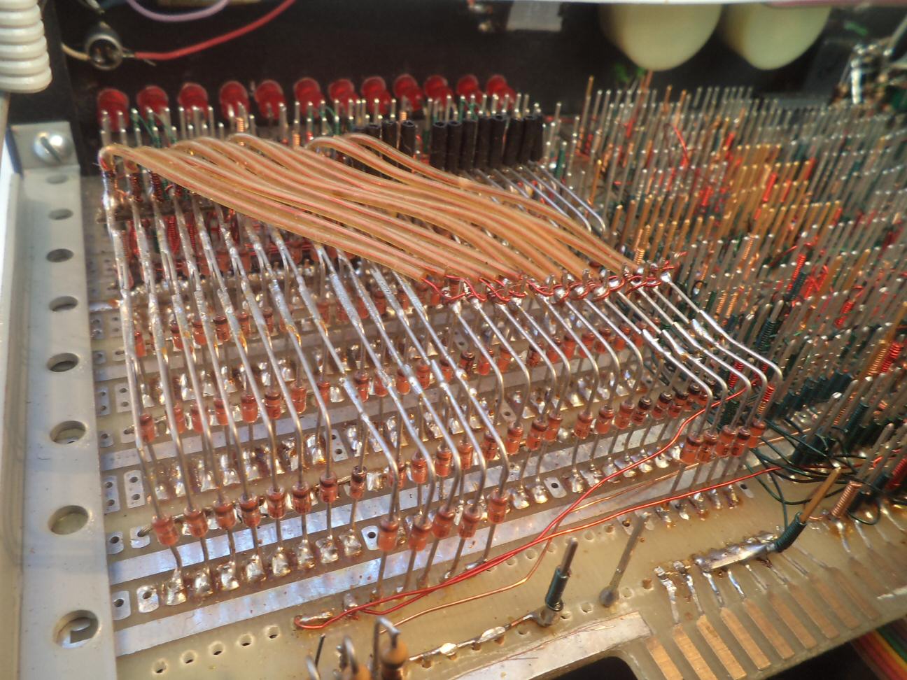

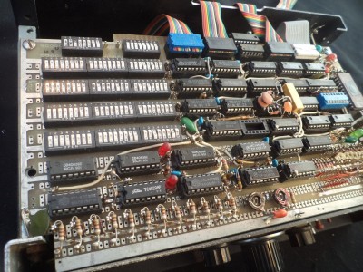

I'm late to the party, but maybe now is a good moment to slip in with another sublime/ridiculous case study on the diode ROM theme. :) The photos above show a circuit board with a diode array on one side and a DIP switch array on the other. Every diode has a switch in series, and the result could perhaps be called a PPROM, or Pencil-Programmable Read Only Memory! (Or, rather than a pencil, you could use a prod or other poking-tool instead.) :mrgreen:
I created the board to measure and control the motion of film in a giant camera used in the printing industry. My client wanted the camera to do double exposures (ie, "step and repeat"), and I was hired to retrofit this non-standard feature. (An engineer from the camera's manufacturer had already tried, but failed to achieve the necessary precision because his time delay-based approach relied on repeatable performance from the clutch/brake mechanism used to start and stop the film.)
My approach was to start and stop the film according to quadrature pulses from a rotary encoder which I added to the camera's transport mechanism. The block diagram below shows the counting logic, which used 4000 Series CMOS to evaluate 12-bit data words. The 12-bit counting mechanism was separate from the processor that did the actual sequencing of machine operations. The latter (located at the far right of the board) was an original, discrete-logic, 1-bit design running at about 100kHz! Quirky, but it worked. Nowadays I would use a different approach, but in 1981 (?) the available technology was rather limited, and so too was my experience. :roll: There's more on the project here.
Blk_Dgm excerpt.png (6.62 KiB) Viewed 435 times
