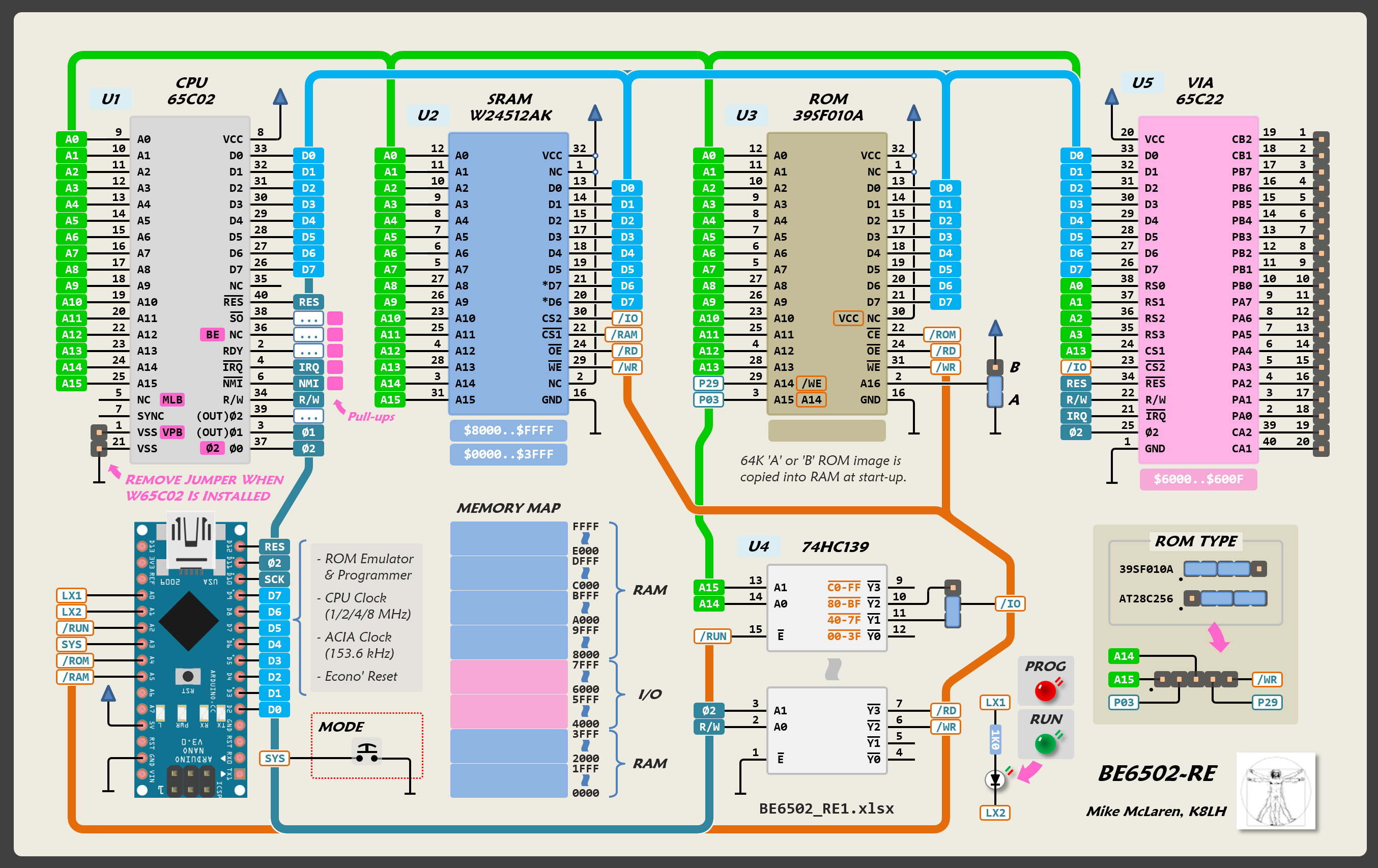

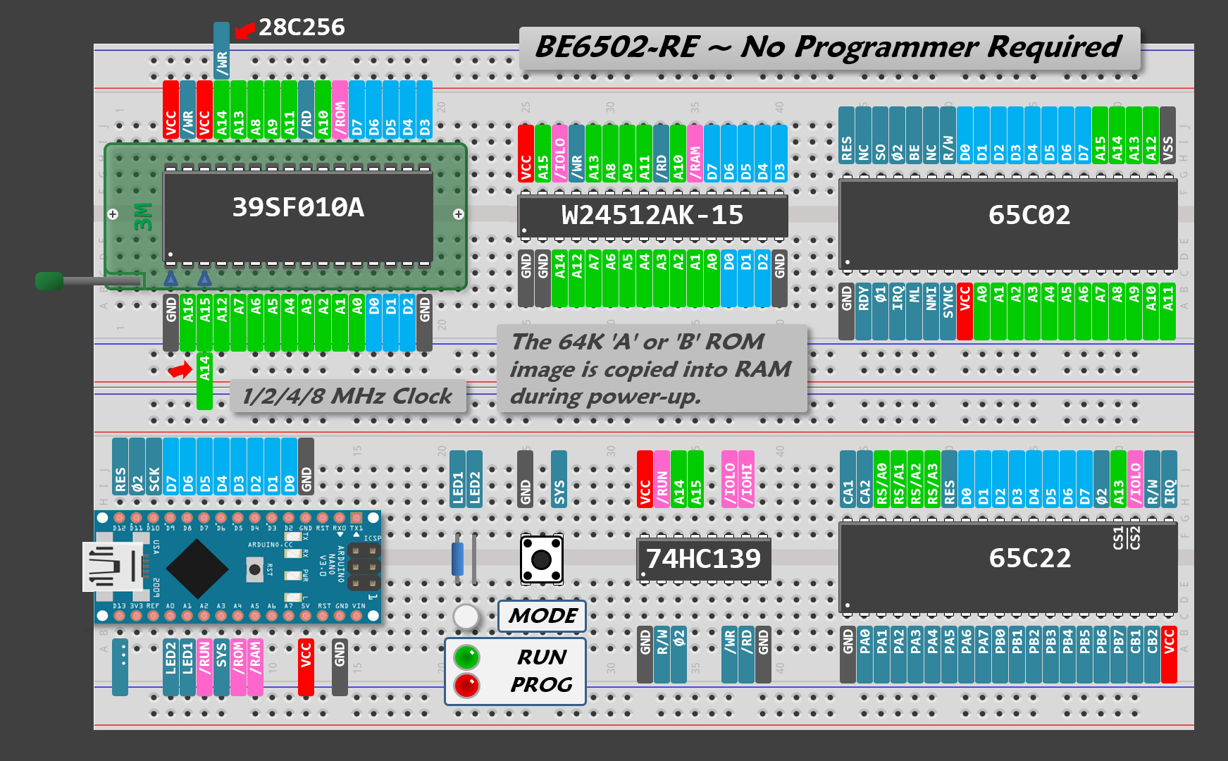

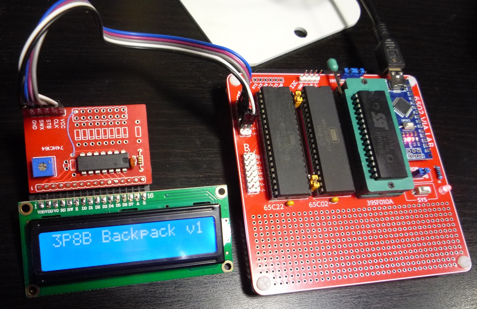

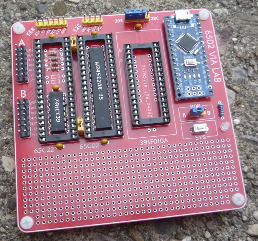

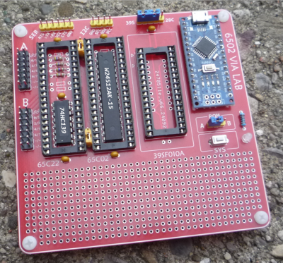

In the 1990s we had ROM emulators, and they are such a useful and obvious idea I'm sure they must have existed in the 1980s and 1970s too. Replace your ROM with a ribbon cable to a small board containing a RAM, some counters, and a little logic, with the other end plugged into your PC's printer port. In the 1990s we still had printer ports. Copy your binary to the printer device, press the reset button, and away you go.
I have to say having a full-blown ROM Emulator is a developer's dream. A simple push button press switches between Run mode and Emulator mode where I can download one or more code segments, iterative code changes, or full 64K code images directly into RAM at 115,200 bps via the ROM Emulator serial interface. I can also program the 64K 'A' or 'B' portion of the Flash ROM directly from the image in 64K RAM (takes about 9 seconds).
Have fun, guys. Cheerful regards.

@Michael
That is a facinating concept. Are you willing/able to share the code running on the nano?

(Indeed very nice project: it looks like Nano runs at 5V, so no difficulty with voltage levels. It looks like perhaps the Nano's USB connection is used to power the whole system, as well as the means of updating ROM images?)
Cheerful regards, Mike.
