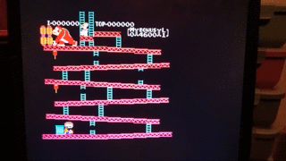

Here's an update!
I've slowly added features to my 'fake' PPU. In fact, I'm by-passing the whole PPU idea entirely! This might not be accurate later, but it seems to work really well right now. I now have backgrounds and sprites and most of their associated features.
On top of this, I figured out a way to 'double buffer' my screen so that I can draw to one while it draws the other, then switch. At 70 FPS (my screen's refresh rate) the game seems to run at 100% speed. If I drop it to 35 FPS it's definitely too fast which is a good sign.
But, as you might see with the attached GIF, Mario isn't moving, Donkey Kong gets him every time! He wants to run, but cannot. I've also tried Mario Bros, and the Kuppas just fall right through the ground, as does Mario. Very strange behavior. I'm thinking one of my instructions isn't right. I've tried a few test roms, and I think they are saying my CMP function isn't right.
Remind me again, is CMP the same as SBC but without changing A? On NesDev.org they have two different 'formulas': one for CMP and one for SBC. That might be because of optimization purposes, but a good reminder would be nice :)
Thank you everyone! It seems this project just might work in the end!

   cpu_flag_c = !(cpu_temp_result>0x8000); \
I haven't finished my first coffee yet, but something here seems a bit "off" to me ... and does your other code expect cpu_flag_v to be 0x80 occasionally?
Oh wow, good eye! I was directly copying it from NesDev.org (here https://www.nesdev.org/wiki/Instruction_reference#SBC), but they meant it as a boolean. I just used >>7 to make it result in 0 or 1 now. Thank you Mike!
Run the Dormann test suite! It’s the best way
I found that, but I didn't see an NES rom equivalent. I know it wouldn't be *too* much work to re-create for the NES, but I haven't ever used CA65 and it the macros are making my head spin :)
Small update: I got Mario to move in Donkey Kong now! It was something silly with my zero-page instructions I think, where I was sending a memory value instead of an address. Oh well! But Mario and the Koopas are still falling through the floor in Mario Bros. I've run a few other tests but I haven't found anything conclusive yet. I'm sure it's something small.
So, do I try to fix this issue with Mario Bros now? Or do I move on to other features like scrolling, controller input, and audio? I'm really wanting to make sure all of these basic games work well, and I have heard Mario Bros is one of the easier ones to emulate, so I do feel fairly obligated to sit on this one until I can get it to work right.

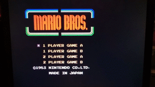

Well! THAT was a long time debugging :) Can you see what I was doing wrong?
Old Code:
#define CPU_ROL { \

New Code:
#define CPU_ROL { \
	cpu_temp_memory = cpu_read(cpu_temp_address); \
	cpu_temp_memory = (((cpu_temp_memory<<1)&0x01FF)|cpu_flag_c); \
	cpu_flag_c = (cpu_temp_memory>>8); \
	cpu_temp_memory = (cpu_temp_memory&0x00FF); \
	cpu_write(cpu_temp_address,(unsigned char)cpu_temp_memory); \
	cpu_flag_z = (cpu_temp_memory==0x0000); \
	cpu_flag_n = (cpu_temp_memory>>7); }
#define CPU_ROR { \
	cpu_temp_memory = (cpu_temp_memory|(cpu_flag_c<<8)); \
	cpu_flag_c = (cpu_temp_memory&0x01); \
	cpu_temp_memory = (cpu_temp_memory>>1); \
Answer at bottom!
Mario and Luigi are now running around smoothly, bopping Koopa's (and themselves)! Here's a short story of the journey:
So all of the sprite would just fall immediately to the bottom of the screen. Eventually they even started corrupting memory! In the disassembled code, I found where they check if a block is solid or not solid. I traced it backwards to a place where it was reading from PPU memory to know what that block ID was. I investigated and indeed all the block ID's were there, so it must have been accessing the wrong ones. Since I've programmed 6502 games before, I knew that the X and Y positions were being used to find which block, and the math to get to the correct result must have been wrong. What math do you need to convert 256x240 xy-position to a 32x30 coordinate system? Bit shifting! I checked ASL and LSR and they seemed fine, so I really honed in on the ROL and ROR instructions, and eventually found my mistake. Hm!
That was about 3 days of debugging I'd say. Wow. And I'm happy for it, because I fixed some other PPU issues along the way, so later games will work better now too.
There we have it :) Now onto more features. Thanks everyone!
Chad
Answer: I was overwriting the carry bit before shifting.

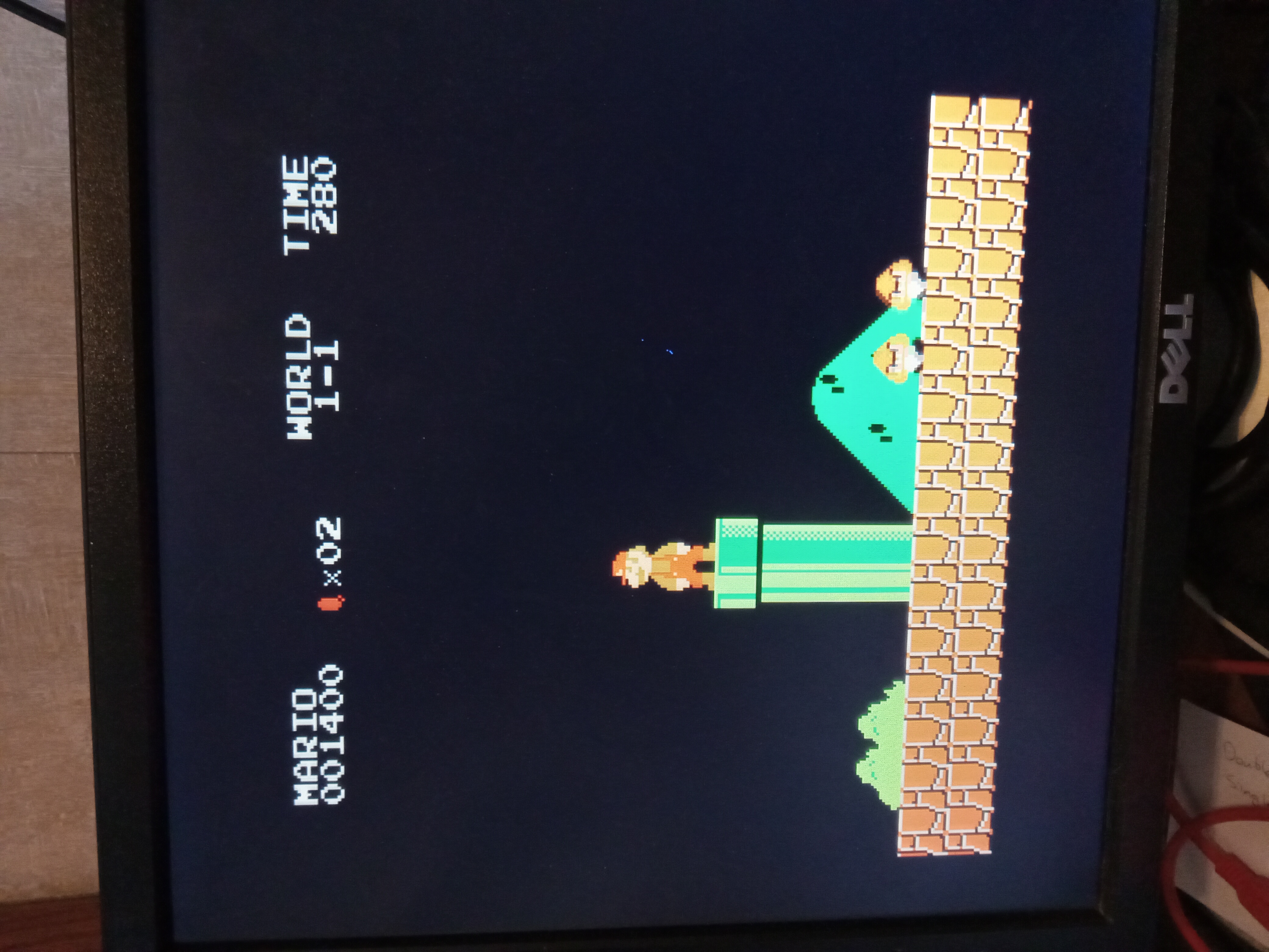

Alright! I have a "really nice" NES Emulator now! It currently only runs a bunch of NROM games, though even Super Mario Bros is pretty solid! The only issues left are that the audio makes a humming/clicking noise constantly, and there are some minor graphical issues still. Overall though it really is doing very well for what I previously had thought was impossible on this PIC32.
And I know what the issues are with the audio and graphics. The humming/clicking is due to an audio buffer overflow, which in theory shouldn't happen, but it is anyways. The graphical issues are mainly due to cycle and v-sync timing. I have to play with it a lot more to get it perfect.
For the past couple of days I have been REALLY figuring out this APU thing. I had to whittle down each tiny issue with each audio channel, and one of them took nearly 12 hours of debugging to figure out. Nothing is perfect, but at least it's close enough. I haven't been able to test the DMC audio yet, I'll try some specific game intros that use it soon.
