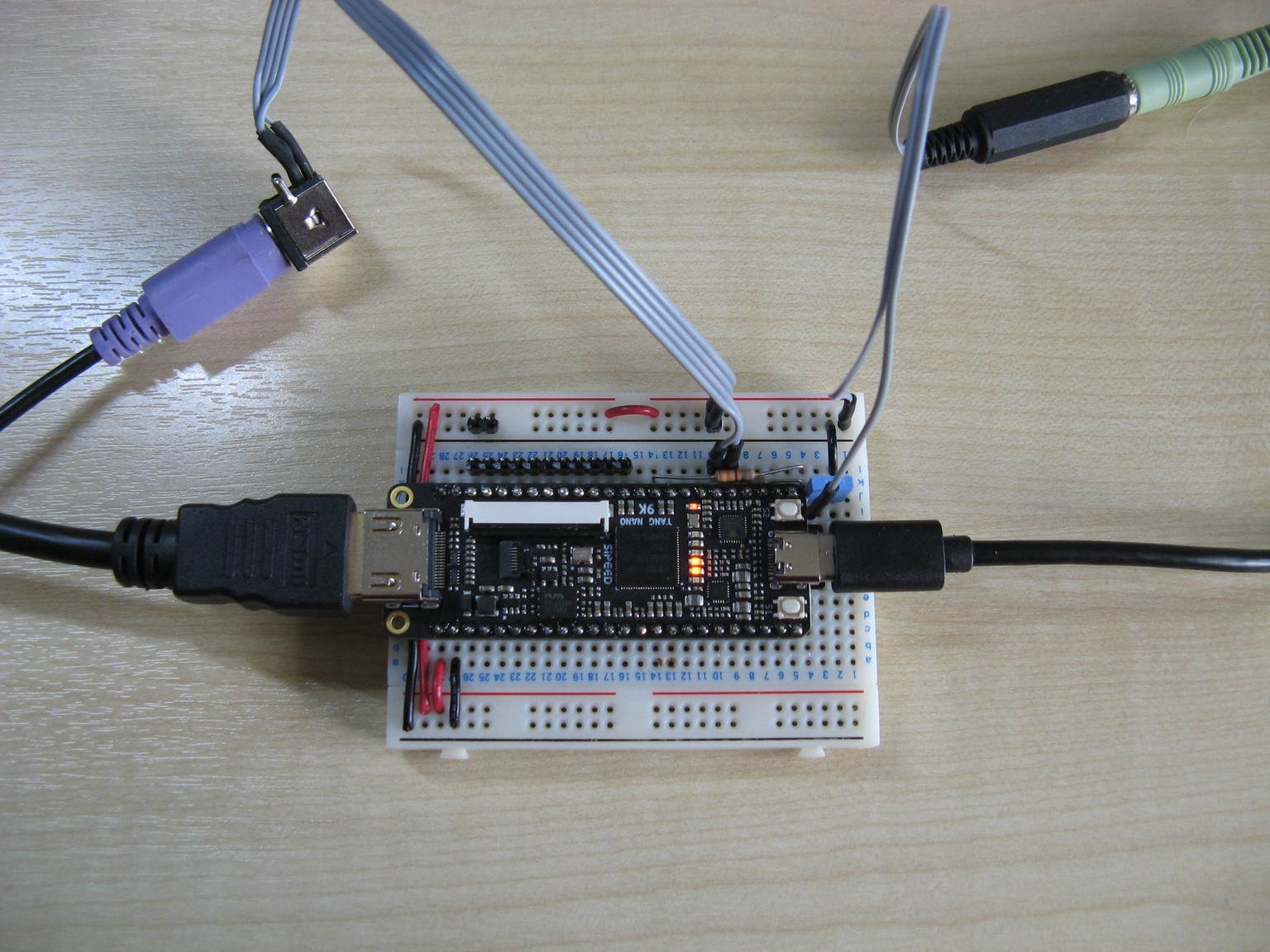

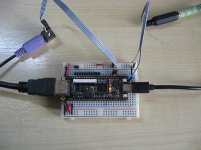

I'm following this thread with great interest.
What are you using to program the board? I've was able to program it reliably with openFPGAloader. I was also able to modify openFPGAloader to support programming of the user flash.
Dominic Beesley and myself spent a fair bit of time porting the AtomFPGA and BeebFPGA cores to the Tang Nano 9K. It turned out to be very nice board, and the Gowin tools are useable and fast. The hardest thing to get working was the PSRAM.
If you are interested, there are more details here:
- Chinese FPGAs (stardot)
- Atom FPGA on the Tang Nano 9K (github wiki)
Dave
