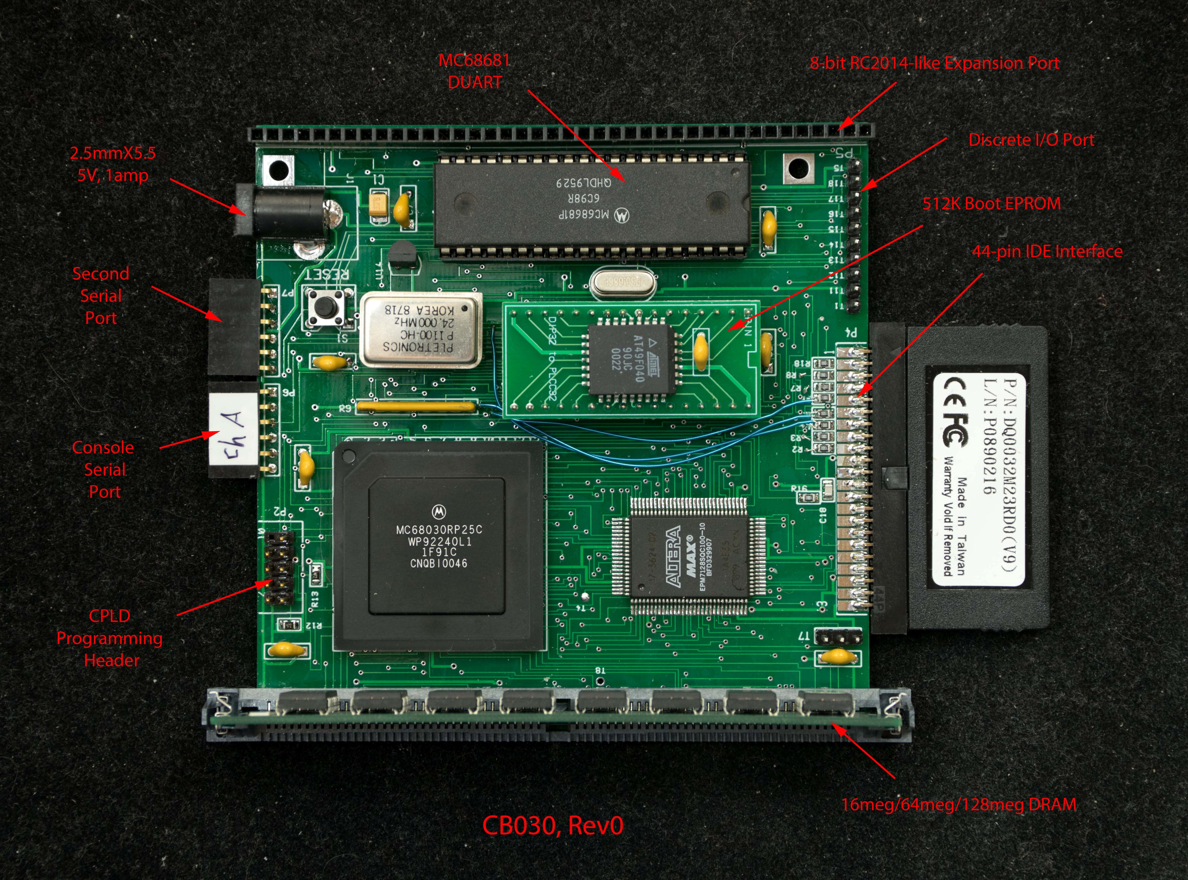

plasmo
Posts: 1273
Joined: 21 Dec 2018
Re: Thin pin headers for "piggy-back" boards
Post by plasmo »
I have accidentally discovered that a SMT-to-DIP adapter has ZIF-like property. This is because the adapter with long pins stands much higher over a socket than a standard DIP so there is mechanical leverage and furthermore fingers can go under the carrier pc board to lift up the adapter easily. I frequently used such adapter to develop ROM software like this early version of CB030.
