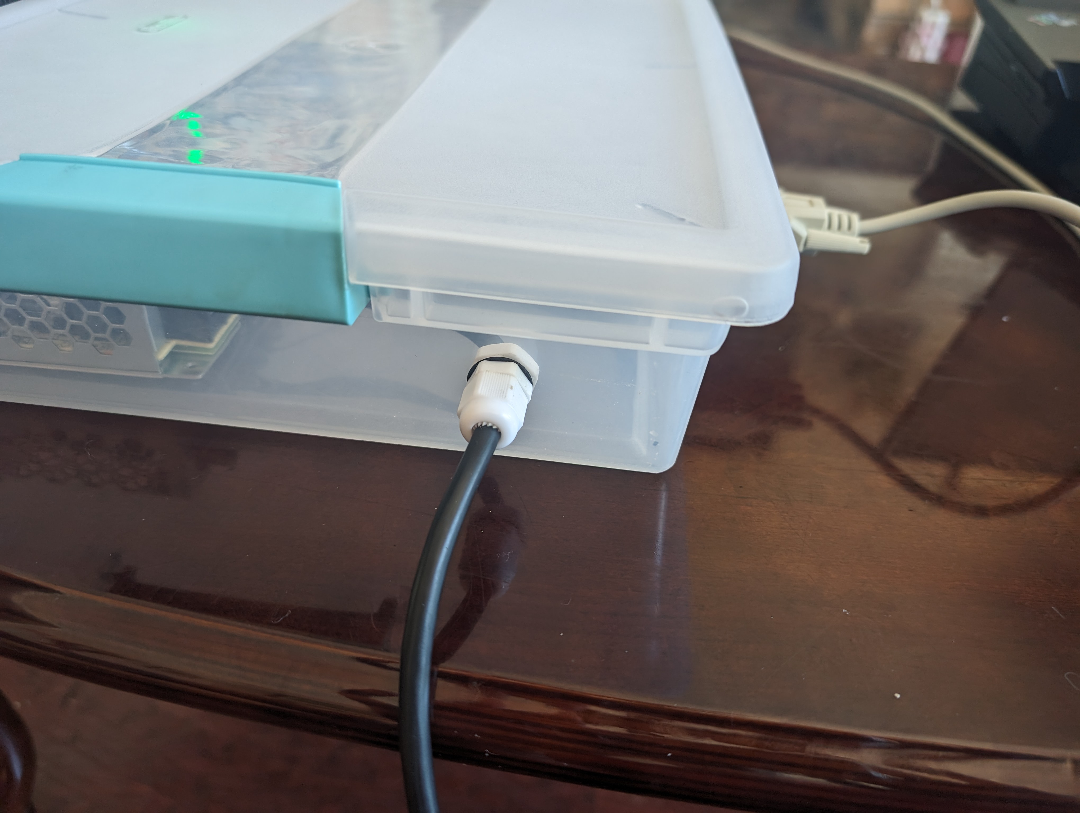

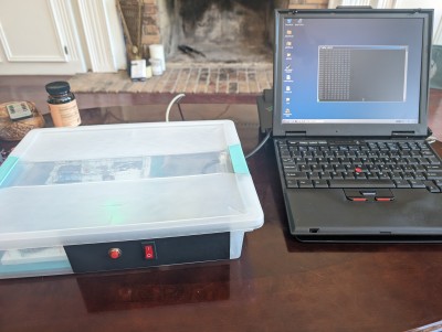

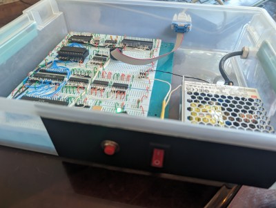

I've continued to tinker with this project a little bit - tidy up the wiring and so on.
One of the many containers in my workshop is a flat Sterilite box that I got a Publix a while back. At some point I noticed that my breadboard assembly fits really nicely into it, and I got the crazy idea of turning it into an enclosure for an honest-to-goodness breadboard retrocomputer. So... I did that. :)
As Mary Berry would say, "It does look home-made." The keyword here is "semipermanent." Everything is adhesive mounting foam, gorilla glue, and heavy card, rather than the ABS plastic, acrylic, and steel I have on the back burner for sturdier projects. Still, it's nice to have a power switch, reset button, and serial port that are away from the breadboards and able to take a little more pressure.
