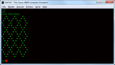

OK, I grit my teeth and prepared a single entry - the 6809 one because:
* it is the smallest of the four
* there is an emulator available which is very easy to install and use
Because I seriously object to being judged on the size of the source code, I spitefully compacted it:
* Removed all comments
* Removed all unnecessary white space
* Use single letter labels
* Replaced all equates with magic numbers
* FLEX text files use only a CR to separate lines, so I removed all line feed characters
* Historically, FLEX assembly language programs were written with a single space before the instruction mnemonic and a single space between it and any operand; the assembler "autofields" as it creates the listing
Because that is so danged mean, I included an assembled listing of the "normal" commented source code. The compacted source code file is less than one sixth the size of the "nice" one. Take that, stupid rule makers...
I will post the code for all four here in a little over 24 hours so that it is Boxing Day on the East side of the International Date Line.
Edit: I guess it is OK to include a screenshot...

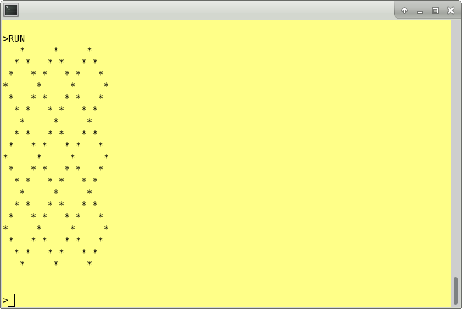

Now that it's the 26th pretty much everywhere, I just wanted to share that I only went through the trouble of submitting my WOZMON version, because the others weren't nearly as satisfying
Well done!
If there's a compact algorithmic solution which doesn't require a table, I don't have sufficient skill to find it.
I think there is as that's the road I started down with alternating counts but I gave up and went for a sort of pseudo-table driven approach... So given there are only 4 unique patterns of lines it was easy to just create something compact to draw those lines then a table of what order to draw the lines in...
It went like this:
  • Design and build a retro minimal computer
  • Port Tiny Basic to it
  • Write TB code that uses a table-driven approach along the lines of one mans data being another mans program. ie. it's an interpreter for a pattern generator..
  • Run the code and submit.
This is the 'normal' code:

Remove spaces, comments, and compact it down and it comes to 298 bytes. Plus 4KB of TinyBasic, IO, etc. I could smush it further but couldn't be bothered.

Then comes the version for the 6809. It has 47 bytes of code and 39 bytes of data.

The 6502 version initially looked very promising in the beginning as I was pursuing the table of line addresses as those addresses are a single byte in the zero page. That advantage evaporated when going with a single long line. It has 48 bytes of code and 39 bytes of data. If my cross assembler and emulator supported the CMOS instructions, namely the relative absolute branch, the 6502 would have won by one byte.

Because it was so different, I did not write the version for the 8080 until the others were done. It has 76 bytes of code and 38 bytes of data as I kept the count in a register. Note that the interface to CP/M cost additional instructions to preserve register contents.

This is the file ID from my submission:
VCCC2023 in 6809 Assembly Language for FLEX
Author: Bill Gee
Category: Christmas Challenge
System: 6809 Computer (SWTPC compatible) running FLEX
Language: Assembly language
Len source code: 290 bytes
Len exe file: 93 bytes
Len code only: 47 bytes of executable code, 39 bytes of data
Instructions:
Download and install ReFLEX
http://datapipe-blackbeltsystems.com/wi ... tml#reflex
Open VCCC2023.DSK as diskette #2
"2.VCCC2023" to run.
If you want to assemble the source:
ASN W=2
ASMB VCCC2023
RENAME VCCC2023.BIN VCCC2023.CMD
Description:
The image can be decomposed into four unique types of lines, each
consisting of several space-star couplets.
A couplet is a number of spaces, 0..5, followed by a star.
-1 spaces denotes the end of the line.
-2 spaces denotes the end of the image.
The rows of diamonds repeat three times.
Because the line containing the three narrowly spaced stars are not
repeated between rows of diamonds, a row of diamonds does not include
the top row; the bottom of the previous row provides those.
That means we must begin by emitting that "bottom" row as the very top row.
Comments:
ZIP file contents:
FILE_ID.DIZ - This file
REFLEX.PNG - Screen shot of program run in ReFLEX emulator
VCCC2023.TXT - Source code in FLEX format
VCCC2023.CMD - Assembled executable
VCCC2023.DSK - Virtual disk for use with ReFLEX
VC9-2023.LST - Assembly listing of commented and uncompacted source code
Oh yeah, Merry Christmas!
