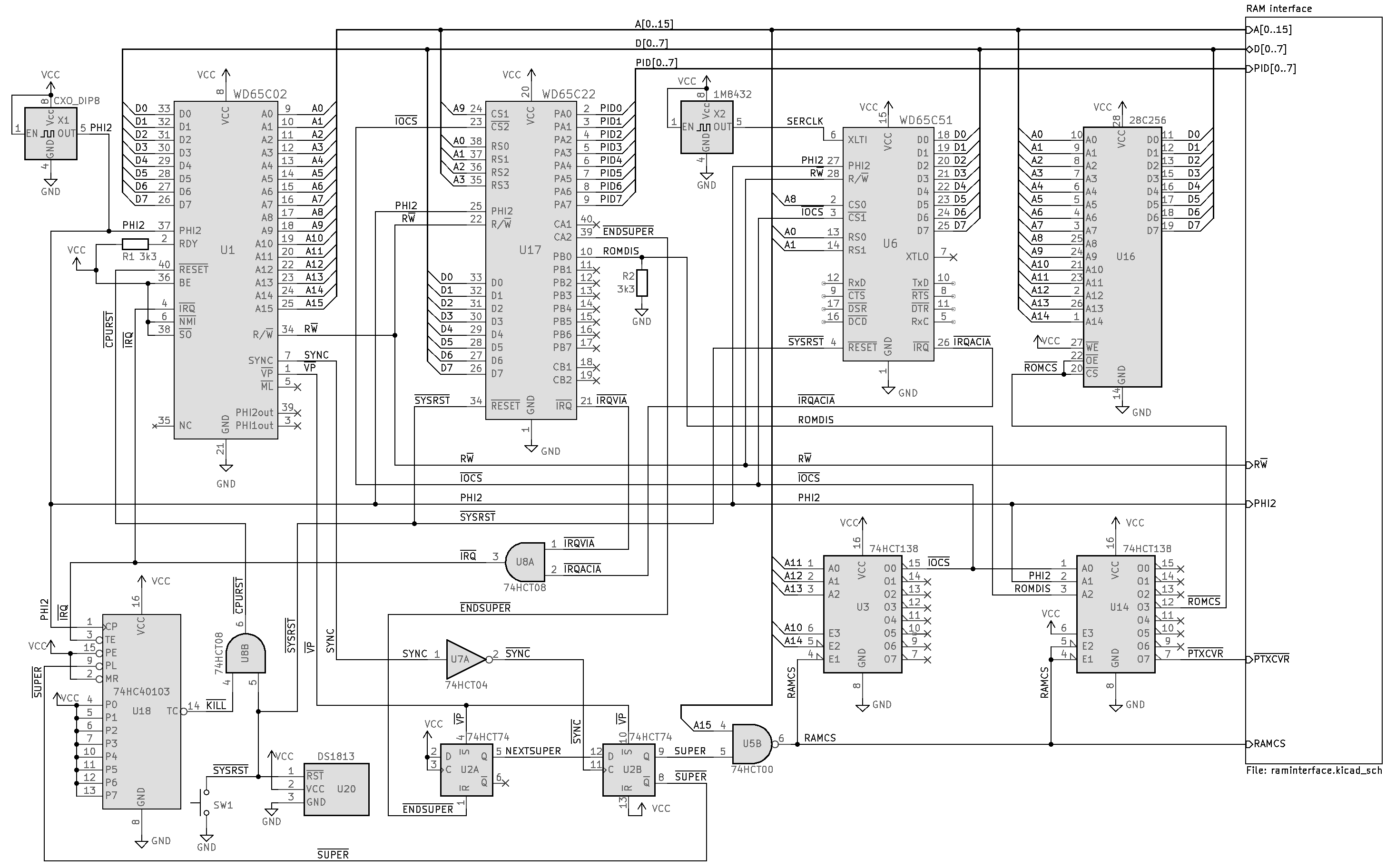

I've made a lot of updates to the design, which simplify it in some ways but also add more features. This should finally be a complete schematic for the whole system, unless I've missed something!
I originally squeezed it onto one page, but it was very cramped so I broke it out into two. I'll attach them here and then call out the changes and points of interest.
First the RAM interface:
RAM interface
RAM interface
This contains all the RAM and the paging system. Its inputs are the CPU's address and data buses, an 8-bit process ID, the CPU's PHI2 and RWB signals, an active-high RAMCS signal that indicates whether the current cycle is accessing paged memory, and an active-low PTXCVR signal that indicates whether the transceiver connecting the CPU's data bus to the pagetable's data bus should be enabled (it is only enabled when the CPU is reading or writing the pagetable).
Then the rest of the computer - 6502, 6522, 6551, etc:
Computer
Computer
There shouldn't be too many surprises here but I'll talk through some differences from the past revisions below.
Key changes
  • The PID register is now located in the "system" VIA (U17), on Port A
  • The VIA's CA2 is used to queue up a switch to user mode (like reading the PID was before) - so accessing Port A via register 0 will cause this, and accessing it via register 15 will not. This gives the kernel more control over these mode switches.
  • The boot ROM (U16) can be mapped out using the VIA's PB0 pin, leaving pagetable RAM in its place
  • The pagetable RAM (U25) is then almost fully-addressable, meaning that parts that are not used by the 8K pagetable and the 1K I/O space can be used for other things
  • A 65C51 ACIA (U6) is included in the circuit, in case VIA bitbanged serial doesn't work well enough
  • A watchdog timer (U18) is included to trigger killing of rogue processes where necessary
System VIA
Using the VIA like this reduces complexity elsewhere, though obviously there are less free pins on it for other things. I can easily add another VIA if there's a need for more I/O than it has remaining. Its timers will also be used to control scheduling, and I will probably hook up an SD card interface and/or PS/2 keyboard through it as well.
Boot ROM and pagetable RAM
Mapping out the boot ROM should be a big win, it removes a lot of contention from the memory map and reduces the complexity of the address decoding. The pagetable RAM has a lot of spare space, so the boot ROM can copy itself to pagetable RAM, or stream content from serial or SD card, and then the kernel will have 32K of paged RAM in its address space and nearly 32K of private pagetable RAM, of which 8K is used by the pagetable. Permanently-accessible things like the CPU's vectors, interrupt handlers, the scheduler code, and any data needed for that will live in that private RAM. If the kernel needs more memory than this then it can use as much paged RAM as it wants as well. The kernel's zero page and stack always live in paged RAM.
Supervisor address space
So the supervisor address space looks like this:
  • $8800-$FFFF - ROM/RAM - pagetable, unpaged kernel code/data, CPU vectors, etc
  • $8400-$87FF - I/O (VIA, ACIA, etc) - partially decoded
  • $8000-$83FF - ROM/RAM - pagetable
  • $0000-$7FFF - paged RAM
Within the private RAM, the address space is a bit complicated. To save adding another multiplexer, I wired A12,A13,A14 straight through to the pagetable RAM IC. This means that the 8K pagetable is split into 8 separate 1K segments - it occupies the first 1K of each 4K block of private RAM (bits 10 and 11 are zero). So $8000-$83FF is pagetable, as is $9000-$93FF, $A000-$A3FF, etc. The remaining gaps are general purpose private kernel RAM, apart from $8400-$87FF which is mapped to I/O.
This fragmentation might turn out to be annoying to code for, but I don't think it will matter much in practice. 3K is quite a lot, and each time the code grows too large I'll just have to redistribute it a bit.
In user mode of course none of this applies - user processes just see up to 64K of paged RAM. Most processes won't need to interact with the paging system at all, but if they are aware, they can request more pages than were allocated when they launched, or remap pages to page through more than 64K of RAM in a sandboxed way.
Booting up
The boot ROM is initially enabled by a pull-down resistor on the VIA's PB0. As the boot ROM is preventing access to the pagetable, to do anything useful it needs to chain to a bootloader in RAM, so that we can switch off the boot ROM. The bootloader could either come from the boot ROM itself, or serial or SD card. As we can't use the paged RAM until the pagetable is set up, and the pagetable RAM is disabled when in boot mode, I needed to add a hack to allow writes to still go to the pagetable RAM, even in boot mode when it is not really in the address space. This is U8C in the RAM interface schematic. It allows writes to pass through to the pagetable RAM even if the ROM is currently still active - in particular, it allows the CPU's data bus to pass through the pagetable transceiver (U26), which would otherwise have been blocked. I don't like that much, but it's only one logic gate and I think it will work fine unless I think of a better way to do it.
So on startup the boot ROM supplies the vectors and reset code, and it can copy some boot code (maybe the whole ROM) into the pagetable RAM, then turn itself off. The pagetable RAM then takes over, maybe running some tests of the paging system before allocating a page for the kernel's zero page and stack, and either segueing into running as the kernel, or loading a kernel image from serial or SD card and running that.
The kernel is going to want to write its own values into the CPU vectors, so that it can deal with them appropriately from here on.
Watchdog timer
General pre-emptive multitasking will be done through a VIA timer, causing the VIA to interrupt the CPU and switch processes. All interrupts, and BRK, switch into supervisor mode. To protect against processes that disable interrupts for long periods, or call STP, there's also a watchdog timer (U18). This counts clock cycles when IRQB is low, but resets when in supervisor mode. Thus it will detect when a chosen number of clock cycles elapse in user mode with IRQB low, quickly indicating that the process is preventing interrupts from being processed, one way or another.
In this case the watchdog timer triggers a CPU reset. This only resets the CPU, not the system VIA, so the general paging and system state is preserved, including port A which holds the active process ID, and PB0 which is keeping the ROM disabled. The kernel's reset handler just kills whichever process was active, processes the pending IRQ, and picks a new process to run.
Interrupt latency and nesting
I'll be curious to see how well this performs in practice especially regarding interrupt latency. I have asynchronous bitbanging serial code for the VIA that is fairly sensitive to this, which will be interesting to try, and in case it doesn't work well, I've put a 65C51 in the circuit. When an interrupt does occur I can prioritise handling the time-critical interrupts, but potential additional latency compared to a normal system will come from cases where the supervisor was already running, with interrupts disabled.
System calls are a good example of something the kernel needs to do which may need to re-enable interrupts to avoid stalling or missing I/O. As I'm not using NMI, and so don't need to worry about unexpected nested interrupts, I think I should be able to rely on some brief prologue in the BRK handler to note that, if an interrupt occurs, the system should remain in supervisor mode - before re-enabling interrupts while it handles the system call. This way even long-running system calls should not prevent interrupt-driven I/O. I can do this simply by incrementing/decrementing a memory location visible to the kernel code, and only switching to user mode at RTI if this value is zero - this is similar to a hardware solution for nested interrupts discussed on another thread.
Anything else?
That's all I can think of to describe, but as always please do say if you think you see something that's not going to work, or if it's not clear how something is meant to work!

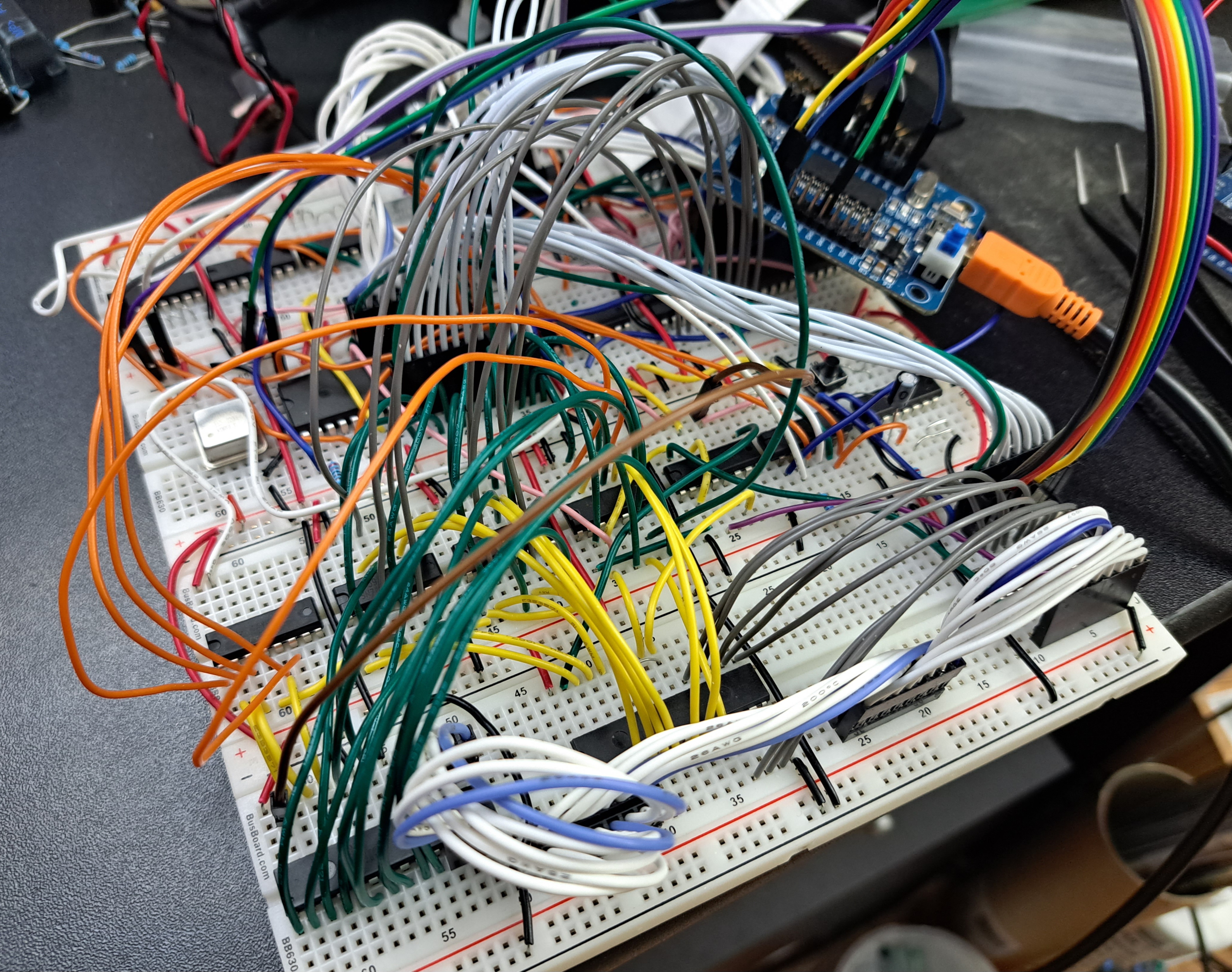

There were a couple of errors in that schematic - the WDC 65C51N part has an open-drain IRQB so it needs a pull-up resistor, and some of the other signals like ROMDIS and /ENDSUPER also need pulling one way or the other to ensure they default to sensible states before the VIA pins are in output mode.
I wasn't sure whether to just do a PCB layout for this, or whether to prototype it first. I decided to prototype it, so yesterday I went ahead with that. I tend to plan the layout in KiCad, even for solderless breadboards - the rats' nest is very helpful for this. My priority is generally to redure the length of wiring, rather than signal integrity, as the signal integrity is going to be bad either way, and long wires are hard to manage on breadboards. Here's the planned layout:
The top row contains the watchdog timer, the pair of flipflops that manage the SUPER state, some glue NANDs, an oscillator for the ACIA, the ACIA, and the ROM.
The second row contains the reset switch, main oscillator, CPU, a '138 decoder, and the sytem VIA.
The third row contains another '138 decoder, the multiplexers for the pagetable RAM address bus, a '139 decoder pair, and some AND gates.
The fourth row contains the pagetable RAM, the system RAM in two ICs, and the transceiver to connect the pagetable data bus to the CPU data bus during pagetable read or write operations.
I laid these out on the breadboard according to this plan, but I squeezed the top row to the left to make more space around the EEPROM so that it would be easier to access, and I also made room for some schmitt inverters on the third row for and RC reset circuit as I can't find my DS1813s. I've also only put one system RAM IC in, and it's a small one - I'll test it like this first, and if it works then I'll steal larger RAM ICs from one of my video circuits.
Next I laid out a ground grid, and less importantly, a power grid, and I routed ground to all the ICs, and power to the subset I'm going to test first - essentially everything except the RAM interface:
Next I wired up all the connections:
I was not feeling very patient, so I reused long premade Dupont cables for most of the buses. Some of these I made in the past by crimping my own connectors onto the wires, others using pre-cut, pre-crimped wires. Having lots of these wires in one housing makes it very easy to plug and unplug them - the data bus is 8 wires in one connector, the address bus is one 8-way connector, one 4-way, and loose wires for the rest. I have a special splitter for the data bus going to the ROM which is a 1x8 socket on one end and two sockets on the other end, one a 1x3 and one a 1x5. I also use a special cable for A8-A11 from the CPU to the ROM which has four wires but goes into a 1x5 socket at the ROM end, with pins in the order: A8 A9 A11 NC A10. This makes it very easy to hook these up without needing to remember how they go.
Other than that, I just used extra-long wires for long connections. This was partly because I do the routing methodically, starting with power and ground, and then working through each IC in turn connecting it to others. Being methodical is important because it's very easy to miss a connection otherwise, especially in busy areas. Long distance connections don't play well with that because if you try to route them tidily they end up trapped under a lot of shorter connections later on - so I chose to just make these extra long, so that at least the connection was there, and consider going back to optimise them after all the short connections were in.
With that all in place I made a quick test program to initialise the VIA and write increasing values to port A (the PID). It didn't work very well - diagnosis revealed issues with the data coming from the ROM. This was due to my ROMCS signal being gated by PHI2, meaning the ROM has only half a clock cycle to present its data - it was doing so around the falling edge of PHI2, so not quite early enough. This was with an 8MHz CPU clock, so ROMCS was only asserted for about 60ns, meaning that as far as the ROM was concerned it looked more like a 16MHz clock, which is too fast. I downgraded the clock to 4MHz (120ns high period) and it worked. This tallies with my past experiences - it's equivalent to 8MHz with an ungated ROMCS, which is generally fine although the EEPROM is specified to want 150ns; but clock speeds any higher than that are more risky.
Next I took some code from Garth's RS232 and 6502 primers to set up the 65C51 as I've never used one before, and got it to send and receive data, with a view to having it load code that way for faster iteration, when the system has RAM to load it into!
So the CPU, ROM, VIA, and ACIA were working fine. Before moving on to add RAM, I wanted to test the more bespoke features of my circuit - even with just this subset it should be possible to test the transitions between user and supervisor modes, and the ability to page out the ROM. In both cases the system is going to try to run code from RAM, and there is no RAM, but at least we should see that happening.

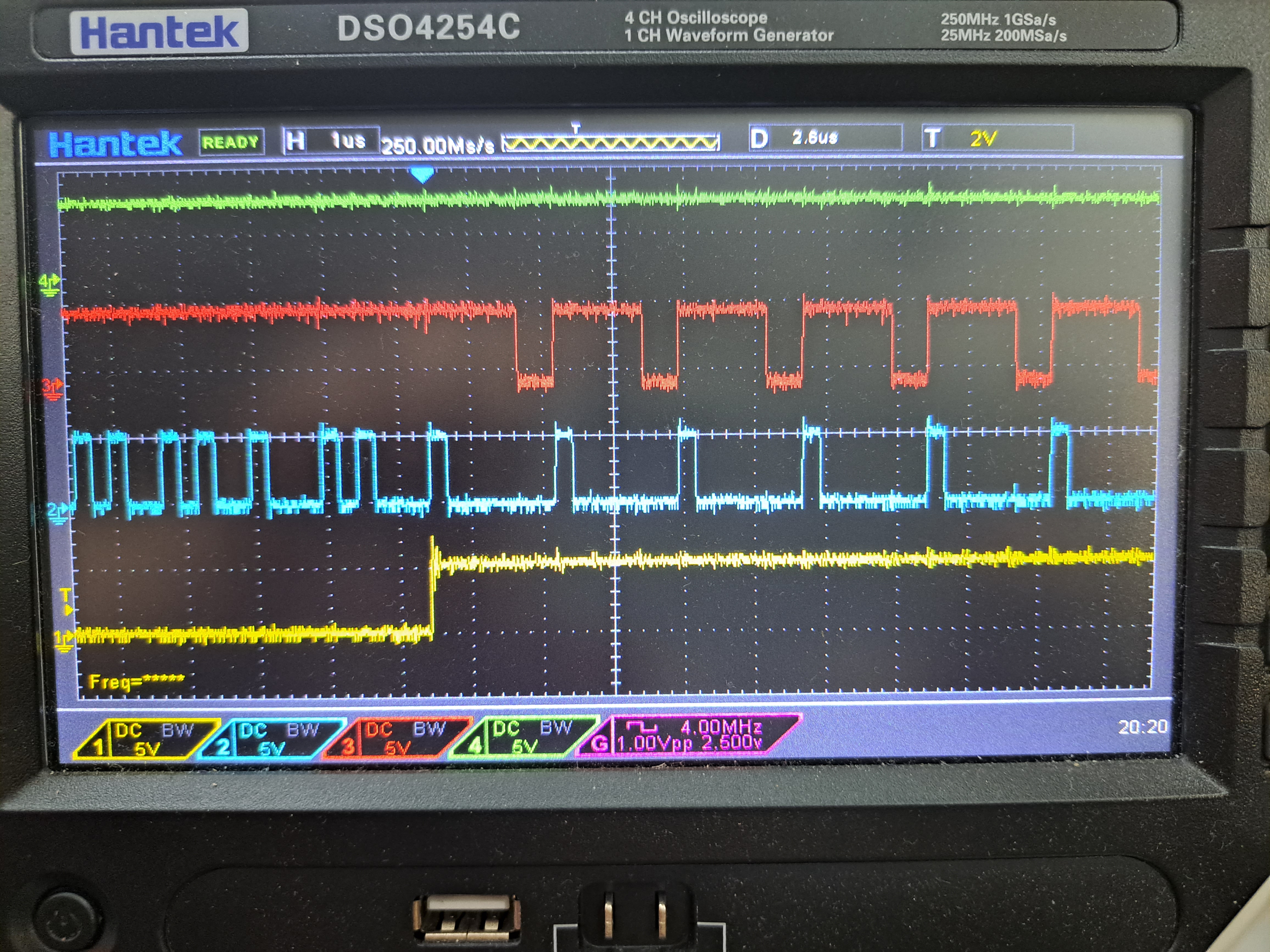

Here's an oscilloscope trace showing the transition from supervisor mode to user mode:
The bottom, yellow trace is a VIA pin that's changing state during the CPU operation that triggers user mode (writing to VIA_PORTA, with pulse output on CA2 enabled). The blue trace is the CPU's SYNC pin, showing when instructions start and how long the clock cycle is. The red trace is CA2, the asynchronous reset input to the first D flipflop, which holds the pending mode change until the end of the next SYNC. The green trace on the top is the second D flipflop that outputs the user/supervisor state, and this is the signal that changes all the address decoding.
It's interesting to note that the handshake pulse from the VIA is maintained over the falling edge of SYNC. This means that I could probably have not used the first D flipflop here - I could probably have just used an AND gate to make the second D flipflop blend its current state with the CA2 state, so that it would stay high only if CA2 was not low, and after going low, it would stay low until forced high again.
In the traces above we can see that the system is going into user mode, and then executing a series of 6-cycle instructions. I am not sure what these were exactly, nothing was driving the bus but evidently it floated to, or persisted at, a level that corresponded with a stable state. To check this better, I added a pull-down resistor network to the data bus, so that it would give a BRK opcode if no device was driving it, and this made it easier to confirm things were working as they should:
I moved the red probe (second from top) to the CPU's VPB pin this time. Now we can see the user mode state starting at the falling edge of the SYNC for the RTI instruction, and then another instruction starting which will be a BRK due to the pull-down resistor, and then VPB goes low for two cycles, forcing the system back into supervisor mode. After that a couple of instructions execute - this is my IRQ handler which just loads X with a specific value, writes it to port A, and issues a STP instruction. The write to port A brought the yellow line low again and STP meant no more sync cycles occured after that point.
So clearly the address decoding has responded to the transition to user mode, and the ROM is no longer mapped; but also, on VPB, we do return correctly to supervisor mode in time for the IRQ vector to be read from the ROM.
Lotta chips!  Reminds me of the Basic Four minis I worked with in the previous millennium.  :D
The waveforms don’t look too atrocious for being on breadboard.  Usually, square waves on a breadboard are so rounded you can hardly tell where logic zero ends and logic one starts.
I am used to the traces being more noisy than this, for sure. I wasn't very careful with the construction or probing technique, so can't put it down to that. The ground grid always helps though and is worth doing up front before building everything else on top. I didn't put any decoupling capacitors on this, either, so I expected worse quality signals than I got.
I have wired up the RAM as well, at least as a first pass, and it appears to work so far - the only bug was in my test code (thanks to hoglet's decoder it was very easy to pinpoint) so now I can try to develop a bit more software.

Thanks for sharing the traces and the explanations - we usually see traces of things which are misbehaving!

I did some more testing yesterday - I'd already made the ROM test that it could map a page of RAM (which requires the U8C AND gate hack I did to allow writes to ROM to also write the pagetable) and also test that that 4K page of RAM is working correctly, as the boot code's zero page and stack live there. So that then allows the boot code to use subroutines, making the code more comfortable to write.
The memory map at that point is roughly that the bottom 4K of address space is mapped to physical RAM page 0 (out of 8 in this cut-down system), and the top half of the address space maps reads to come from ROM, and writes to go to the private/pagetable RAM. The bits in-between ($1000-$7FFF) are more paged RAM, but the pagetable hasn't been initialised yet so they could point anywhere.
To speed up development, I pasted into the ROM my load-from-serial code from my last system, with minor changes, and was able to get some code loaded into the page of RAM that way. The interface allows the PC-side server software to choose which code gets loaded, to what address, and where execution begins, so this means no more changes are needed to the ROM for now - I can load code or data anywhere I like, with the caveat that it has to be done 256 bytes at a time.
Loading a short "hello world" program to the valid page of RAM worked fine (loading at $0200). The main missing piece then was getting code loaded into the private RAM that's masked by the ROM at boot time. In the long term it might make sense for the ROM to just copy itself into the private RAM and then disable itself, with execution flowing on seamlessly from the private RAM instead. But to avoid having to iterate on the ROM itself, I used the serial server to tell the ROM to load code into the private RAM, at $8800, and then made it load and execute a stub in paged RAM at $0200 that can itself disable the ROM then chain to the loaded code in private RAM. The ROM should be able to do this through the same hack that allows pagetable writes to work even when the ROM is enabled.
This didn't work very well though, and was hard to diagnose. My main tools were the logic analyser, hoglet's decoder, and an oscilloscope, setting VIA output pins at key moments to trigger the oscilloscope. I found quite a few issues this way, the main one being that the hack to let the ROM write-through to the pagetable RAM doesn't seem to be working very well. It does seem to be good enough to let it write that initial pagetable entry, it seems, but I don't know why, and it is certainly not reliable at all later on. I need to do a lot more diagnosis on this, but it will involve iterating on ROM content, so I'm going to defer it for later - I do want to fix it though before getting any PCBs made.
I did find that the way I am switching the buses back and forth in these writes is putting a lot of stress on things - I am seeing evidence of bus contention, such as downward spikes in the power rail, and noise on the pagetable data bus. I think the bus transceiver between the CPU's data bus and the pagetable RAM's data bus is having a particularly hard time.
As above though, I won't investigate this in detail yet, because it seems to work very well so long as I disable the ROM before loading data into the private RAM. This is why I think the issue is something to do with my hacky AND gate that is meant to open the transceiver during writes to ROM address space. So I wrote a program that runs in paged RAM (at $0200) which disables the ROM, and writes a distinctive pattern into private RAM at $8800, then reads the pattern back. This worked well to highlight that I had misconnected one of the address lines to the private RAM, which was easily fixed.
I wrote a more thorough test of the private RAM, which would fill all 32K of it with a distinctive pattern and check it could be read back properly - skipping, of course, the two bytes that are defining the page mapping for the RAM where the code is running from! And as that passed, I pasted the bootloader code in again, so that this code running in paged RAM can query the serial server again for more commands, and load some proper code into the private RAM area from $8000-$FFFF. It sends a different query string to the serial server, so that it knows to supply stage 2 rather than stage 1 this time.
This in turn allows running code located in the private RAM, which is where the kernel code is meant to be - this is always visible when in supervisor mode, and provides the NMI, reset, and IRQ vectors, so that's important too. The code I put there at the moment is just a more thorough test of the functionality of the paged RAM. It first checks the paging system by using a combination of mappings of logical pages 1 and 2 to check that different physical pages can be mapped, that two logical pages can be mapped to the same physical page, and that asymmetric read/write mappings work (which are required for read-only pages to work).
After checking the paging system, it measures the amount of physical RAM it can see by setting location $FFF in physical page zero to a non-zero value, then looping through the other physical pages, mapping them in and writing location $FFF in each, until it finds one that either can't retain data, or causes $FFF in physical page zero to get overwritten (wrapping). Either way, that's the amount of physical RAM in the system.
Then it performs a more thorough test of this RAM, filling all of it with a pattern and making sure it all reads back and that writes to one page haven't corrupted another. It's an important test, as it is sometimes not obvious when writing to one bit of RAM is corrupting another - a bit like those phony USB drives that are sold with one capacity but actually have a much smaller capacity, and the user doesn't notice until it's been used for a while!
Anyway that all seems good, the memory is working fine. I can do more tests of user mode now, which is dependent on the pagetable and paged RAM working correctly because that's all it's got access to. If that works then I will swap in the larger memory modules, as with only 32K of paged RAM the system only has room for 8x4K pages, which is not a lot.
