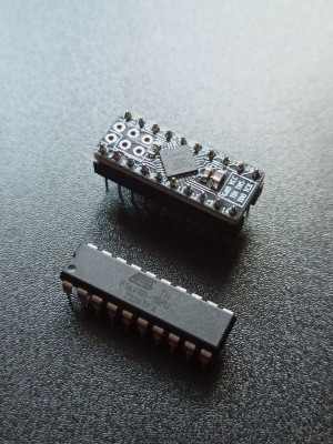

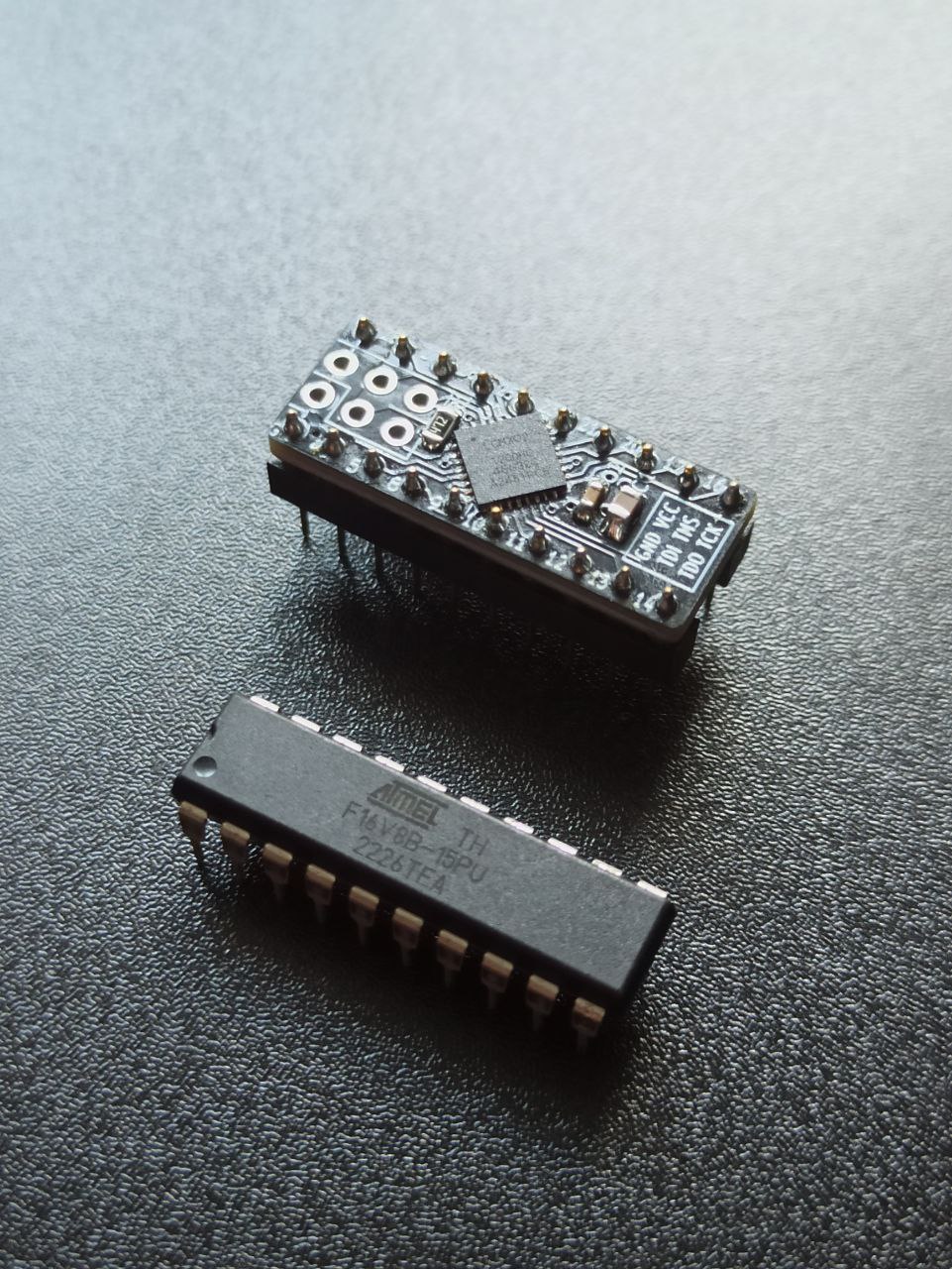

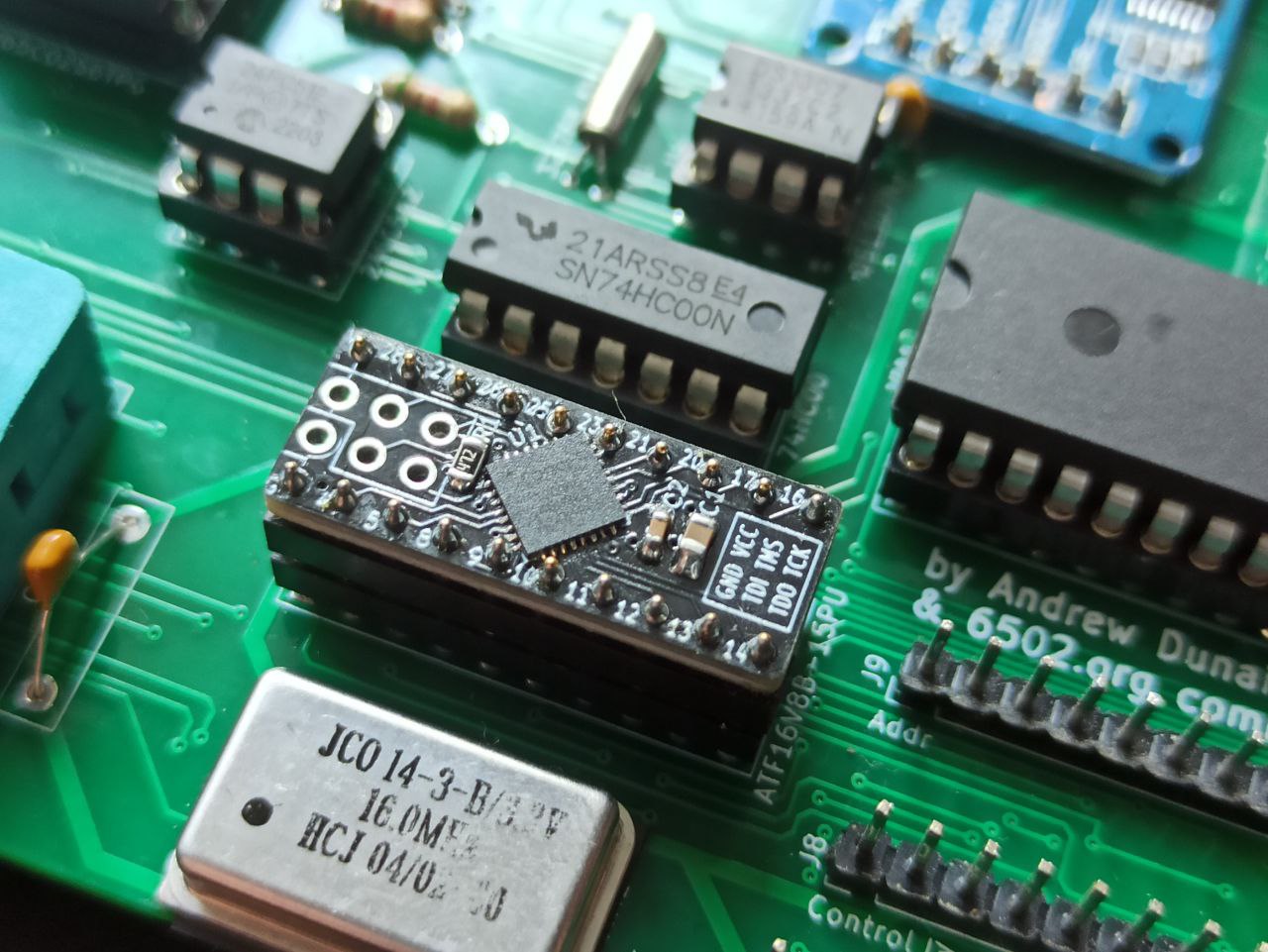

That's true. Thanks! I was pleasantly surprised that there are a lot of nice open source toolchains for Linux. (When I did some hardware stuff back in high school, finding a free non-proprietary software was an utter pain.)
Just picked up my tiny new board. It nicely fits into DIP-20 socket:
