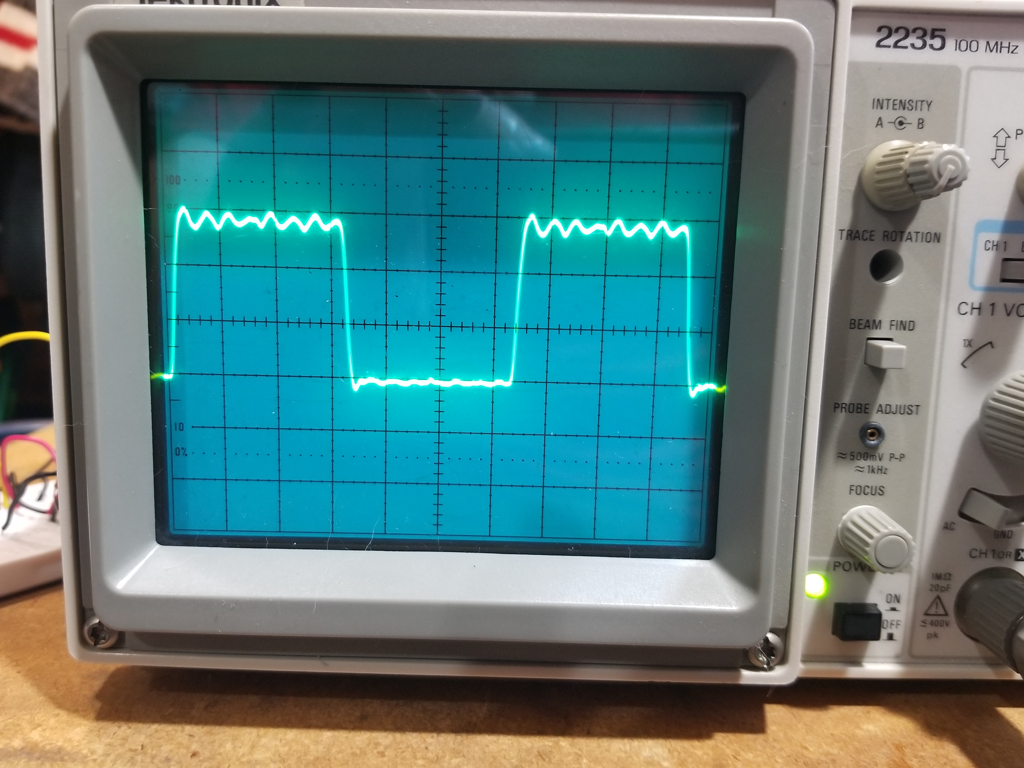

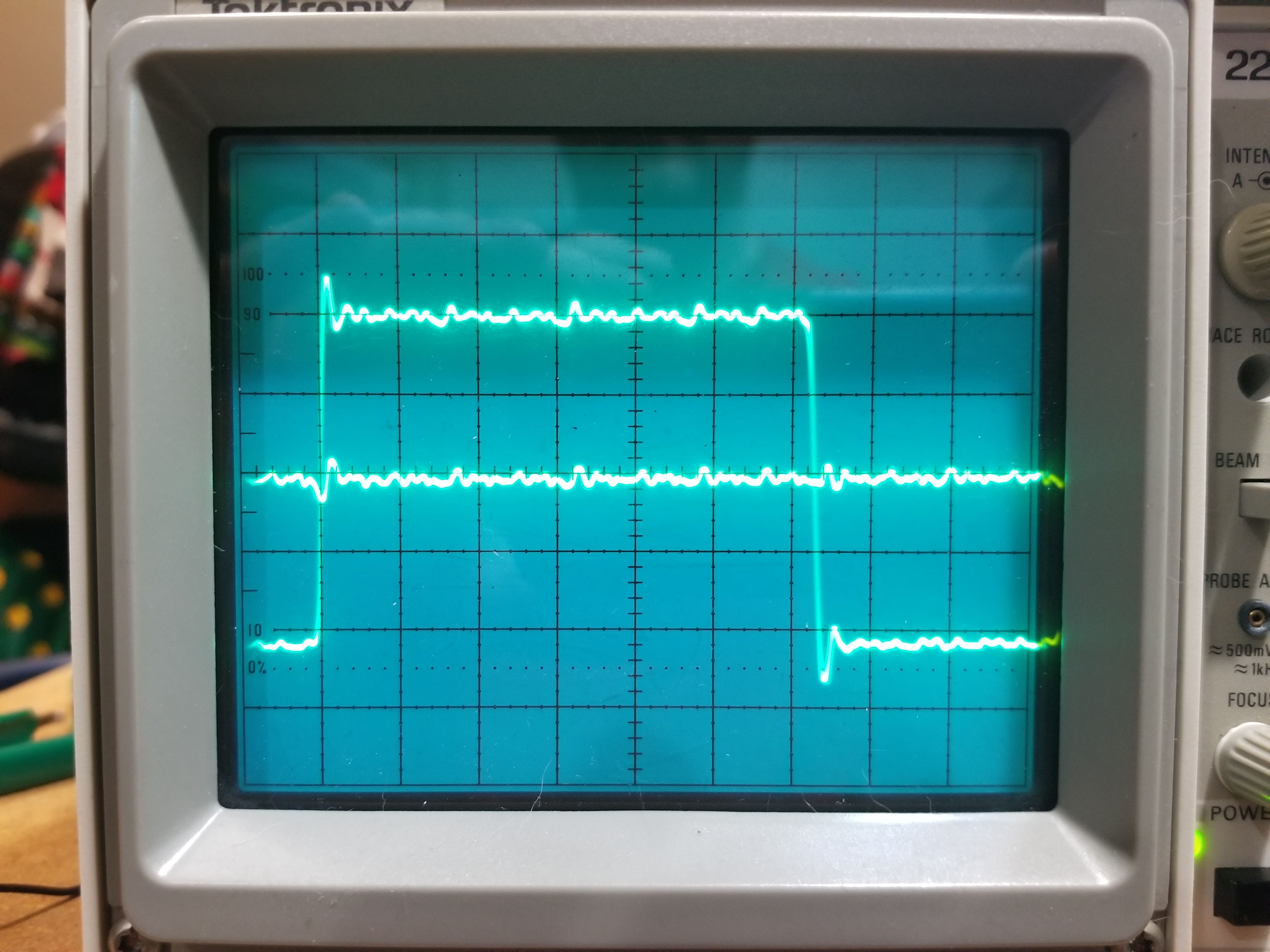

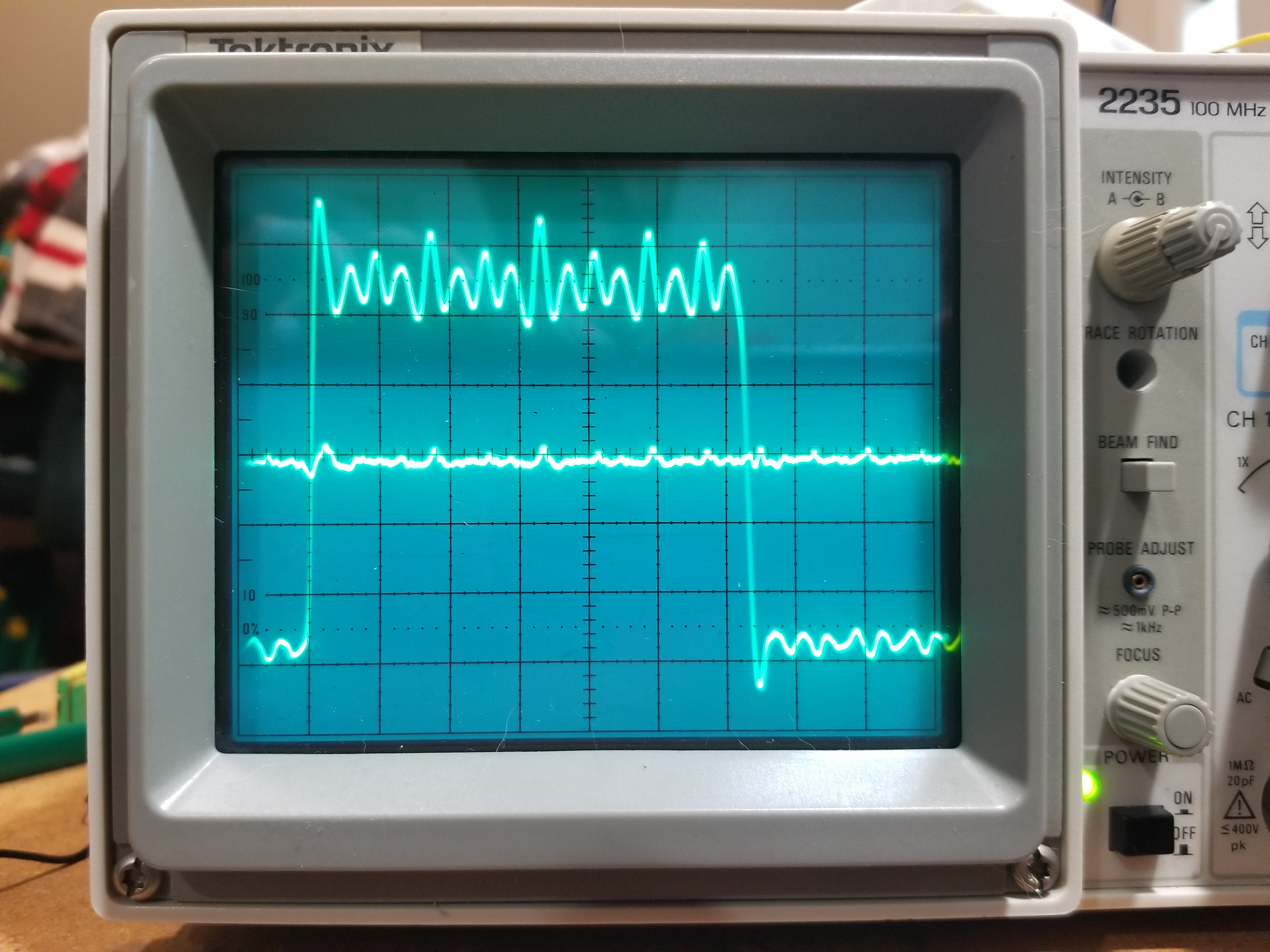

Barnacle wrote:
I wonder if you're simply isolating the oscillator from the rest of the counter by powering it this way? It would definitely be interesting to see the Vcc signal - you'd probably need to trigger the scope from the divided output to see if any noise on it is correlated.
Circuit #1:
Circuit #2:
That was a good idea, Niel. Could this noise actually be cross-talk from the `163's outputs, and not ground bounce or VCC noise generated by the oscillator? The spikes correlate with the oscillator's pulses, as expected, but they're bigger when more of the `163s outputs are switching at the same time.
Maybe it's worth reiterating that both these circuits work. Even the biggest spikes are not in danger of creating logic errors. However, AN-375 from my National Semiconductor HCMOS data book says that, as a good rule of thumb, it's generally good design practice to restrict both Vcc and ground noise to less than 250 mV. Since this counter is going to be clocking a pretty touchy and (for me) complex circuit, I'd like to get it as clean as possible. Is there some way to get the effect of circuit #1 without feeding the `163 through the wrong pin (and without the almost 1v drop)? My first thought would be just to send the outputs through a 74HC14 a couple of times. Anything better than that spring to mind?

Since HC163 slows down at lower voltage and therefore generates less noise, your less noisy waveform at 4.3V (circuit #1) may be the result of lower supply voltage. So reduce VCC of circuit #2 to 4.3V and see if the output becomes quieter. Conversely raise the voltage of #1 to 5.7V and see if it becomes noisy.
Circuit #2 at ~4.2V.
Well now.
Yes, the outputs from the 163 likely share a common(ish) power rail within the chip (don't quote me, I'm not a chip designer and I've never looked at the die!) and so are likely to affect each other to some extent. It is entirely as expected that the noise on the power rail is closely correlated with the switching particularly as you are definitely powering the chip the 'wrong' way through its substrate diode and the ENT input.
CMOS logic takes current only when the internal gates change state and the reason for a 'high' capacitance, low inductance decoupling is to supply that current as and when required. I find 10nF is usually enough to keep things in check... but it may not do a lot in this case as the switched circuits are affecting each other.
Though your observation that the noise is not big enough to take the signal into improper voltage levels may well depend on the response of the scope; those signals could have high frequency components that your scope input amplifier simply can't handle. But I think you're fine. A buffer/inverter after the signals will probably clean them up.
Posts: 9425
Re: Text mode VGA for 6502
I doubt it, unless all outputs are loaded to where they have to deliver significant current. That wouldn’t be the case if an output is driving a CMOS input, unless a lot of parasitic capacitance is present. My POC V1.2 unit gets its Ø2 clock from a 74AC163 being driven from a 40 MHz oscillator. I only use one of the 163’s outputs—the others are unconnected. Ø2 is nearly pristine...just a hint of ringing, which is to be expected when the extremely fast edges are considered.
10nF is too “light” a bypass cap, in my opinion. I use 100nF X7R MLCCs rated at 50 volts.
