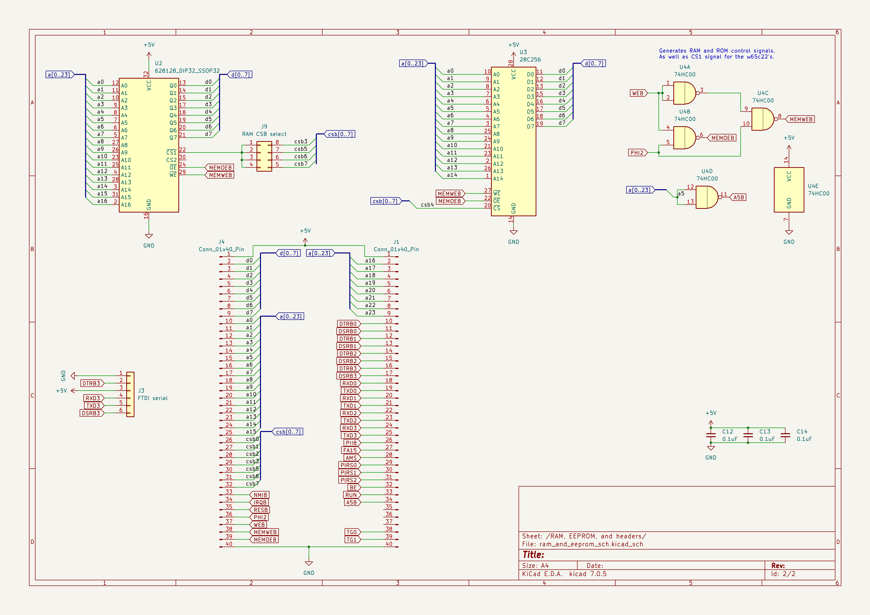

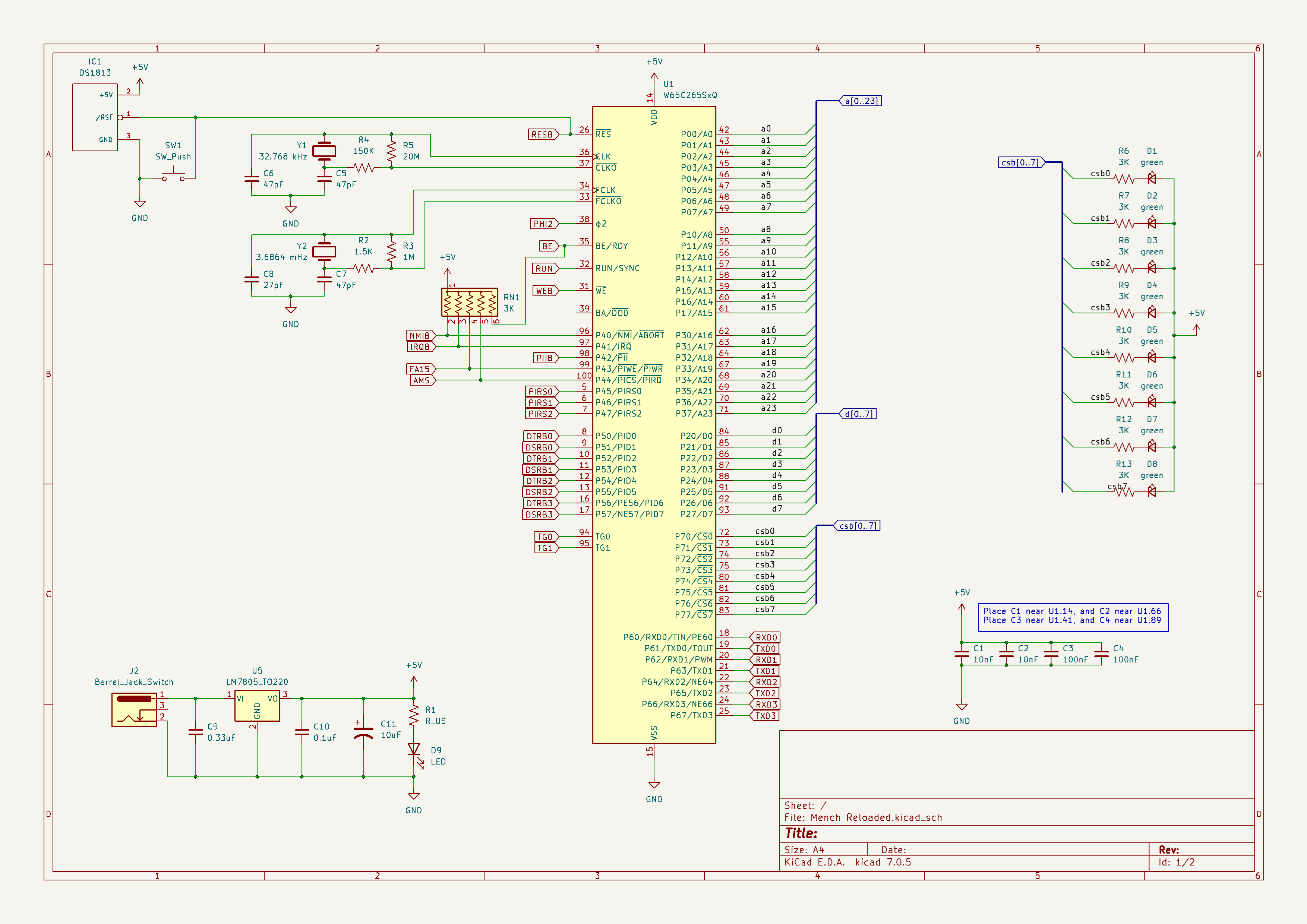

I am bumping this topic because I finally sat down and taught myself enough of KiCad to layout a schematic for my ideas. The project uses the W65C265QBX as the starting point, but I expanded the headers to two rows of forty pins (gaining access to every CPU pin). I also added RAM and ROM to the board to avoid the nuisance of wiring those with each project.
My idea is to create a breadboard friendly breakout board for the w65c265 to test how it works before design a PCB's with more features. This PCB allows access to the full address bus, chip select lines, and control signals. Attached are the two pages of my schematic. Also, the KiCad project on Github: https://github.com/Martin-H1/KiCad/tree ... 20Reloaded
Any feedback on my work so far would be helpful.

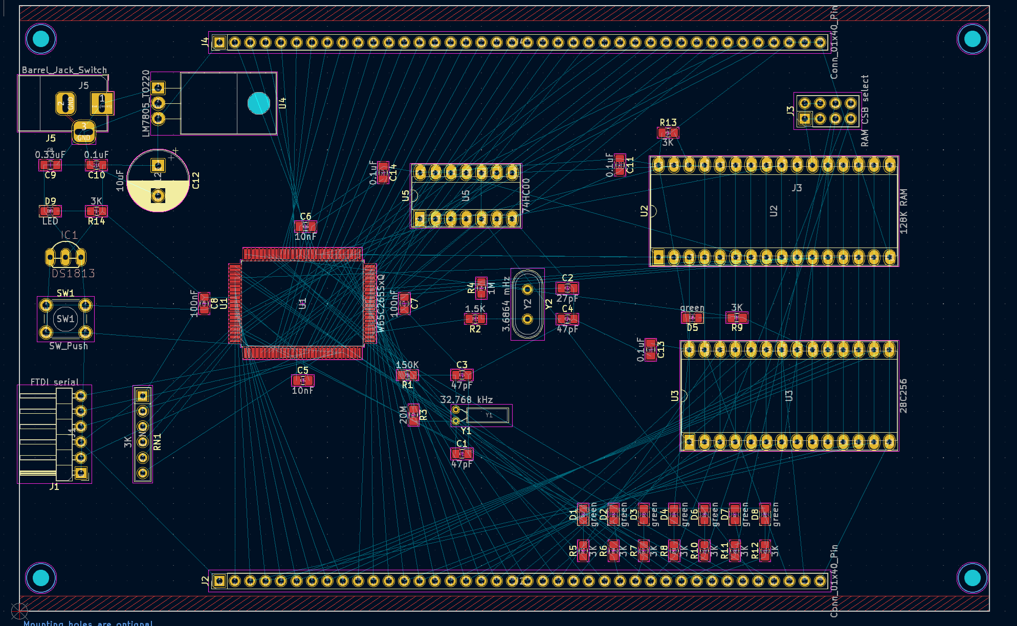

I updated the PCB from the schematic and chose the Eurocard size. I am hoping that standard makes it easier to fabricate.
I placed the components working left to right in places that seemed reasonable to me. But I kept a wider spacing to make assembly of the SMD components easier.
One thing that concern me are the oscillators for FCLK and CLK. The data sheet said keep them close to their respective pins. I hope what I did was reasonable as I know how twitchy oscillators can be.
Before I start the hard work of laying down tracks. Does anyone have feedback?
