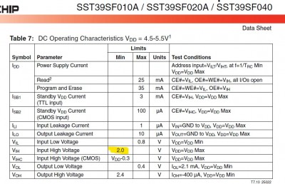

Well, I've been experimenting! And now I have some questions about interacting with 3.3V.
1) My 3V3 CPLD is sending address signals to my SST39SF040 Flash ROM. The ROM is powered by 5V. I have looked over the datasheet and I cannot find anywhere it says that 3V3 inputs are acceptable except for a tiny mention "TTL compatible". Right now I have 3.3K pull-up resistors to 5V on those lines so (in theory) the 3V3 signal from the CPLD is simply grounding when low and 'letting the resistors pull up' when high. At least that's my theory. I believe it still works without those resistors but I'm scared to touch this ... breadboard. I am aware of the SST39LF040, powered by 3V3, but it also says it's "max high input" is not 5V, so it doesn't seem 5V tolerant. Any experience with the SST39SF040 with 3V3?
2) My 3V3 CPLD is connected to a 74HC166, with 1K pull-up resistors to 5V, and it seems to work ok. When I didn't have those pull-up resistors I got interesting results at times. I plan on replacing it with a 74HCT166. That should be seamless, right? No need for pull-ups anymore?
3) I'm sending a 5V signal to my 3V3 CPLD. The CPLD is the XC9572, which is 5V tolerant. But I was reading the high and low logic levels for it on the datasheet. A high is anywhere from 2.0 to 5.5V, but a low is 0 to 0.8V. I think this ... breadboard is giving me groundbounce, perhaps past the 0.8V range, and so I put a 1K pull-down resistor on the 5V signal to stabilize it. It works much better with it there, and works sometimes without it. Does this sound right to you?

Re: SMT/SMD, 3V3, and CPLD Routing Tips?
Posted: Fri Jun 30, 2023 11:50 am
by Martin A
The VIH figure from the DC part of the datasheet shows you the minimum voltage that will be accepted as a high, in this case that's 2.0v. There's no maximum quoted so anything from 2v to the absolute maximum of any pin of VDD+0.5 is acceptable. (Though input voltages over the supply should be avoided for the long term health of the device.)
As long as the CPLD is guaranteed to output at least 2v, then you're in spec.
Posted: Fri Jun 30, 2023 12:15 pm
by sburrow
Thank you, and yes I saw that.
But the "CMOS" version does not guarantee 2.0V. So what is the difference between the CMOS and the, uh, blank?
Thank you again.
