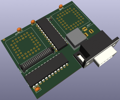

so this has 2x PLCC 44 sockets, a couple of placeholders for RAM and ROM, an oscillator can, a power jack, an RS-232 DB-9 Male(?), and a place for the ribbon to go to the screen, an 2 pin header for the speaker, it needs pins in for the buttons and an on-off switch, still its just to see how things fit.
I think Ill redraw tomorrow with a USB and room for the 76489 PSG instead... I simply have no real reason to include the 6522 on this design. (except I will probably use it later). For sound, Id use a PSG... I have real need for I/O on this.
CPU talks to RAM, Talks to Screen, Talks to sound IC, reads ROM, Reads and Writes to RAM, Reads 8 buttons for input...
Thats all it does I think, until you add some kind of storage (might not really change much or need a 6522), or I use USB (a USB chip is better) or a serial/rs-232 port...
anyway, yes you can fit one on here, though I am 'of a mind' that the 6522, and the db-9, are in 'user extension space' and I am more likely to add a headphone jack and a better sound chip personally, others might want a UART, or a better video chip, or more RAM or Storage, maybe an SD card slot instead...
6502 on left, RAM in center, ROM on bottom left, the thing in middle left is the connector for the screen, it doesnt look right call it a place holder. 6522 on right, , Oscillator, power jack leads and a serial port under that. The Caps are for decoupling. Its not really right, it does offer some clarity on how much space there is...
I am very torn on the 6522, and am now very interested in A) putting one on here to gain experience, or B) building a desktop computer with one in it later...
idk, I want to keep scope down, make this as hobby friendly and approachable as possible, and be 'finishable' and 'startable' for young people, old people, people that have shaky hands or are bad eyesight, etc. This should really have a focus on 'what can you do with it' after its built, something missing out there in many places.
6502, RAM, ROM, RTC, Screen, Buttons, Speaker, Battery.
Adding a PSG would be 'real nice'. Adding a 6522 lets it...?

One thing I've done with the '22 is the recording and playback of sound, even music, using 8-bit A/D and D/A converters connected to its ports.  What I have not done, but thought about a lot, is actually calculating the waveforms in software.  It would take quite a bit of processing from one timer interrupt to the next, but I think a 65c02 running near 20MHz would have the processing power to combine quite a few complex voices and put the summed output out to a D/A converter, and potentially give you much better sound than any of the sound chips of yesteryear could, as long as it doesn't have to be doing multiplication and division.  8-bit audio can also give surprising quality, as shown on the C64 at https://www.youtube.com/watch?v=UYAf_awh5XA .
Something else I have done is use the 65c22's synchronous-serial port free-running at a rate controlled by T2 as a 9-level D/A converter, which is like just a tad more than 3-bit, which is better that some talking toys.  See http://wilsonminesco.com/6502interrupts/index.html#3.3 .  It works out fine for speech with a lot of dynamic compression, but I don't remember if I've tried it for music.  That, too, would have to be highly compressed, and even then, it would sound pretty bad if you put a lot of instruments through it at once.  My original use for it was for DTMF for phone dialing in the 1990's, where you're only generating two frequencies of sine waves at a time.  It worked great for that.
I think I can get it to do what I am talking about as well, with about the same amount of extra hardware... wasnt one of those 6522 bugs solved by a flip-flop?
Yes, you can get around the bug with a flip-flop; but again, unless you're running the synchronous-serial port with an external serial clock source, the bug won't affect you at all.  When you use the 6522's serial port, the more common thing is to have the '22 generate the serial clock, and have it controlled either by T2 or Φ2.  There's no bug in those five modes.

You could do something like the tiny plug-in modules like I show in the middle of the front page of my site, http://wilsonminesco.com/ . I've done these with both SPI and I²C, with the SPI-10 connector and I2C-6 connector.  You'd need a way to put the data/program material into the module; but once it's there, you can have various ones for various applications and swap them out without being tethered to a host computer.
Im not sure if Im going to put an MCU on here to handle RAM/ROM and I/O yet, probably not, pin count is a concern here and Im not a big fan of SPI or I2C, Im more of a parallel guy I guess. idk, Im looking into it though, several chips I like use IIC or SPI (I think I prefer SPI maybe), though I still want to write to them directly, or have an MCU do that.
I²C and SPI serve different purposes, and many parts will be available only in SPI and many others only I²C. The ones where transferring files or other large amounts of data will be SPI, because I²C is just too slow for that.
I just have no room on this board to do much, even with the smaller packages.
On a full size system, you might have enough stuff for all of this... I am not certain I will have much if any devices to connect to, even ICs here...
Anything I build beyond an absolutely minimal system here, will really be done on another project.
Um... That kind of conflicts with your preference for parallel.  Many of the I²C and SPI devices are available in SO-8 or even tinier packages, with far fewer connections than any parallel counterparts.  That's partly what these interfaces were designed for.
