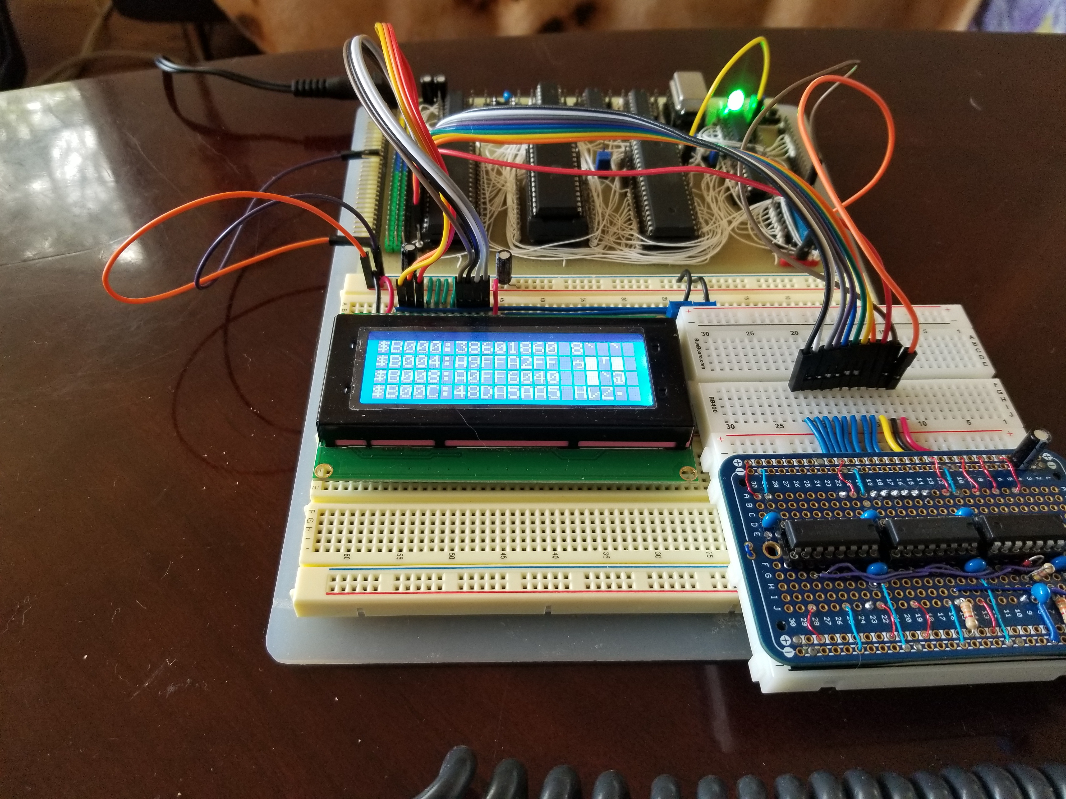

Part 4
Hex Mode
Drawing the hex mode display is fairly straightforward. I (now) use an 80 byte array as a framebuffer and a variable as an index into the array for accessing specific screen positions. I also defined some handy constants to make getting around the display a little more convenient.
PM_FB_LINE1     = 0
PM_FB_LINE2     = 20
PM_FB_LINE3     = 40
PM_FB_LINE4     = 60

One thing we still don't have is a way to transfer the framebuffer to the LCD. That's what _PM_refresh does:
_PM_refresh:
    pha
    phy
    lda     #0
    sta     LCD_cursor
    jsr     _LCD_set_cursor
    ldy     #0
.loop:
    lda     PM_frameBuffer,y
    jsr     _LCD_chrout
    iny
    cpy     #80
    bne     .loop
    ply
    pla
    rts     ; _PM_refresh

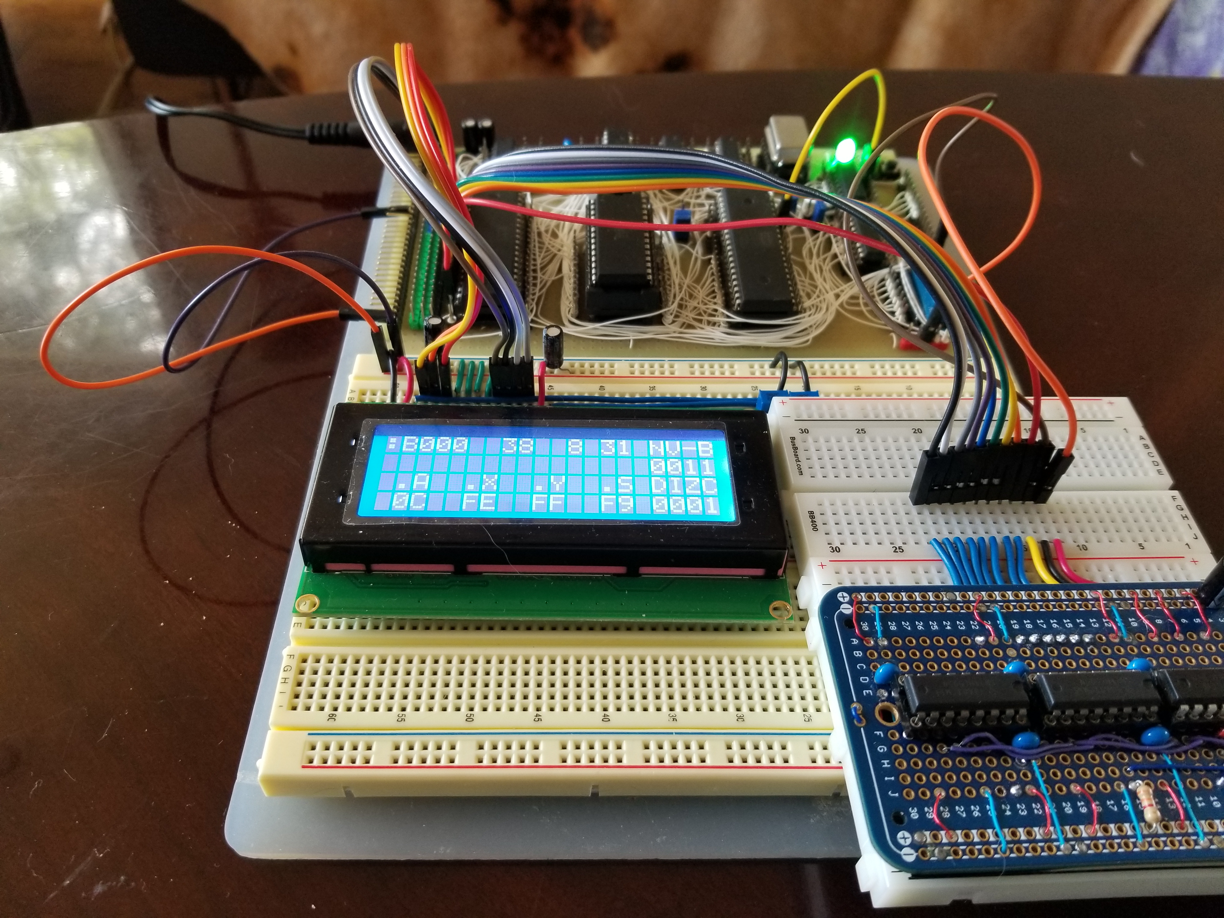

Part 5
Register mode display
The original VISIMON only had 3 output lines. First, a constant string to label the displayed registers. Second, the variable output field line displaying the currently selected address, its contents as a two-digit hex byte, the same contents as a character, and the four registers (.A, .X, .Y and .P). Third, and last, the "arrow" line that prints an arrow pointing to the currently selected field. It simply calls a separate subroutine to display each line.
PAGIMON has more output fields, more labels, and is arranged differently in its smaller display space, but it uses essentially the same strategy to draw the UI:
_PM_regMode_display:
    jsr     _PM_clearFB
    jsr     _PM_line1
    jsr     _PM_line2
    jsr     _PM_line3
    jsr     _PM_line4
    jsr     _PM_status
    jsr     _PM_placePrompt
    rts     ; _PM_regMode_display

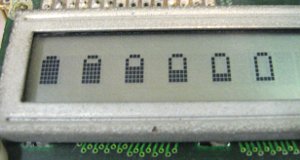

Personally, I find the mixed case status confusing; instead I simply use (for the example above) ---B-IZ- so that only set flags are shown. YMMV of course.
Does the LCD chipset offer an underline option? I have a vague memory that some do, but it's been a long time... alternatively, could you flash the cursor (requiring multiple writes of course)?
Posts: 8775
Re: 6502 Machine Language Monitor for 4 x 20 LCD - HOWTO
$5F is the underline.  But again, replying to both comments above, you can have up to eight custom characters in the LCD at once.  These will take the "ASCII" (not really ASCII of course, but in the table) positions 00 through 07.  This means you could also make tiny custom capital letters for cleared bits and use the regular capitals for set bits, or add some sort or other mark in the character box to indicate the set or clear status.  I made the following custom characters to display battery status on a project eight years ago:
(This was just to show them all at once.  In the final application, only one battery-level character would show, way over at the right end, and only when the space was available.)
For another project in the late 1980's, I had dozens of custom characters, which is not a problem as long as you don't need more than eight different ones in the display at once.  So when a custom character was needed, the LCD routine would examine a cache variable array in RAM to see if the character was recently defined in the LCD's character-generator RAM.  If it found it, it would use that number (in the range of 0 to 7); otherwise it would replace the least-recently-used custom character number with the new one.

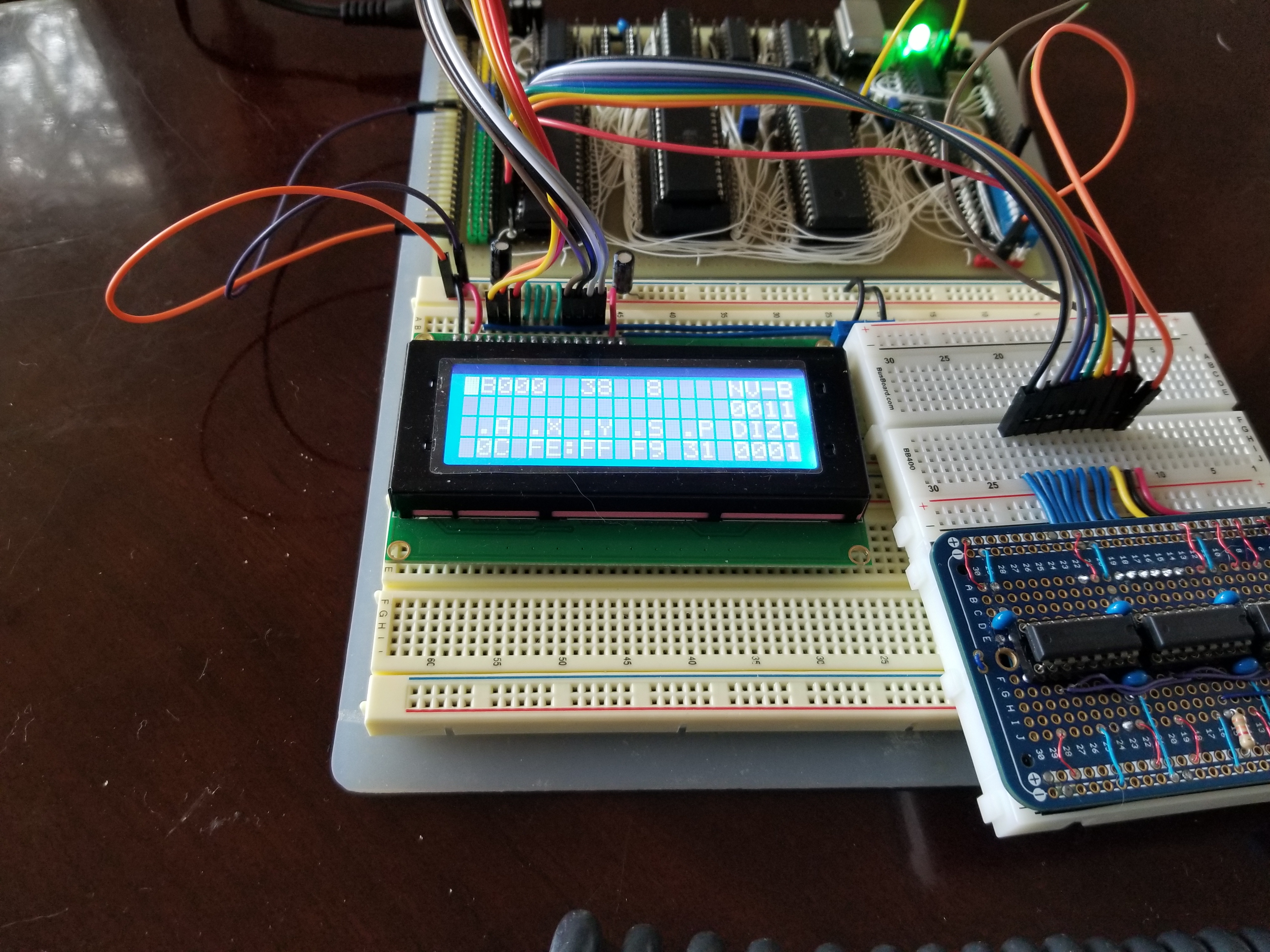

Cool pictures! I do like the "display 16 bytes" window a lot, but I see your point to have a type of 'user interface' section as well.
Your board's setup looks so organized :) Honestly.
Ever think of doing the PS/2 Keyboard decoding in software? Would save a ton of pins and 3 IC's. Sorry, off topic, was just wondering.
Thanks for the pictures!
