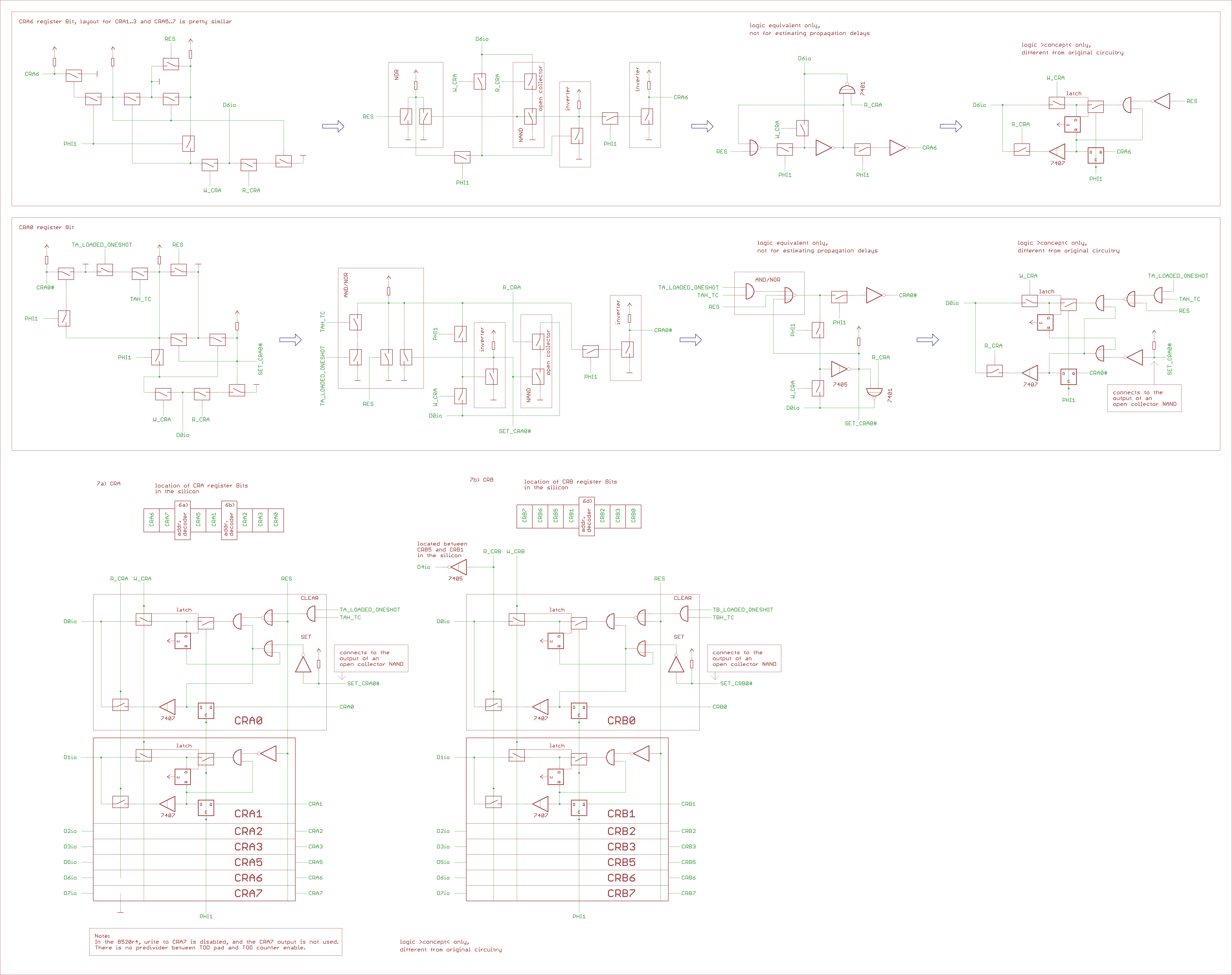

7) CRA, CRB //control register A, control register B
The CRA (control register A) and CRB (control register B) Bits are located
North of timer A and Timer B.
For CRA1..CRA7 and CRB1..CRB7, the layout of the register Bits is pretty similar,
a register Bit cell is just a half_static latch,
written with high_active control signal W_CRA (or W_CRB) at PHI2, refreshed at PHI1,
cleared at PHI1 when RES is active.
Outputs of the register Bits which control circuitry on the chip are sampled
by transparent latches at PHI1 to prevent glitches (during PHI2 register writes).
The register Bits can be read back on the internal data bus,
controlled by high_active read control signal R_CRA (or R_CRB).
Note, that the CRA7 register Bit write enable is tied to GND. //disabled
Also, the output of the CRA7 register Bit is not used:
There is a trace which goes from the CRA7 register Bit
into the area around the TOD pad, and ends there.
In the 8521, there is a predivider between the TOD pad edge detector (and syncronizer)
and the TOD counter, and the predivider is controlled by CRA7.
So we could assume that the 8520 chip layout builds on the 8521 chip layout.
CRA0 and CRB0 build on the layout of the other CRA\CRB register Bits,
but there is some additional circuitry related to timer control.
Besides that, the outputs of CRA0 and CRB0 which go into the
timer A and timer B control circuitry are low_active.
CRA0 enables timer A, CRB0 enables timer B.
Layout for CRA0 and CRB0 is identical, so we focus on CRA0.
In "8e) timer A control logic", we have an "open collector" NAND
which sets CRA0 (at PHI1) when timer A runs in one shot mode
and TB_HI was written in the previous PHI2 cycle,
what enable timer A counting.
//The pullup for the open collector NAND is part of CRA0.
Point is: In the silicon, the CRA0 register Bit is attached at the West end
of "8e) timer A control logic".
High_active signal TA_LOADED_ONESHOT indicates
that the timer A counter cells were loaded
while timer A was in one shot mode.
It is generated in "8e) timer A control logic".
High_active signal TAH_TC indicates that timer A will roll over
from $0000 to $FFFF in the next PHI2 cycle when timer A counting is enabled
(that's timer A underflow).
It is generated in "8b) timer A HI".
When TA_LOADED_ONESHOT and TAH_TC are active,
that's a timer A underflow while timer a is in one shot mode,
CRA0 is cleared (at PHI1) to stop timer A counting.
CRB0 and the related timer B circuitry are pretty much identical to this.

About timer A control logic setting/clearing CRA0:
If CRA3 = 0, timer A is in continous mode.
If CRA3 = 1, timer A is in one shot mode.
Short form:
If TA_HI is written when timer A is in one shot mode CRA0 is set.
If there is a timer A underflow while timer A is in one shot mode, CRA0 is cleared.
Now for the longer version:
If timer A was set to one shot mode (for at least) in the previous PHI2 cycle,
and if the TA_HI register is written, low_active signal SET_CRA0# sets CRA0 at PHI2
for starting timer A.
If the timer A counter cells were loaded with TA_LD in the previous PHI2 cycle,
and CRA0 is not set by SET_CRA0# (both things are checked by a RS flipflop),
if timer A was set to one shot mode (for at least) in the previous PHI2 cycle,
the high_active signal TA_LOADED_ONESHOT goes active.
Signal TA_LOADED_ONESHOT and high_active signal TAH_TC (which indicates
a timer A underflow with counting enabled go into "7a) CRA0".
If both signals are active, this clears CRA0 at PHI1.
Note, that the PHI1 controlled latch in the timer A control circuitry
which samples CRA3 at PHI1 is redundant, because CRA3 already
is sampled by a transparent latch at PHI1 in the CRA3 register Bit.
//So maybe timer A control circuitry and the CRA register Bits were done by different designers,
//or by one and the same designer who had to do too much different things in between.
