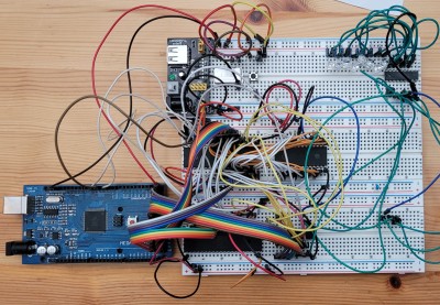

a short update, as the first breadboard build didn't work, i'll give it another try.
Removing all and starting again, with an Arduino Mega as a clock source and bus monitor.
Aun i think, i found the problem with the first build. A13 had no connection from the CPU to the breadboard bar. So I opened up the breadboard and used the pliers to squeeze the brackets together a bit. Now it's working. Next I need to put the RAM back in and repeat my initial tests with the 6522.

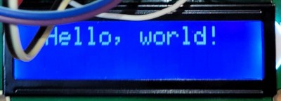

Today I wanted to breathe a little more life into the SBC. Actually, I wanted to install the RAM, but you wouldn't have seen anything there, except in the monitor. So I decided without further ado to connect the LC display. I didn't find the direct method so convincing, so I connected the display to the 6522. (I might do that later with 4 bits or I2C) I connected it to port B with full 8 bits and 3 lines to port A like Ben Eater did in his video. And indeed it is alive. A few small changes to his source because of the different addresses and the RetroAssembler and I could already see the Hello World on the display. Here's the proof:
Re: W6502SBC, a simple 6502 sbc
Posted: Sun Aug 14, 2022 3:55 pm
by BillO
Nice progress.
The direct attachment does work quite well though.
http://www.6502.org/mini-projects/optrexlcd/lcd.htm
