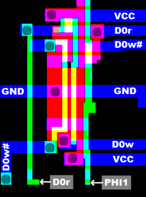

11) IER //interrupt enable register
IER contains 7 RS flipflops, working as the register Bits.
The high_active outputs of these flipflops go into "12) IFR" for enabling IRQ generation
of the IFR (interrupt flag register) Bits.
High_active read control signal R_IER reads the register Bits into the internal
read data bus D0..6r during PHI1=0, also it switches D7r to VCC during PHI1=0,
so that the MSB always is 1 when reading IER.
Internal write data bus signal D7w# (low_active) goes into an inverter,
which sends D7_w into "8) address decoder".
When writing IER, the address decoder generates two high_active
write control signals during PHI0=0, depending on D7_w:
If D7_w=0, W_IER0 connects D0..6w# (low_active) to the low_active R# inputs of the RS flipflops.
Means when writing binary 0xxxxxxx to IFR, if x=1 this clears an IFR register Bit.
If D7_w=1, W_IER1 connects D0..6w# (low_active) to the low_active S# inputs of the RS flipflops.
Means when writing binary 1xxxxxxx to IFR, if x=1 this sets an IFR register Bit.
Of course I'm simplifying things, because the RS flipflops are not built from two NOR gates,
they are built from two "open collector" inverters which have pullups to VCC at the outputs.
This trick makes the RS flipflops smaller than when using NOR gates.
For RS flipflops built like this, R# is identical to Q, and S# is identical to Q#.
Note, that all of the IFR register Bits are asynchronously cleared by RST.
Control signals enter the register block from the South,
North of the register blocks we have the usual FETs switching control signals to GND
during a certain clock phase.
IER7: always reads 1, when writing IER use Bit 7 for selecting CLEAR or SET.
IER6: enable IRQ generation for active IFR6 //Timer 1 underflow
IER5: enable IRQ generation for active IFR5 //Timer 2 underflow
IER4: enable IRQ generation for active IFR4 //CB1 active edge
IER3: enable IRQ generation for active IFR3 //CB2 active edge
IER2: enable IRQ generation for active IFR2 //shift register
IER1: enable IRQ generation for active IFR1 //CA1 active edge
IER0: enable IRQ generation for active IFR0 //CA2 active edge

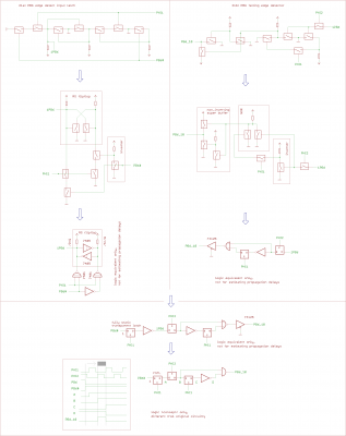

13) CA1 input
Note, that the CA1 pad has no pullup to VCC inside the 6522 chip.
Tied to the CA1 pad, we have an edge detector sampling CA1 during PHI0,
it sets IFR1 by high_active signal S_IFR1 when detecting an active CA1 edge.
Active CA1 edge is selected by PCR0:
PCR0=0: CA1 falling edge detect
PCR0=1: CA1 rising edge detect
To me, the circuitry looks a bit odd (the part where signal IFR1 goes into it),
and I wonder why Bill Mensch (TM) had implemented it that way.
My guess is, that it compensates for something that might happen when/while/after IFR1 is cleared.
Maybe somebody (not me) should write a technical article about this.
Point is, that we have that sort of edge detector at the CA1, CA2, CB1, CB2 pad.
Chip layout does vary for making better use of chip space,
but from the logic design point of view these 4 edge detectors are more or less identical.
Thanks to org\breaknes for taking a look at the CA1 edge detector circuitry.
He confirmed, that I had interpreted the polygonized chip picture of the CA1 edge detector correctly.
Also, he had mentioned that another approach for getting a better understanding might be
splitting the RS flipflop of the edge detectors into two separate RS flipflops,
one scanning for CA1 rising edge, and one for CA1 falling edge.
Of course, the schematic just shows a possible direction to take,
and it still might require some work... but it's good for a (new/different) start.

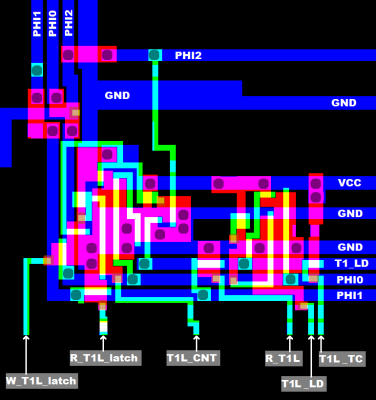

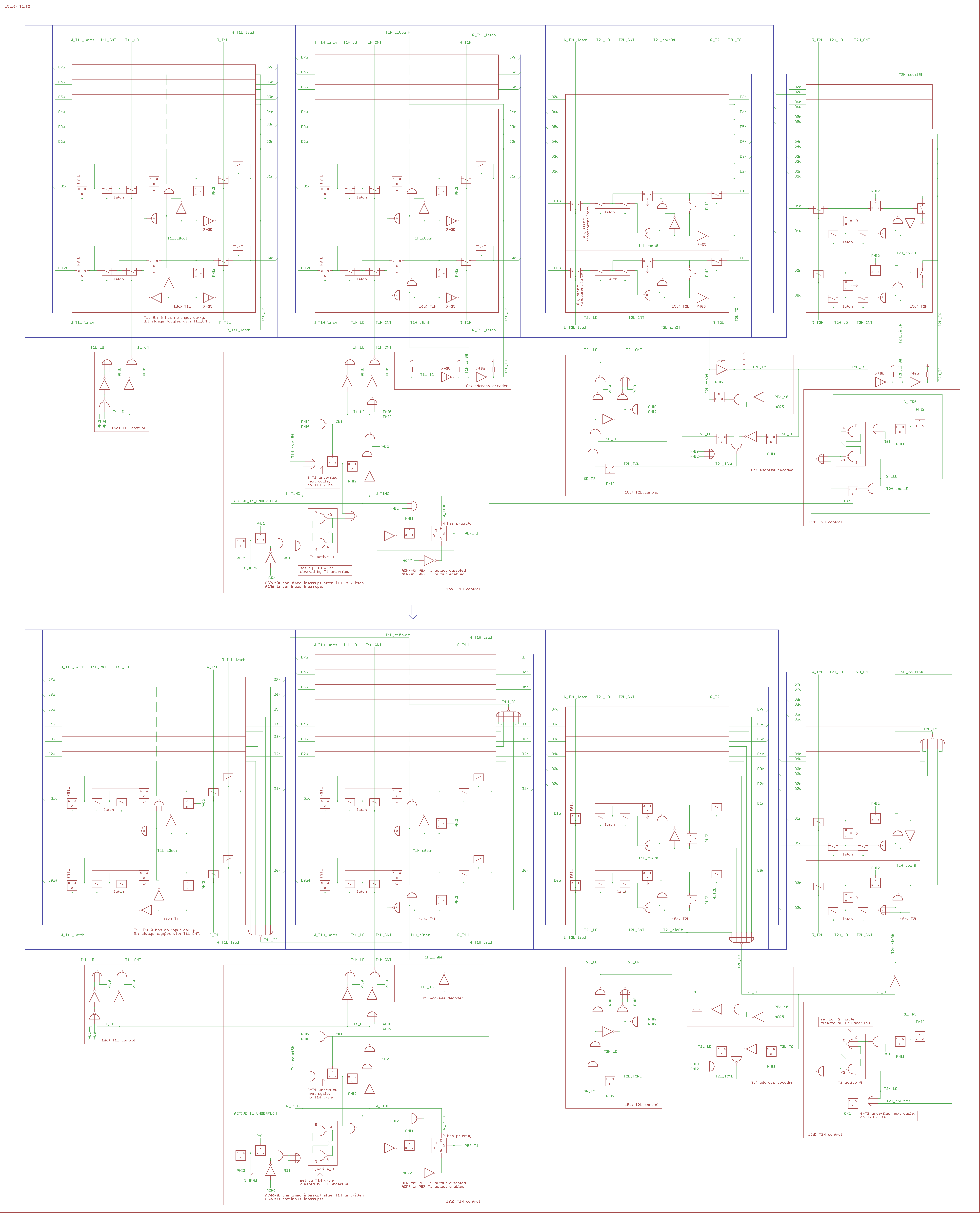

15a) T2L //Timer 2 low (Bit 7..0)
Timer 2 is a down counter using an inverting/non_inverting carry chain. //ripple carry.
Counter Bits 0,2,4,6 have low_active input carry and high_active output carry,
Counter Bits 1,3,5,7 have high_active input carry and low_active output carrry.
Down counter means:
If the carry input of a counter cell is active, the counter will toggle in the pending clock phase.
If the carry input of a counter cell is active and the counter Bit is 0,
the output carry goes active.
Counter cells have a fully transparent static latch,
High_active control signal W_T2L_latch loads the latches from the write data bus during PHI0=0.
High_active control signal T2L_LD transfers the contents of the latches into the counter Bits.
High_active control signal T2L_CNT tranfers "the new counter value" into the counter Bits.
These two signals are active when PHI0=0 AND PHI2=0.
High_active control signal R_T2L reads the T2L counter Bits into the read data bus
during PHI1=0 (what is different from PHI0=1).
T2L_cin0# is the low_active input carry of the LSB (Bit 0) T2L counter cell,
it comes out of a transparent latch controlled by PHI2.

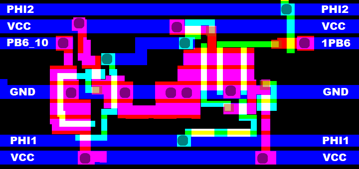

If ACR5=0, input of the latch is low, and Timer 2 is running at PHI2 speed.
If ACR5=1, the output of the "PB6 falling edge detector" goes into the latch,
what means that Timer 2 is counting gown one step after there was a falling edge
at the PB6 pad.
High_active signal T2L_TC indicates a Timer 2 low terminal count,
means that T2L_TC is high if T2L=$00 and T2L_cin0#=0,
what will make the T2L down counter Bits roll over to $FF during PHI0=0 AND PHI2=0.
Note, that T2L_TC changes during PHI2=1.
Of course, in the silicon the NOR gate is broken into 9 parts,
one attached to the T2L Bit 0 input carry, the rest attached to each of the counter Bits,
to make better use of chip space.
T2L Bit 0 and Bit 1 counter cells:
15b) T2L control
This is the circuitry which generates the control signals T2L_LD and T2L_CNT for Timer 2.
Either T2_LD (load) or T2L_CNT (count) is active during PHI0=0 AND PHI2=0. //but not both.
T2L counter is loaded, when T2H counter is loaded (signal T2H_LD).
If the shift register uses Timer 2 (actually T2L) as a clock source, SR_T2 is high,
T2L is re_loaded from the latch after T2L_TC indicated a T2L underflow.
//I'm simplifying things a bit, but that's the basic concept.
Note, that some part of the related circuitry is in "8c) address decoder".
//Hey, cutting the silicon into functional blocks sometimes isn't that easy to do...
Also, see "22) shift register control" for signals T2_SR and T2_TCNL.
Shift register control generates the high_active T2_SR signal, telling T2L control
that the shift register uses T2L as a timebase for generating the shift clock.
T2L control generates the high_active T2_TCNL signal, telling shift register control
that T2L reached terminal count AND there was no T2L write.

16d) T1L control
T1_LD generated in "16b) T1H control" indicates a Timer 1 load.
From this signal, T1L control generates the two control signals
T1_LD and T1L_ CNT. That's all there is to it.

Now for an overview about the whole Timer 1 + Timer 2 section:

17) D0..w# inverters, precharge
Fully static transparent latches sample the high_active D0..7 pads
(tied to the external data bus) during PHI0,
and place low_active D0..7w# on the internal write data bus.
We have 8 inverting super buffers, generating high_active D0..7w
from low_active D0..7# for the internal write data bus.
The internal read data bus D0..7r is precharged to VCC during PHI1=1.
//6522 registers are read into the internal read data bus during PHI1=0.

21) PB6 falling edge detector
Not much to say:
A fully static transparent latch taps into the PB6 input circuitry
for sampling PB6# during PHI1.
The latch is located North from "22) shift register control".
The output of said latch feeds an edge detector built from dynamic latches.
It emits the high_active PB6_10 signal during PHI2 after there was a falling edge on PB6.
The edge detector is located South from "22) shift register control".
PB6_10 goes into "15a) Timer 2 low",
Timer 2 then counts down one step after a PB6 falling edge if ACR5=1.
//Timer 2 counts down with PHI2 if ACR5=0, ignoring PB6.
