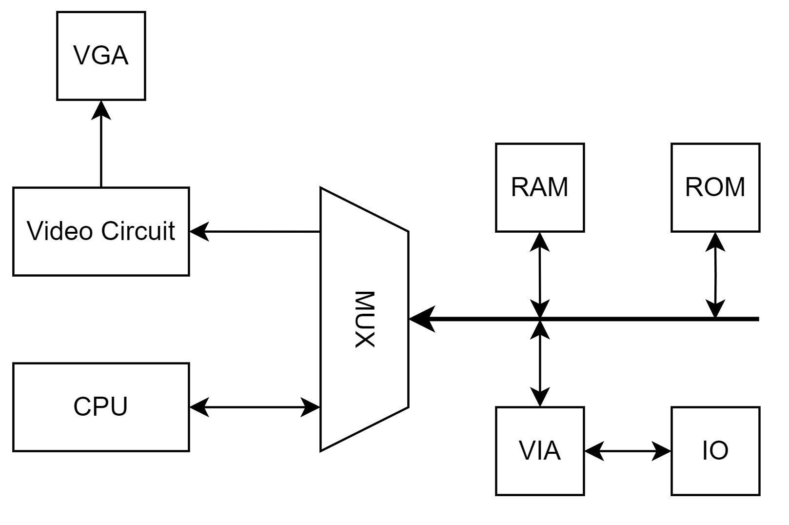

interesting design!
i've wanted to try something like this for a while now but never got around to it.
currently i'm using an ATF1508 hooked up to an 8kB Dual Port RAM IC. it works perfectly but DPRAM is not cheap in large amounts so i might just try this out.
if i understood the schematic right then this should be a simplified block diagram of your system:

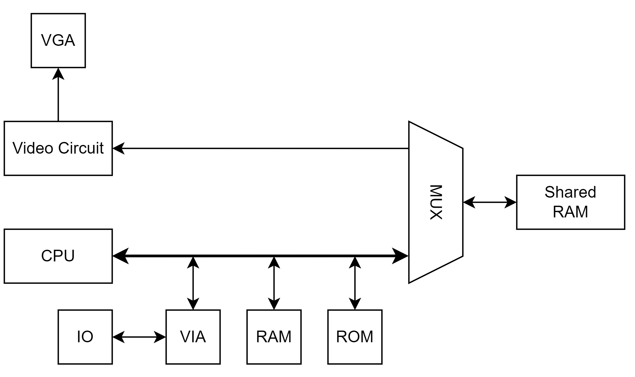

and i got a question about it, why is the whole memory map shared between the Video Circuit and the CPU, including IO?
i assumed it would be more like this:
where only some RAM (and maybe a character ROM) is shared between both, and stuff like IO and a program ROM would be exclusive to the CPU Bus.
does it simplify the circuitry to share the whole bus instead of a part of it?
Thank you! And yes I understand.
I... do not know exactly how to read simplified block diagrams apparently. I get where you are going. I'll try my best.
The User RAM and the Video RAM are separate. I would see this system something like 6502 + 32K User RAM + 32K User ROM + VIA I/O, and then I said, "Hey wouldn't it be nice to add VGA to this simple circuit?" So I put 3x 74HC244's on the address bus and data bus, and connected the other end to 32K Video RAM which 'shadows' the 32K ROM area (read comes from ROM, write goes to RAM). VGA reads from that Video RAM through shift registers.
The problem is how do I set up the timing of the VGA? That's where the counters and Video ROM comes in. I programmed it in binary to send out signals at just the right time. So:
Counters -> Video ROM -> Sync Signals
and
Counters -> Video RAM -> Shift Registers -> RGB Signals
and
6502 -> Video RAM
The only 'talking' the 6502 can do with this VGA system is through those 74HC244's and only at very specific times when the VGA circuit doesn't care (because it's shifting instead of loading). The rest of the time, this VGA circuit just does it's own thing.
I hope that answers some questions. I do not share any RAM or ROM, they are completely separate from one another. Only the 6502 has access to the VGA circuit, and only at very specific times.

Re: Apple II VGA (Schematics and PCBs)
Posted: Fri Mar 18, 2022 2:49 pm
by gfoot
Yes it's the problem I mentioned here: viewtopic.php?f=4&t=7030&start=0#p90951
It reduces the time for things like address decoding to see the address before the read/write signals are activated, and it's also likely to confuse things like the 6522 which expect valid address at the start of phi2.
Ideally only the video RAM should be behind the transceivers, and everything else should be directly connected to the CPU's bus.
It's probably hard to fix on the PCB unfortunately. It sounds like what you have already is working though. If you do have trouble with the 6522 then you could maybe delay the 6522's phi2, like the write enable signal - and that might be possible to bodge. I'd definitely fix this on the next PCB revision though!
in case the big "MUX" is a bit confusing, that thing basically just represents your Address/Data Bus Multiplexer.
oh wait, i'm stupid.
i just saw that you had an updated schematic further down the thread. i read through the whole thread but when doing the diagrams i used the one from your first post where it only had a single RAM IC, so your description here really confused me for a second.
and
and
6502 -> Video RAM
yea looking at the correct schematic this time, i see what you mean. quite clever to use a ROM as replacement for logic!
EDIT: Yes, after looking over those diagrams again, I see that it is the SECOND one you have there. Yes exactly. Thank you!
yea, again sorry i looked at the wrong schematic... and the second diagram is closer to what you actually made.
and that makes me wonder if it would be possible to adjust your system to have the CPU and Video Circuit (VC) running at different clock speeds. it would likely require a few extra octal D latches between the CPU and VC, but it would allow you to run the CPU faster to do more work!
hmm, something to think about.
