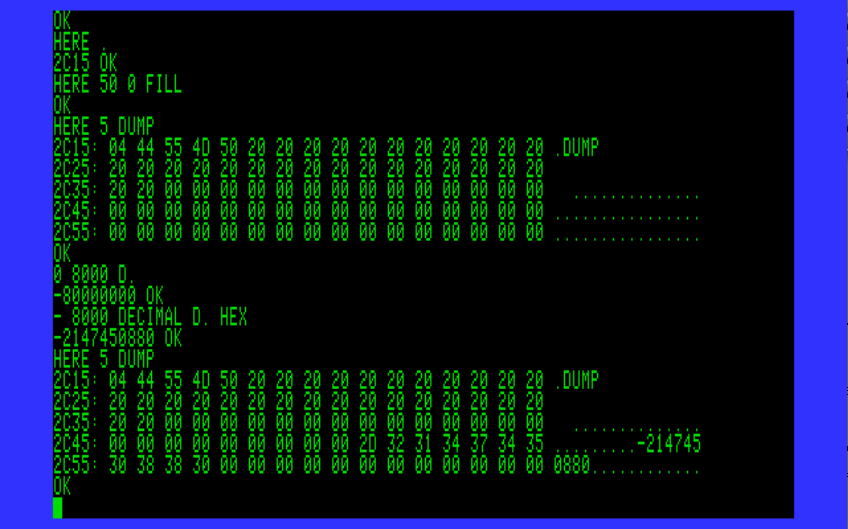

After some testing and a few memory dumps later, I have come to the conclusion that the max space between HERE and PAD need only be 24 bytes and has nothing to do with a word being defined, but has to do with the longest decimal number that can be entered. A word definition that is copied to HERE that is 25-31 characters is compiled separately and does not interfere with the numeric data area or PAD.
As for numeric expressions, the longest entered number is a 32-bit hex "FFFF 7FFF" or its decimal equivalent (-2147483648) which is only 11 characters for the decimal word. To print the decimal number requires it to be entered as a word to HERE, then NUMBER deciphers it. Then 13 characters at HERE (1 for the length byte and 1 for the space at the end of the word) and 11 for the numeric output only uses 24 characters.
If your Forth can handle 64-bit, then the largest 64-bit decimal number is -9223372036854780000 requires 22 + 20 = 42 space gap required at HERE. My Forth doesn't do that.
The only test I haven't done much with is building a numeric expression as the only example I have to go off of is the one at D.R. But for the most part, doing a DUMP of the memory at HERE definitely shows what is going on.
