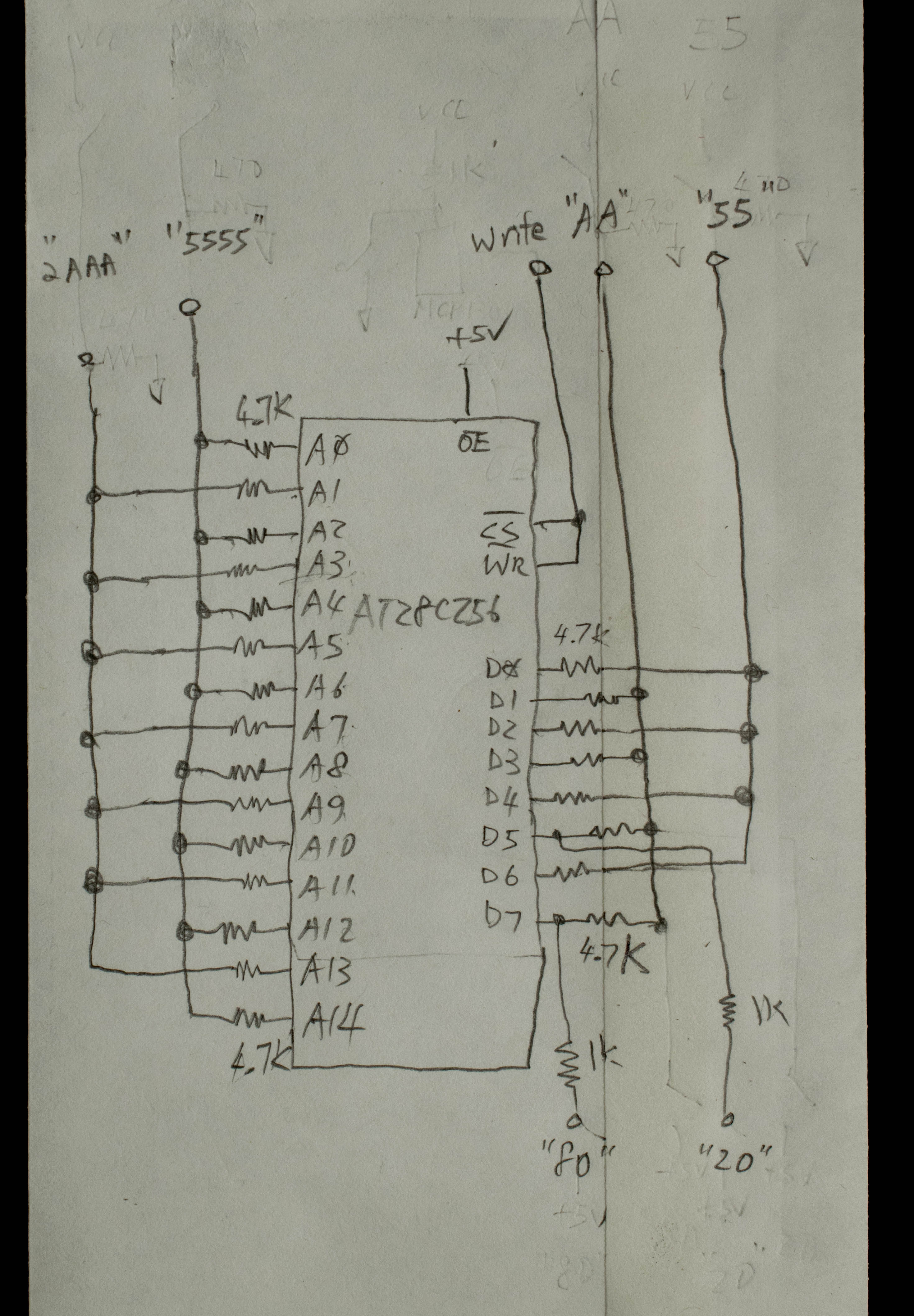

Unless you locked it by sending the SDP enable sequence to it, it shouldn't be locked. In any case, you can unlock by sending the SDP disable sequence. Both are shown on Page 10 in the attached datasheet.
Also note that you can always write to the (protected) chip by sending the 3-byte enable SDP sequence first, then send the data to any address you want.
Re: Basic EEPROM programmer
This is the datasheet I've been using. In this one, they have "Chip Erase Waveforms", which indicates that /OE must be driven to 12V for some time while doing other things, and apparently things should be erased.
The datasheet is so vague about this that I don't know *what* they want me to do. But, I tried it anyways. I applied 12V to /OE, moved the /CS and /WE pins appropriately, etc, tried to write to it, and still nothing. Still software locked.
I'm giving up on unlocking it. Either I pay $50 for a programmer, or I buy a new one for $15 on Mouser. The Pi can definitely program an unlocked EEPROM, just like I could with DIP switches and push buttons.

You have options.... here's some simple code that will send the SDP sequence and allow a single byte to be written... in 65C02 assembler. You can pattern your own code after this. Note the EEPROM label is the physical address offset in the memory map. In other words... for my C02 Pocket SBC, the EEPROM address starts at $8000, so that needs to be added as an offset to the actual addresses used for the SDP sequence. Note that this code can NOT be run from the same EEPROM... so it's a segment of code that gets copied to Page Zero in my Monitor code and executed by a JSR after the Page Zero variables are setup for the Source and Target addresses.
Also note that once you send the SDP sequence, you can use Page Mode and send 64 bytes sequentially. Of course, refer to the datasheet on this. Also, you can easily modify the code aboe and send the SDP disable sequence to unlock the EEPROM.

Just a couple of thoughts: this page reckons python can switch GPIO at 7us intervals, in the best case, on an original Pi 1. I haven't checked with the datasheet as to whether this ought to be fast enough, or not.
Also, as the unlock sequence involves writing particular bytes to particular addresses, any intended or inadvertent swapping of the data bits or address bits on the way to the chip may mean that the chip isn't seeing the intended sequence. Sometimes it's fine to swap bits of a bus for implementation reasons, and sometimes it will have consequences!
It might be that you already have the equipment to measure how fast you are able to send the unlock sequence. But even if you can't measure it electronically, you could perhaps measure it in python itself, by sending 1000 unlocks and timing the overall time, for example. Or 1000000.

Python RPi.GPIO 70 kHz 243 kHz 2,5x
Am I reading something different? I do see the C library stuff is much faster. Hm... I might try this again if I have the time today. Thank you BigEd.
Yep, so 70kHz as a waveform is 14uS period, which is 7us between transitions.
Again, even if I find a way to make it 100x faster, that's nowhere in the range of what they are saying.
If I get more time (between children and the like) I'll see about a straight "GPIO change this pin" speed test. I had tried using that method yesterday to unlock it, but that didn't work.
Does the Python IDE have anything to do with this? Or perhaps I could minimize some background programs while doing this? I'll look into that as well.
On the bright side, I just tested the breadboard with a 62256 SRAM chip, and it reads and writes beautifully! Working as expected, that's always a good thing.
Thank you BigEd.
Chad
EDIT: I disabled the GUI, went TTY, tried the same thing, got 450 Hz now. So that's great, but still nowhere near where I need it.

You may also want to look at the PiGPIO library too. It has a 5µS timing resolution though but is much more deterministic but probably about the same for what you're wanting to do with it.

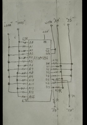

Chad,
Have you thought of wiring even addresses and even data for "2AAA", "AA"; odd addresses and odd data for "5555", "55", and control it with few GPIO pins? Here is a quick sketch of the idea that allows you to generate 2AAA, 5555 for addresses and AA, 55, 80, 20 for data with 6 GPIO pins, plus 1 GPIO for WRITE control.

Replying to two posts:
Bill, yes I tried that one time when I was trying all kinds of things. I did even's and odd's as 2 pins, and that would speed up the process a lot. It turns out it didn't speed it up enough, at least under the software configuration I was using with Python. Good idea though!
Gordon, did you know that you are famous? Seriously! I didn't read your post until just now, but I actually found your "wiringPi" library on my own in between posts. It's actually all over the internet!
And... it worked! Yes, I actually got it to unlock. WOW!
So: C++ and "wiringPi.h" library did the trick. Thank you Gordon for that, it was very helpful. I'm MUCH more comfortable in C++ anyways (C++ is my first language, English is my second, haha jk), so this ended up for the better anyways. Thank you again.
Continuing, in my glee, I said, "Well, the rest of my code should *obviously* work now!" And it didn't. But I did get some blinky lights and that's a start. That was about 3 hours of back and forth. That little EEPROM has seen better days at this point, darn pins have been bent so much I'm scared to pull it in and out anymore (but I still do anyways).
Thank you both very much, I appreciate all the help and I'll report back soon.
Chad
