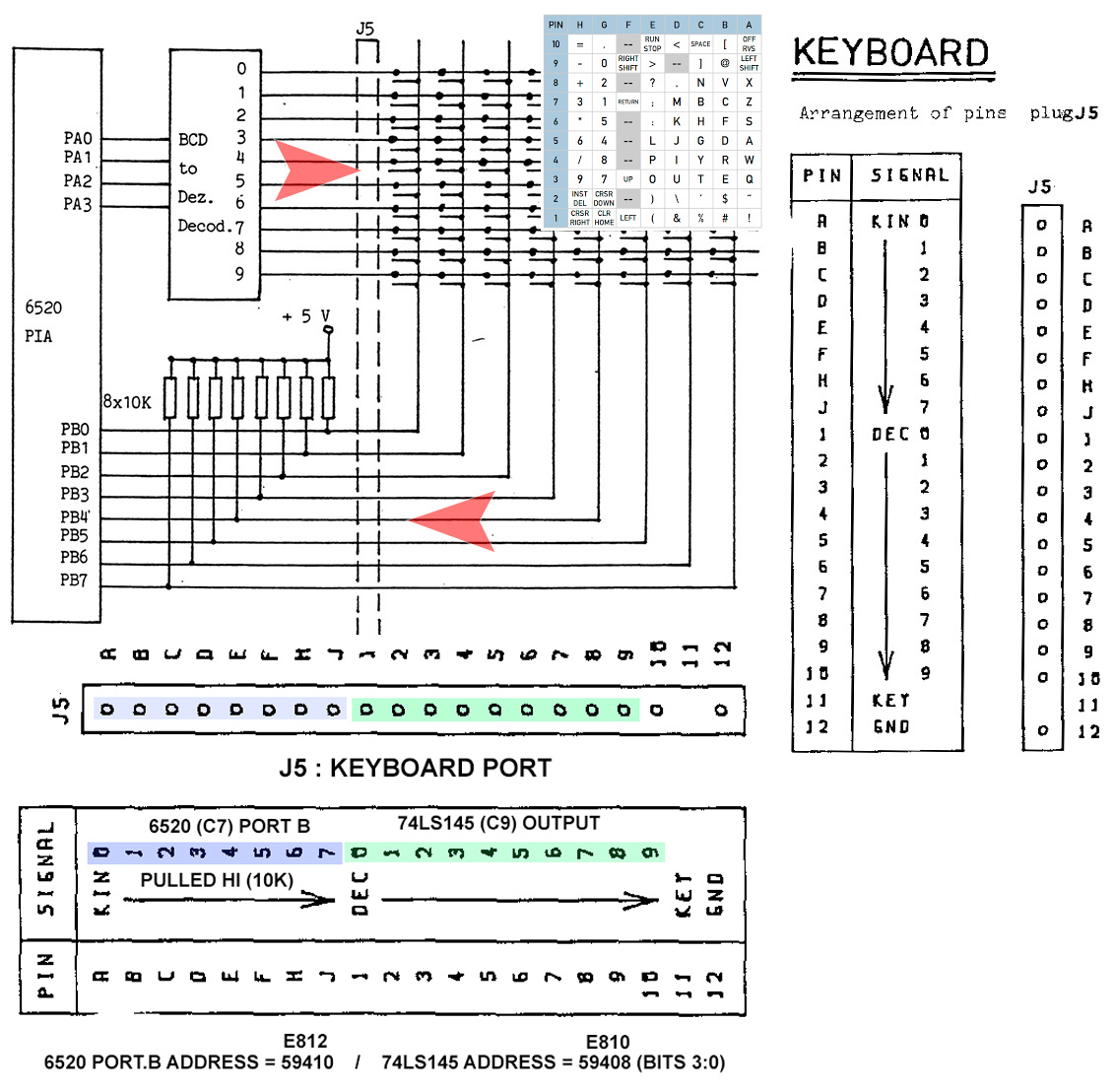

Ok, back to the original problem. In no way can I read the PIA data register, which should show some data no matter which line of the 74LS145 is set. Since the 145 ALWAYS has at least one line low (row selected), some key data should show on the PORTB input. I have tried every key, and nothing.
Here is my adjusted code, dealing with the -2 offset in a way that makes most sense to me. For sure, this code is working, and the INC 32768 (first instruction) is working fine, showing me that my code is in a tight loop. As before, no keypress alters the value read on the PIA input port. SEI also has zero effect on code execution or speed, so I am convinced now that you can't actually stop the PET from running the Kernal code (editor). It must be taking over and clearing the data before my code gets a chance. Nothing else makes any sense here.
I am now out of ideas. On the VIC, this was so easy... just autoboot at that cartridge port address, stop interrupts, and have total control of the machine.
I guess those that coded games in assembly for the PET must have had to use the Kernal routines to read the keyboard, and damn that is going to be slowwwwww! Since the IRQ only fires 60 times per second, that will reduce my goal of 60+ kilobytes per second transfer speed down to 60 bytes per second. In that case, I am not going to continue with this method, and will have to make a second plug to tap into the option ROM socket.
I was hoping to reduce my plug count, but I guess this project is going to end up looking like the beastly board in my Super PET.... plugs all over the place!
Here is my cheat sheet showing the PET keyboard hardware in case anyone is curios as to how the PET Keyboard is connected....

Problem Solved!!
Just as I was about to give up, I decided to take the assembled binary and run it through my IEEE simulator and loaded it onto the real PET.
Whadda ya know. it works as expected!
Must be a Vice thing with the keyboard or screen refresh. The program shown above displays keypresses just as I would have expected.
Ok, back to the project. Now I need to see how fast I can actually stream data to the PIA externally.
I still may be beat by the 60Hz interrupt, but only real testing will prove this true or false.
My next code / hardware test will toggle bit 0 on the 74LS145 row select using INC $E810, making it act as a "Clear to Send" line. The external device will then send the next byte to the PIA through the cable I have attached. The PET keyboard data port will be temporarily disconnected form the PET hardware by the 2 74HC245 buffers I have on my board. The PET will grab the data and hurl it to the Basic Memory starting at location 1025. Once loading is complete, the external device reconnects the keyboard and goes invisible to the PET.
If I get decent speed from reading the PIA, then I should be able to load a 32K program into the PET in under a second.
Will report back when the testing is complete (with video of course)!
Thanks for the help, I am certainly straight with how to assemble a PET program now.

Just to properly close this thread, here is the assembled binary that now works. You can just drop this over a Vice window.
This is not a zip file, just a binary (getting around forum upload limitations).
The 74LS145 is set to ROW.2, which allows these 8 keys to be displayed (97^OUTEQ).
I chose those because they are ascii, and I need at least 8 keys to represent an 8 bit value (makes life easier).
Pressing any of those keys will change the first screen character.
As a speed test, I am also streaming 256 characters to the screen, and it does seem to show that the PET Kernal is not stealing much CPU time at all. Rough tests show that I should be able to get around 30 kilobytes per second into the PIA! Real hardware will prove this soon.
Oh, and on the Vice thing, seems it is maybe a Win11 bug. I eventually did get this code to work in Vice, but only after starting Vice fresh and then clicking twice in its window. Seems it does not get keyboard focus all of the time!!!! That messed me up for a day! Does this on some game programs too.
Anyhow, case closed, thanks for the help.
