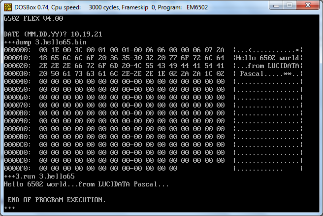

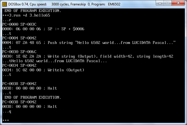

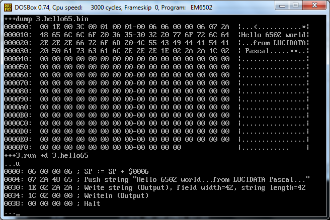

So I morphed the debugger from the 8080 simulator into a P-code debugger.
Now to build a foundation below it to execute those instructions...
BillG
Posts: 710
Joined: 12 Mar 2020
Location: North Tejas
Re: LUCIDATA Pascal for 6502
Post by BillG »
Let the deed shaw...

After many tricks, I finally get a treat. This program runs:
PROGRAM TEST;
  VAR
    C : CHAR;
    I : INTEGER;
  BEGIN
    WRITE("Enter a character ");
    READLN(C);
    WRITELN;
    WRITELN("'",C,"'");
    REPEAT
      WRITE("Enter an integer (0 or <CR> to quit) ");
      READLN(I);
      WRITELN(I)
    UNTIL I = 0
  END.
Access to variables work within the current activation record, in this case, program global variables.
The big pieces of functionality still left to do include:
* arrays
* add, subtract, multiply, divide
* subroutine call and return
* files on disk
* paged mode
The last one is not needed to try running the compiler.
