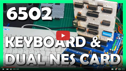

Have just released a new video covering the design and build of a new card (keyboard and dual NES controller)
