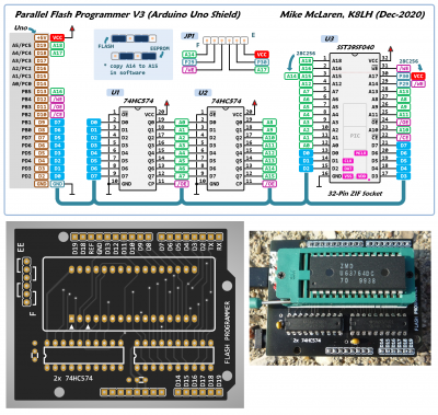

May I mention the SST 39SFxxx series Parallel FLASH ROMs in PDIP package as an alternative to the AT28C256 EEPROM? The 128-KiB 39SF010A is $1.47 at Mouser or $1.52 at Digikey while the AT28C256-15PU EEPROM is $10.75 at Mouser or $10.66 at Digikey (15-Aug-2021). Example (untested) designs below.
Cheerful regards, Mike
Neat suggestion. It's not pin compatible with the EEPROM, which makes it not a great solution for this kit where I want to encourage folks to use the hardware they already purchased for a breadboard build. However, it might be worth while to fab a "converter" card that could drop in a ZIF socket that was intended to hold the AT28C256.
I used a set of jumpers to select between 28C256 and 39SFxxx devices on my Flash Programmer Shield but I took care of the the A14/A15 conflict on pin 3 in software. A slightly more complex jumper scheme might allow support for a variety of RAM and ROM devices (see below).
Good luck on your project. Cheerful regards, Mike

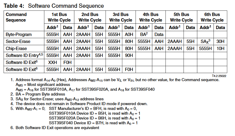

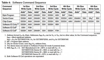

kernelthread wrote:
One more thing to consider is that, if you want to be able to program the flash device in situ under the control of the 6502, the 6502 must be able to control A0-A14, and A15 and A16 must either be both low or both high. This is because to initiate erase or program operations you need to perform a specific sequence of writes to the device satisfying those conditions.
Are you sure both A15 and A16 need to be at the same logic level?
kernelthread
Posts: 166
Joined: 23 Jun 2021
Re: B36502X Single Board Computer
Post by kernelthread »
kernelthread wrote:
Pin 30 is NC on the 010, so we can connect it to VDD.
You sure about that? As a fairly general rule, if the data sheet indicates a pin as a no-connect it should not be connected to anything.
I interpreted the "unconnected pins" designation as meaning they weren't connected rather than they shouldn't be connected. If it had said "do not connect", I would have interpreted it the other way. However, I'll concede I may have misinterpreted it and it doesn't cost anything to use a bridgeable link or do what Garth said and cut the pin off.
kernelthread
Posts: 166
Joined: 23 Jun 2021
Michael wrote:
That's how I interpreted this table:
It says "address lines AMS to A15 can be VIL or VIH, but no other level". Which is a very odd statement. I interpreted that as meaning they either have to be all low or all high. Although there are other possible interpretations. You could interpret it as "they all have to be either high or low, independently", but surely that is no constraint? Other than that they can't be left floating or connected to a voltage which doesn't represent a valid logic level, which I would have though goes without saying. The statement could also be interpreted as saying those pins have to be held at exactly VIL or VIH, but that makes even less sense.
From the fact you've used this chip before, I'm guessing you didn't have them at the same level while issuing command codes, and it still worked?

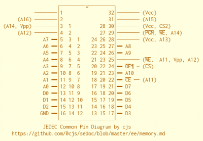

[The SST 39SFxxx series is] not pin compatible with the EEPROM, which makes it not a great solution for this kit where I want to encourage folks to use the hardware they already purchased for a breadboard build.
Is it not? At first glance it looks as if it is to me. Remember, when more pins are added, the pins on the right side "slide" so that the "bottom" pins (furthest from pin 0 and the highest pin) continue to match. This means that e.g. /OE should be pin 20 on a 24-pin device, pin 22 on a 28-pin device, and pin 24 on a 32-pin device. I drew up this diagram to help with matching the JEDEC pinouts for various device sizes (this is RAM/EEPROM, not EPROM):
                ────────│1                32│──────── (Vcc)
          (A16) ────────│2                31│──────── (A15)
     (A14, Vpp) ────────│3  1          28 30│──────── (Vcc, CS2)
          (A12) ────────│4  2          27 29│──────── (P̅G̅M̅, W̅E̅, A14)
                   A7 ━━│5  3  1    24 26 28│──────── (Vcc, A13)
                   A6 ━━│6  4  2    23 25 27│━━ A8
                   A5 ━━│7  5  3    22 24 26│━━ A9
                   A4 ━━│8  6  4    21 23 25│──────── (W̅E̅,  A11, Vpp, A12)
                   A3 ━━│9  7  5    20 22 24│━━ O̅E̅¶ ─ (C̅S̅)
                   A2 ━━│10 8  6    19 21 23│━━ A10
                   A1 ━━│11 9  7    18 20 22│━━ C̅E̅ ── (A11)
                   A0 ━━│12 10 8    17 19 21│━━ D7
                   D0 ━━│13 11 9    16 18 20│━━ D6
                   D1 ━━│14 12 10   15 17 19│━━ D5
                   D2 ━━│15 13 11   14 16 18│━━ D4
                  GND ━━│16 14 12   13 15 17│━━ D3
(In case that's not rendering well in your browser, I've attached below a screenshot taken in urxvt.)
There are definitely some pins that need jumpers based on device size (Vcc being the most obvious one), but if you need not support the old really small devices, I think this is relatively few.

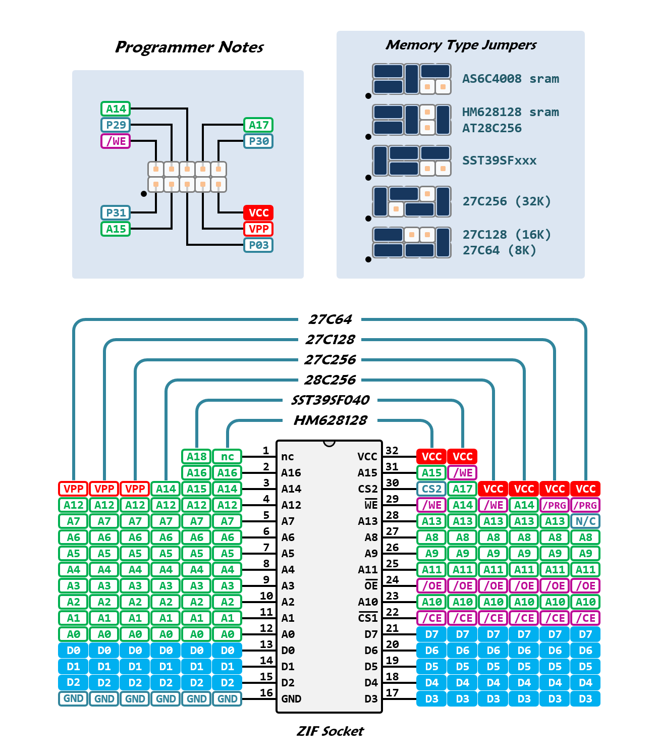

Individual_Solid wrote:
Here is a part I used in several designs that may help driving down your BOM cost. W27C512 EEPROM is an obsoleted part but can be easily acquired on eBay for about $1 each.
Yeah, that's using JEDEC ROM pinout instead of RAM/EEPROM pinout, IIRC, but even there there are not a lot of pins to change with jumpers or solder/cut pads.

Appreciate all the folks sharing schematics for making the ROM slot more configurable (And explaining the logic behind the JEDEC layout a little bit).

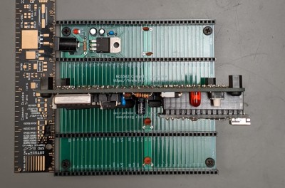

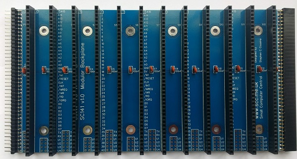

That's the "original" backplane? The [link url=https://rc2014.co.uk/backplanes/backplane-5/]Backplane-5[/link] from RC2014 official shop is much smaller, with pins on 13mm-ish centers.
Components between the headers is interesting. If I do smoosh this board down to 100x100 (dropping pin 40), I may give that a try.

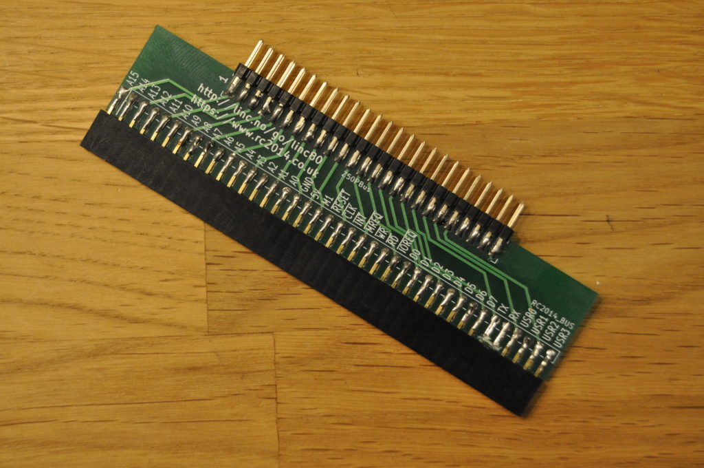

I'd also consider adding pads for a right-angle header right at the edge of the board so it could plug into a stand-alone backplane, like the SBC does.
The boards (SC SBC and RC2014 Mini) both use Right Angle headers to pass through to a standalone backplane. I do see photos of z50 Bus devices that have larger pads with a straight header soldered directly on. hmm.

kernelthread wrote:
Michael wrote:
Yes, it works. A15 and A16 do not need to be at the same level...

For what it's worth, the "standard" RC6502 backplane board is 24 mm centre-to-centre.
That's the "original" backplane? The Backplane-5[/link] from RC2014 official shop is much smaller, with pins on 13mm-ish centers.
Right. You've linked the original RC2014 backplane; I was talking about the original RC6502 backplane, which is what you're trying to be compatible with. Though honestly, I'm guessing that making your spacing a bit smaller is not likely to be a huge issue. FWIW, my RC6502 memory board has a ZIF socket on it that when loaded needs 18 mm of clearance above the board. (The socket's handle sticks up over the top so it will clear another 10 cm board in the next slot.)
Right. In case I wasn't clear, I was talking about doing this on your SBC. (In the current designs you've shown, the pads closest to the edge don't look close enough for the standard RC2014 connector, at least to my eyes.) This is what I was talking about:

I'll admit that hardware compatibility with the RC2014 backplane families is more interesting to me (than compatibility with any particular RC6502 design), given that there are more designs available for purchase today.
Ah yes, I keep shuffling these things apart. I wanted to bring attention to this style, which I might choose to adopt
saving the need for a RA header.
