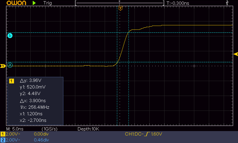

Cool thanks!
When you say 10% to 90%, do you mean 0.5v to 4.5v in this case? Just to get a better understanding on standard terms.

So more like this?

So more like this?
Yes.
