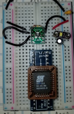

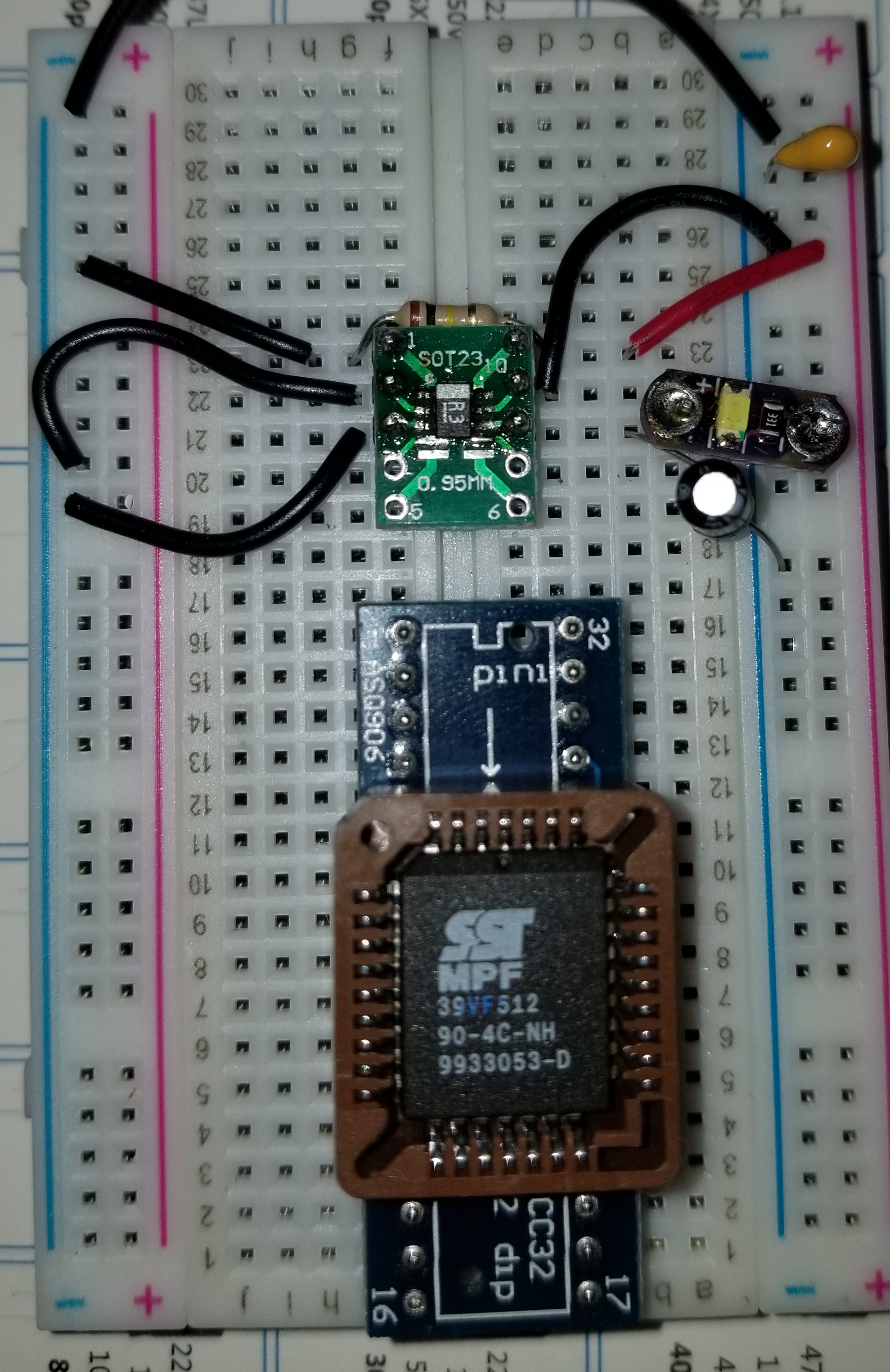

Only a small update:
I pulled a SST 39VF512 90ns Flash ROM from an old NVIDIA graphics card and tested it out, works great! Whipped up a 3.3v circuit for it using a TOKO TK11432M regulator. Puts out a steady 3.21V. Haven't hooked it up yet but this should give me a slight edge over my AT28c256 and has more room for future projects. Now, with a 3.3v source I can easily implement any other 3.3v elements into my project if need be.

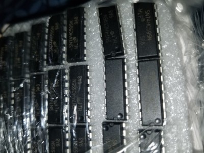

This keyboard definitely works. However, my project is broken somewhere. I am using 2 74HC595's to take in the 11 bits of data from the keyboard but they aren't putting anything out. I'm going to look over the datasheet but everything appears to be connected correctly. I was using some Chinese knockoff 595s and swapped them for 2 TI that I had in a 'logic beginners' kit but same thing. All outputs sit at 5V. If I can't figure it out and whip myself into a homicidal rage I'll resort to pestering everyone here for help but half the fun (if that's what one calls it) is solving the problems yourself.

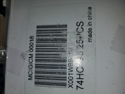

Ok, I wasn't sure how to structure this. I figured keeping the build 'adventure' in one thread would keep from littering the other sections with noobish spam but whatever you suggest. Also, in this context, this is chinese knockoffs, it says so on the package
(not sure why the pictures are sideways

Those look to me to be counterfeits. The SN prefix on the part number is a TI thing. Whomever made/remarked these chips were likely trying to fool the buyer into thinking they were getting TI product.
Re: Saying Hi/ My build
I'm fine with it as long as they work! And as far as counterfeits go, these look pretty good and have pretty good quality pins unlike most that break when you look at them. What's even more confusing is that I tried to 'verify' them in my TL866II+ that supposedly can test logic chips, it said the 10 I tested were all bad. But then I tested the two TI 595's I have and it said those were bad too
