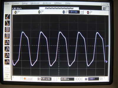

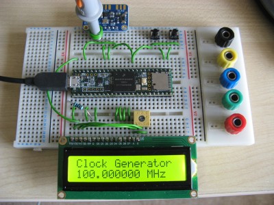

We've been using the Si5351A for a few days now as a flexible clock source for Beeb816.
It's actually been working quite well.
Here are a few snaps.
It's currently just sitting on a breadboard being driven by a spare Teensy:
This is the code that's running on the Teensy:
https://github.com/hoglet67/si5351stand ... dalone.ino
You can set the frequency using the push buttons (in 100KHz steps) or by sending a number over the USB serial port.
Here's the output at 32MHz:
And at 100MHz:
The jitter is about +/- 100ps, and this doesn't seem to vary much as the frequency changes.
You can also seem to be able to change the frequency without the clock glitching.
The edge time is ~1ns when the drive is configured to the maximum of 8mA.
