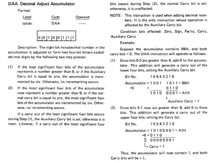

Re: Simulating an 8080. Is there a better way to do this?
Posted: Sun Mar 28, 2021 5:48 am
by BillG
In the meantime, I worked on the daa instruction, decimal adjust accumulator. This is probably the most complicated instruction on the 8080.
The programming manual for the 6800 provides the most detailed explanation I have seen:
This is the code:

I am sure it can be improved. The first thing to try is to build the adjustment byte from the carry and aux carry flags, then use the adc instruction in decimal mode to do the rest.
This is part of a program to test it:

Posted: Sun Mar 28, 2021 2:21 pm
by BB8
here an 8080 Manual.
At page 15:
Daa:
'low nibble
	fAdd := false
	if AuxCarry = 1
		fAdd := true
	elseif lownibble > 9
		fAdd := true
	endif
	if fAdd
		value := value + 6
		set Carry flag if overflowed the 8th bit   ; <-- this is my guess
	endif
	set AuxCarry accordingly
'high nibble
	fAdd := false
	if Carry == 1
		fAdd := true
	elseif highnibble > 9
		fAdd := true
	endif
	if fAdd
		value := value + 60
	end if
Set other flags accordingly to result
So: [not sure if correct]
- adjust +6 if lowernibble is > 9, or if AC was set
- adjust +60 if highernibble > 9, or if carry was set, or if carry gets set by lower nibble adjustment
- set AC to 1 if the adjustment set it, 0 otherwise
- set Carry to 1 if adjustment set it, leave unmodified otherwise
- set other flags based on the result
Posted: Mon Mar 29, 2021 1:29 am
by BillG
BB8 wrote:
Thanks for reminding me of that.
Generally, I prefer the Intel 8080 Microcomputer Users Manual of 1975 as my reference on the 8080.
Next is either the Intel 8080-8085 Assembly Language Programming manual of 1977 or the Osborne book 8080a/8085 Assembly Language Programming.
