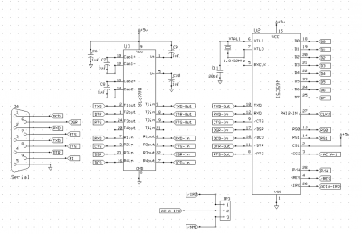

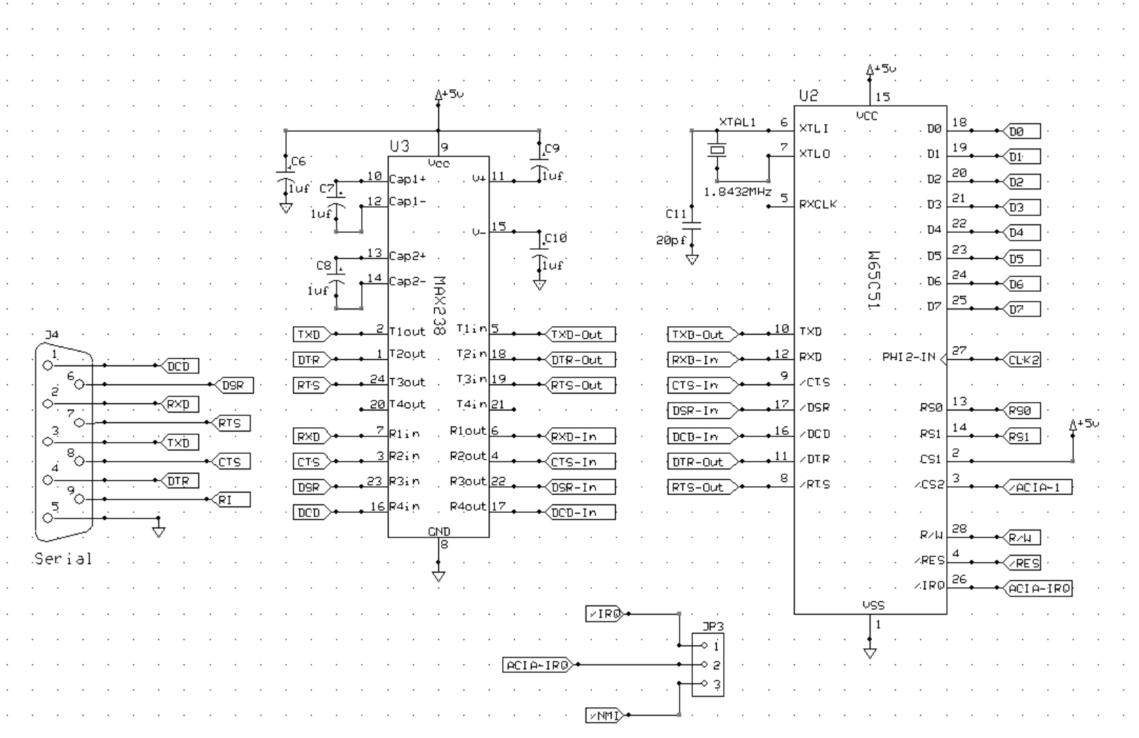

Here's the schematic for the serial part of the I/O board I made back in 2013. I used a MAX238 with a 65C51. It works perfectly fine.... I later swapped the MAX238 and the DB-9 connector out for a FTDI UART to USB adapter.
After I discovered the Xmit bug with the recently released W65C51 chips, I switched to a NXP SCC2691. My next board will be using a NXP 28L92... more involved to get the NXP UARTs working, but once you do, they're a much better solution.

In POC V1.2, I used Kemet part number C315C105K3R5TA MLCCs in place of tantalums for the MAX238. They are less expensive than the tantalums and, of course, aren't polarized. The package size is the same.

I liked using the tantalums for the MAX's charge pump capacitors, but installing them was always a struggle for me, as it's hard to distinguish polarity on them. So when I was designing POC V1.2 I decided to try out MLCCs.

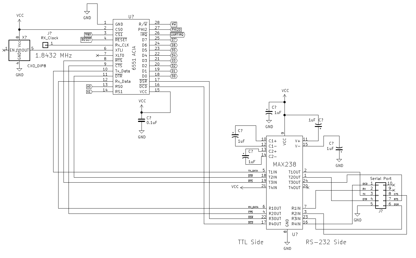

OK, I've updated my design to use the MAX238.
I was a little confused on how those caps worked (charge pumps??). So I hope I got that section right.
Thanks to everyone!
Thanks to everyone!

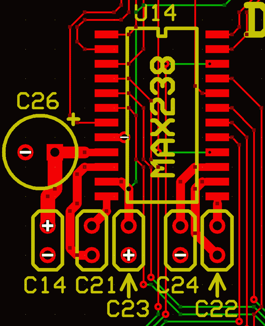

Looks okay to me. Please see my earlier post about using MLCCs as charge pump and bypass capacitors—you can save a few pennies on the build cost and avoid having to worry about polarity. Also, it would be a good idea to place an electrolytic close by the MAX238 to help stabilize Vcc. I use 100 µF for that purpose, Panasonic part number EEU-FR1A101B.
Four of the capacitors are part of the charge pump circuit, which takes the nominal 5 volt Vcc source and produces approximately +10 and -10 volts to drive the TIA-232 outputs. The fifth capacitor is just a usual bypass capacitor. All capacitors should be as physically close to the MAX238 as possible. If you are doing this on a PCB you can place the four charge pump caps (C21-C24 in the attached illustration—C14 is the bypass cap) at the "south" end of the MAX238, which will make for short traces. The MAX238s (two of them) in POC V1.2 are in SOIC-24 packages, which don't take up a lot of space and may be manually soldered—at least by someone with vision in both eyes. :D
MAX238 PCB Layout (from POC V1.2)
It's very good timing I can across this thread. I've finalised all areas of my (very basic) SBC circuit design except the serial comms (65C51). I've spent the last 2 days reading up on which way to go: 65C51 with xmit bug workaround or a modern chip 28L91/2. Given this is my first build and it's all DIP package chips, I've decided to go with the 65C51.
Reading Floobydust post, I would like to do this also - have the 65C51 connect to a "FTDI UART to USB adapter", i.e. connect my SBC to my desktop via USB for serial comms.
Are the pins between the 65C51 and "FTDI UART to USB adapter" straight forward to connect? E.g. RTS to RTS, CTS to CTS, Rx to Rx, TX to TX? And ignore DSR... and such? And anything else to connect between them?
Also any recommendations on a particular "FTDI UART to USB adapter" to buy or are they all good?

Re: My RS-232 / 6551 Design
Post by floobydust »
There are several different UART to USB interfaces from FTDI. The one I've mainly used on my SBCs is this:
DS_DB9-USB-15654.pdf
(605.73 KiB) Downloaded 54 times
They offer both male and female versions in interface levels of 3.3V, 5V (TTL type) as well as RS-232 voltage levels. As I'm connecting directly to the UART, I just use the 5V version in MALE... and use a standard DB-9 (also male) connector for the PCB layout.
I've also used their LC234X, which is a small PCB you solder a header on... this one has a jumper for 3.3V or 5V.
Just refer to the doc file for connection. They have drivers for OSX, Windows and Linux.
Regarding the 65C51... if you don't plan on running a fast CPU clock, I'd suggest finding an older CMOS version from Rockwell... as these were available in 4MHz. This will work out better overall... but I still recommend using a NXP UART these days.
