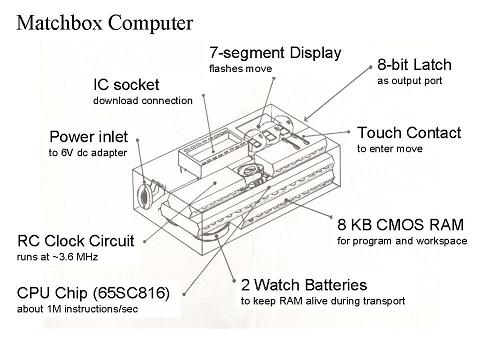

I can't resist mentioning H G Muller's 'matchbox' chess computer, battery powered, '816 based, no ROM, fits in a matchbox and plays chess:
It looks pretty minimal. I think the program is downloaded into RAM using a ROM in the socket, then retained on battery power.

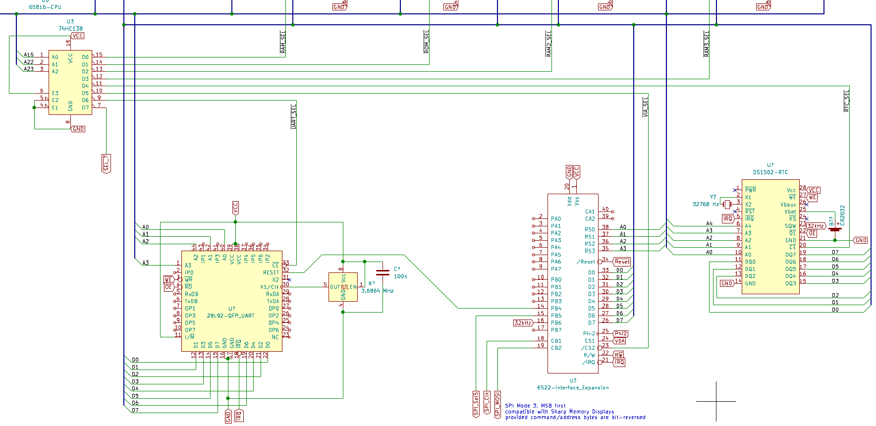

While sketching out the details, I found that the 28L92 has an active-high reset line, opposite to anything else in the system. As a workaround without using any extra chips, I'm wiring it up to an output on the VIA.
Meanwhile, the VIA also serves as a Mode 3 SPI master, which can be used to drive a write-only display such as the Sharp Memory LCD. It should also be straightforward to attach a keymatrix to the VIA, allowing for local input and display rather than always going through the UART.

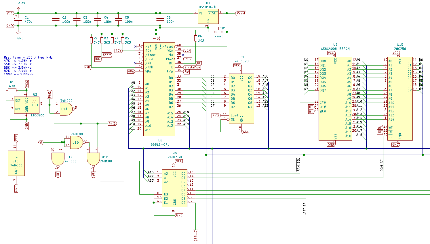

Okay, here's what I've worked out thus far. First, the basic core:
Then the peripheral devices; you can probably start with just the VIA, and add the others around it. I've left most of the external connections to the VIA and UART as exercises for the reader:

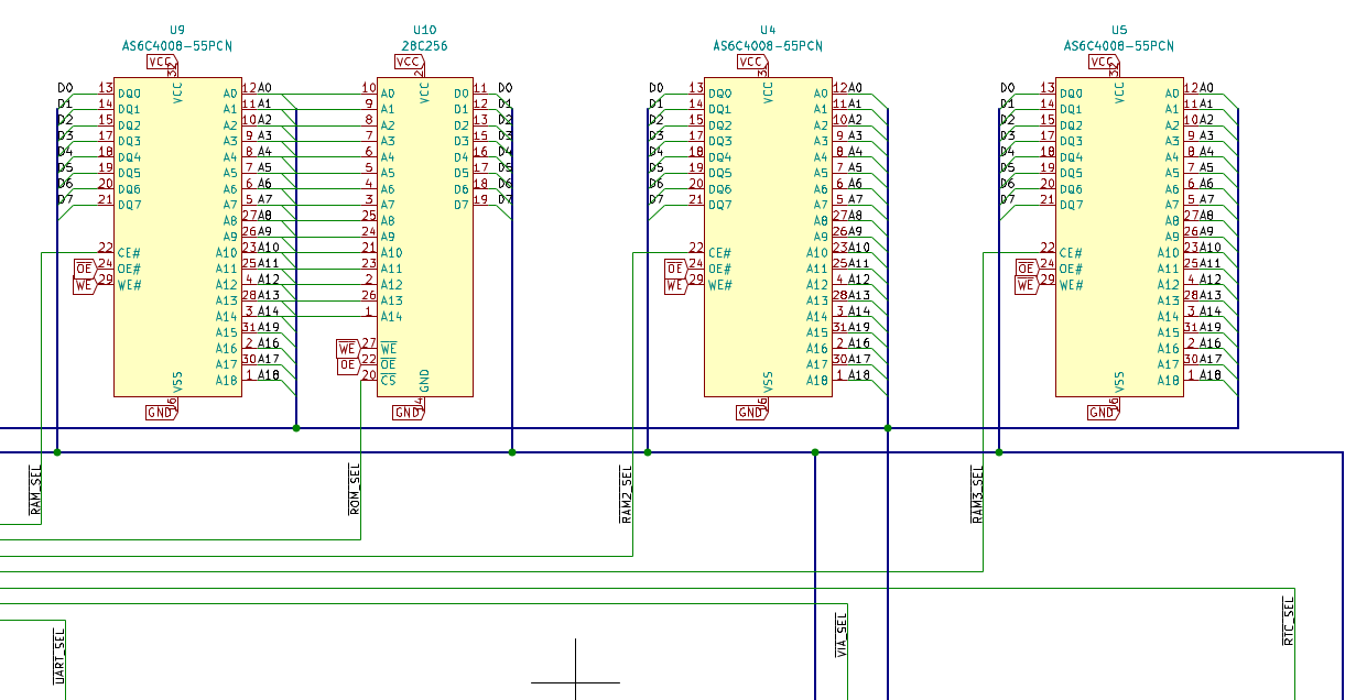

And finally, the extra memory chips to give a 1MB contiguous RAM area:
All of this relies on just two 74HC-series chips for glue logic, and one more as a bank address latch.

Okay, here's what I've worked out thus far. First, the basic core...All of this relies on just two 74HC-series chips for glue logic, and one more as a bank address latch.
74HC likely won't be fast enough for latching the bank logic.
Chromatix
Joined: 21 May 2018
Re: Sketches please: a fewest-chips logic-only 816 system
Post by Chromatix »
You my notice that the positive Phi2 (to the CPU) is actually delayed by one 74HC gate relative to the inverted /Phi2 sent to the latch, rather than the other way round. So as long as the clock speed is modest (as it has to be anyway with a slow EEPROM and no wait-states), 74HC *is* fast enough.

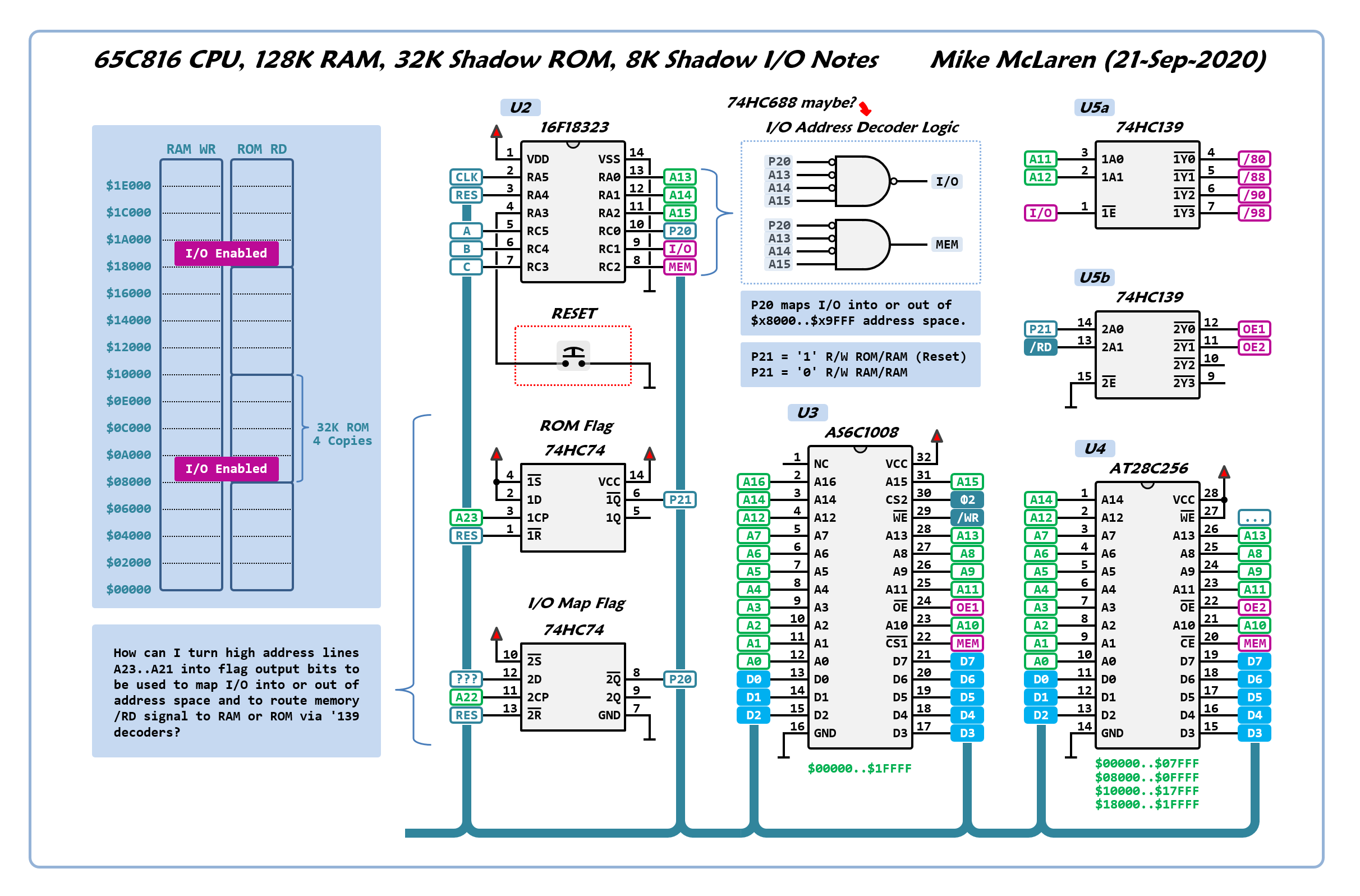

I have an idea though several details are yet to be worked out. How about using simple I/O address decode logic and selecting both RAM and ROM for memory operations but directing the /RD signal to only one or the other? The idea here is that a switch is set at power-up (reset) to select ROM 'read' and RAM 'write' in order to copy a ROM image into RAM, then the switch is toggled to select RAM 'read' and RAM 'write' effectively mapping ROM out of the address space. With the simple address decoding in the example drawing below, there will be four 32K ROM images spanning the 128K address space when ROM 'read' is enabled.
Another switch might be used to map an I/O block into or out of the address space. Again, the simple address decoding would place the I/O block into each 64K 'bank' but when the I/O block is turned off you have contiguous RAM memory. The example below should scale up to a 256K or 512K RAM chip, as well as a larger ROM or FLASH chip.
I'm not familiar with 65C816 and what it takes to qualify RAM 'read' or 'write' operations. I'm also not exactly sure how to take advantage of the high order address lines (A21..A23) as potential triggers or inputs for the <Read> and <I/O> switches.

At the basic level, you can interface the '816 like a 6502, relying on just Phi2 and R/W as control signals. The wrinkles are that A16-23 (the bank address) are multiplexed onto D0-7, so you have to latch them during Phi1 in order to make use of them during Phi2, and that VDA and VPA indicate Valid Data Address and Valid Program Address respectively; if both are high simultaneously, that's a replacement for the SYNC signal. In short, if VDA and VPA are both low then it is desirable to deselect all devices, as it's an internal-operation cycle. Finally, if RDY is low (typically due to wait states) then the bank address must not be latched because the data bus remains in data mode.
All of this is handled appropriately by the circuits I've posted, which you may want to review. With two glue-logic chips and an octal latch, you can have a minimal interface and address decoding which assumes that there are no wait-states (and does not provide any), and does not fully handle VDA and VPA (so every memory cycle is assumed to be valid, except that the VIA is qualified by VDA). With four glue-logic chips and an octal latch, you can have full handling of VDA, VPA and RDY, together with a trick that maps out the ROM when the CPU leaves Emulation mode for Native mode (using the fact that the '816 conveniently presents the E, M and X flag bits on output pins).
