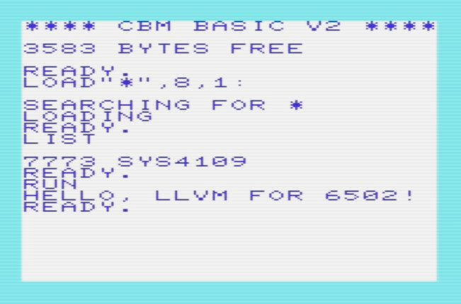

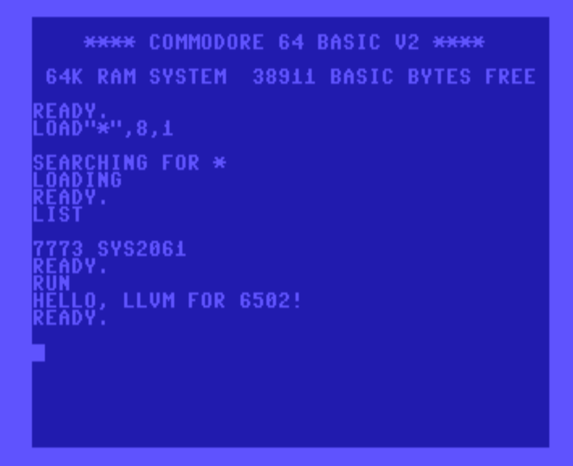

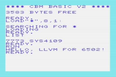

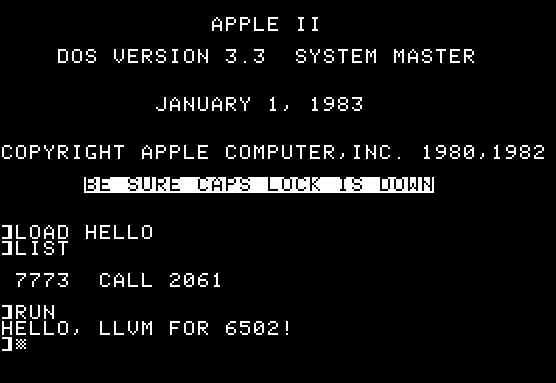

Lest that any of you think that this is purely an academic competition, let me quietly tease some screenshots of my current work.
Note the line number 7773, which is my attempt at a l33t spelling of LLVM.
Hello, LLVM for 6502 for Apple II
Hello, LLVM for 6502 for VIC 20
Hello, LLVM for 6502 for C64
