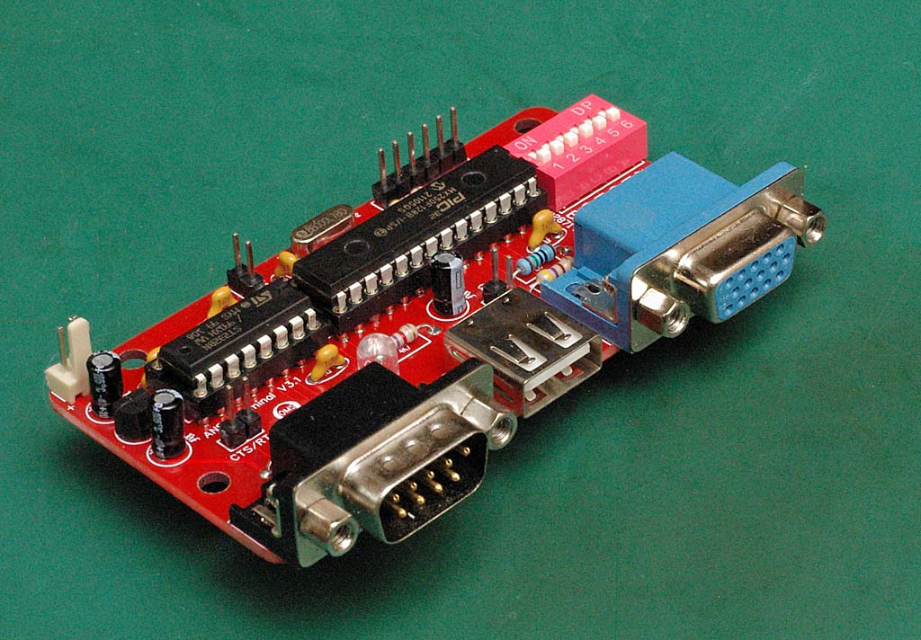

I eventually got around to developing my own variant of this board.
The design criteria was to have something that could attach to the back of an LCD (or other) monitor and take it's power from the monitor. I initially started out with a PS/2 keyboard, but they are getting harder to find. My initial attempts also just had TTL serial levels. You can read about the process here (warning - non-6502 site!): https://altairclone.com/forum/viewtopic.php?f=5&t=333
This final version has a RS232 driver chip, will accept a USB keyboard and color and baud rate are DIP switch selectable. The overall area of this is just about the same as the original.
Michael
Posts: 633
Joined: 13 Feb 2013
Re: VT-100 CONSOLE FOR HOMEBREW COMPUTERS
Post by Michael »
That looks beautiful, Bill. Nice layout...
