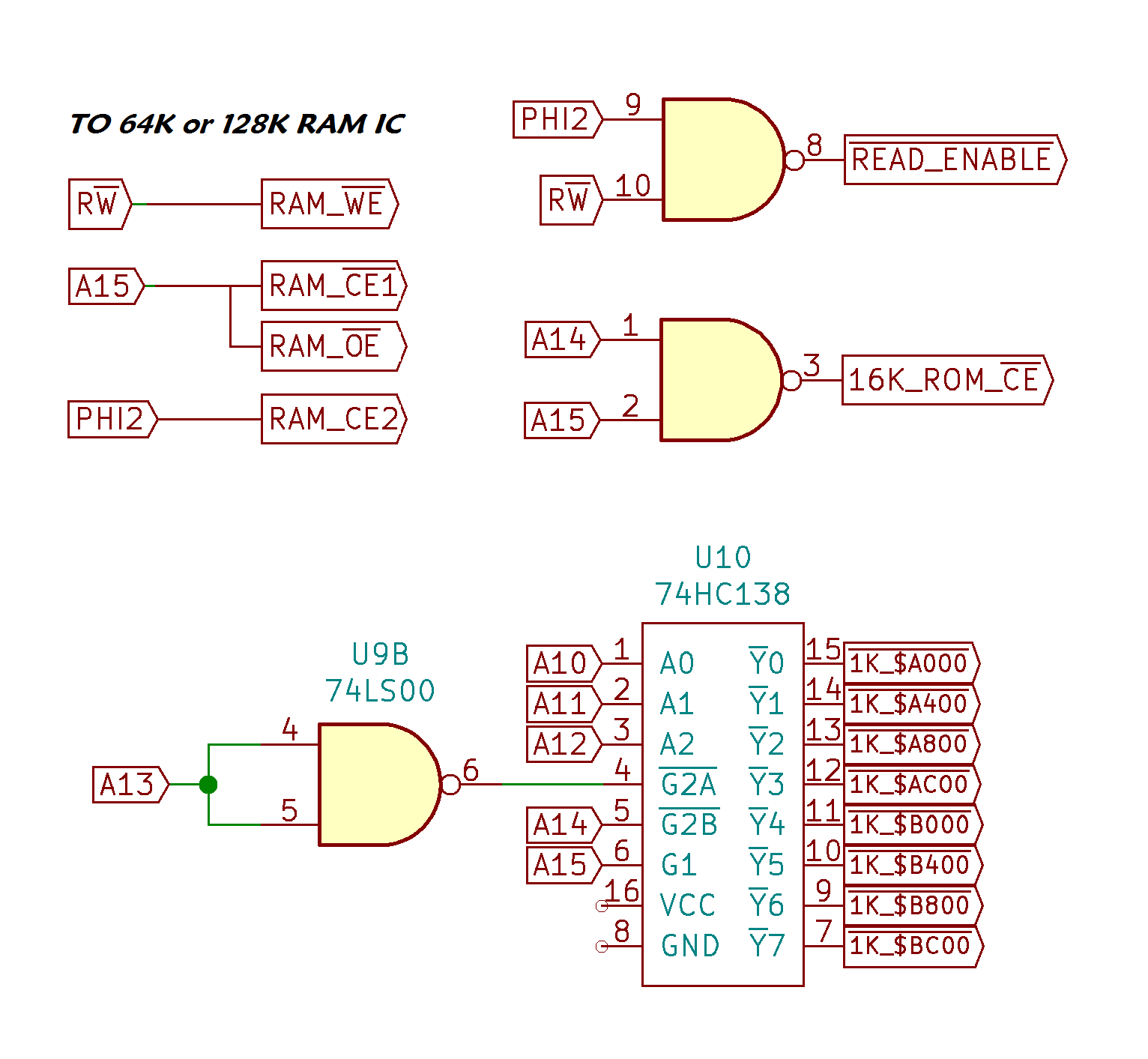

Earlier I mentioned using a 64K or 128K RAM IC which might eliminate one IC in your decoder logic. Not sure you need to qualify the ROM read_enable signal with PHI2...
