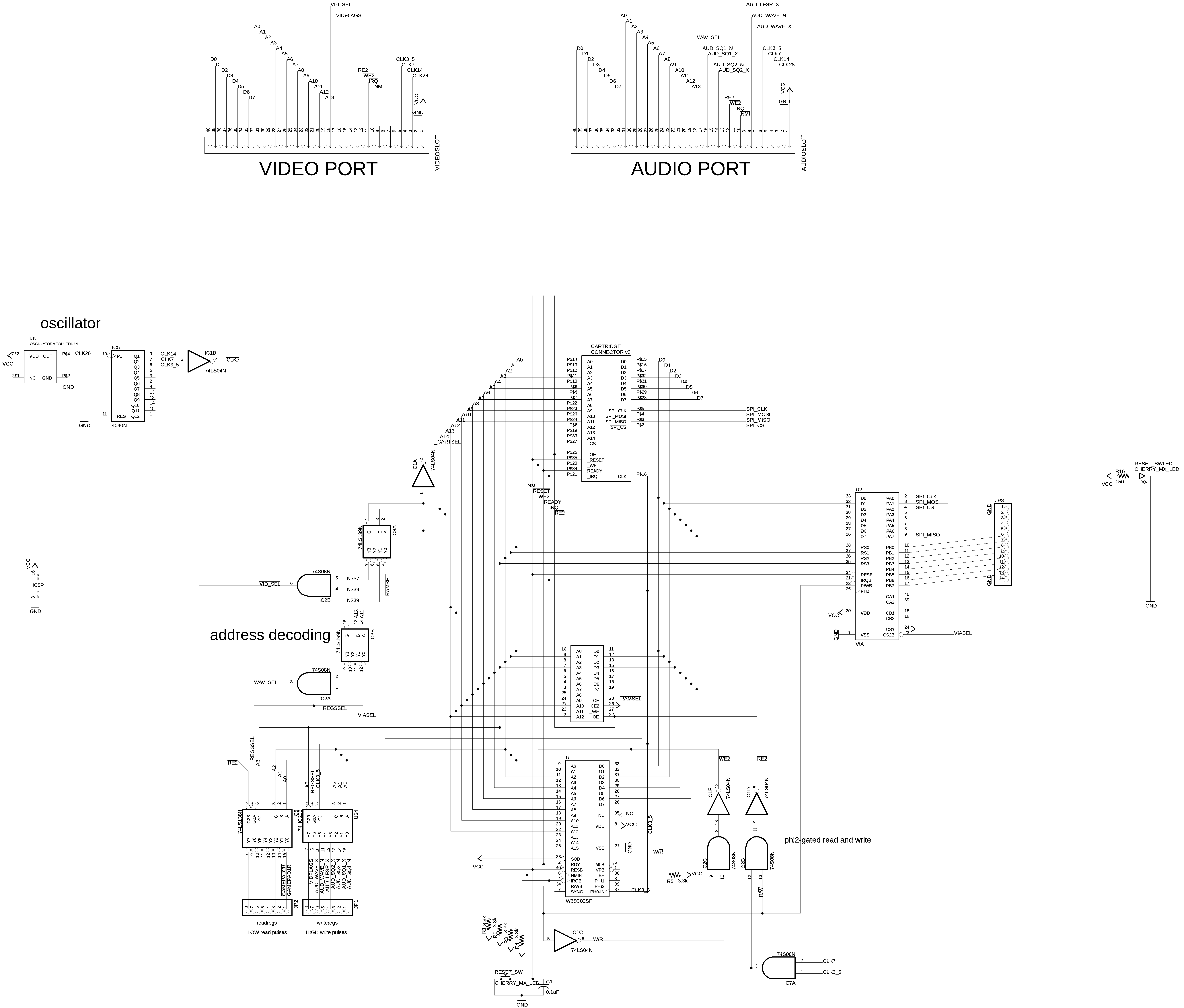

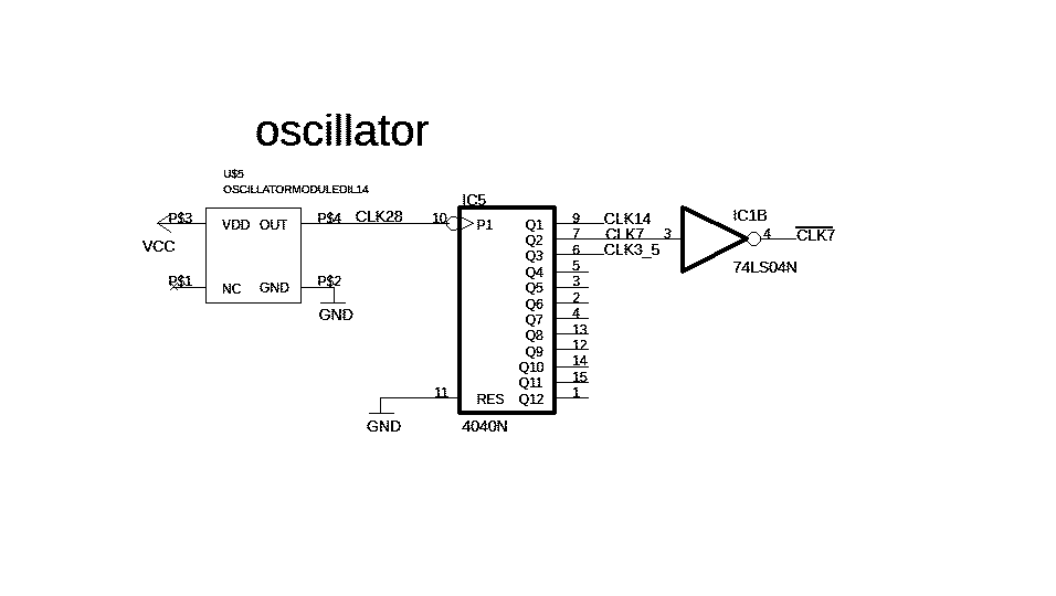

As for the clocking question, am I right in assuming your 7 MHz clock is divided by 2 to produce the 3.5 Mhz which the CPU uses? And (correct me if I'm wrong) you wanna generate a similar 3.5 Mhz signal, but one that has only 25% duty cycle -- low for the first 75% then high, or is it vice versa... If you share the circuit you're presently using then we can suggest alternatives if you're interested.
That'd be great! I actually have a 28.somethingMHz oscillator module that gets divided into 14, 7, and 3.5MHz clocks by a 74HC4040. So each clock ticks on the *low-going* transition of the next higher division. Initially I just gated !RWB with Phi2 to generate a write-enable, but later found that cutting it to only the first half gave me more timing leeway on level-sensitive logic.
The schematics attached are for the motherboard, with two of the images being clipped to the relevant clocking and gating sections to read it easier.
EDIT: Also all the 74xx chips on this board are actually 74HC, the ones that say S or LS are because the Eagle builtin library didn't have HC and I'm a little bit lazy.

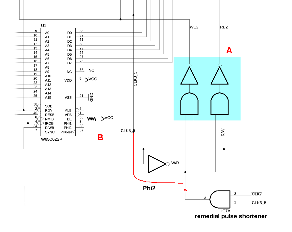

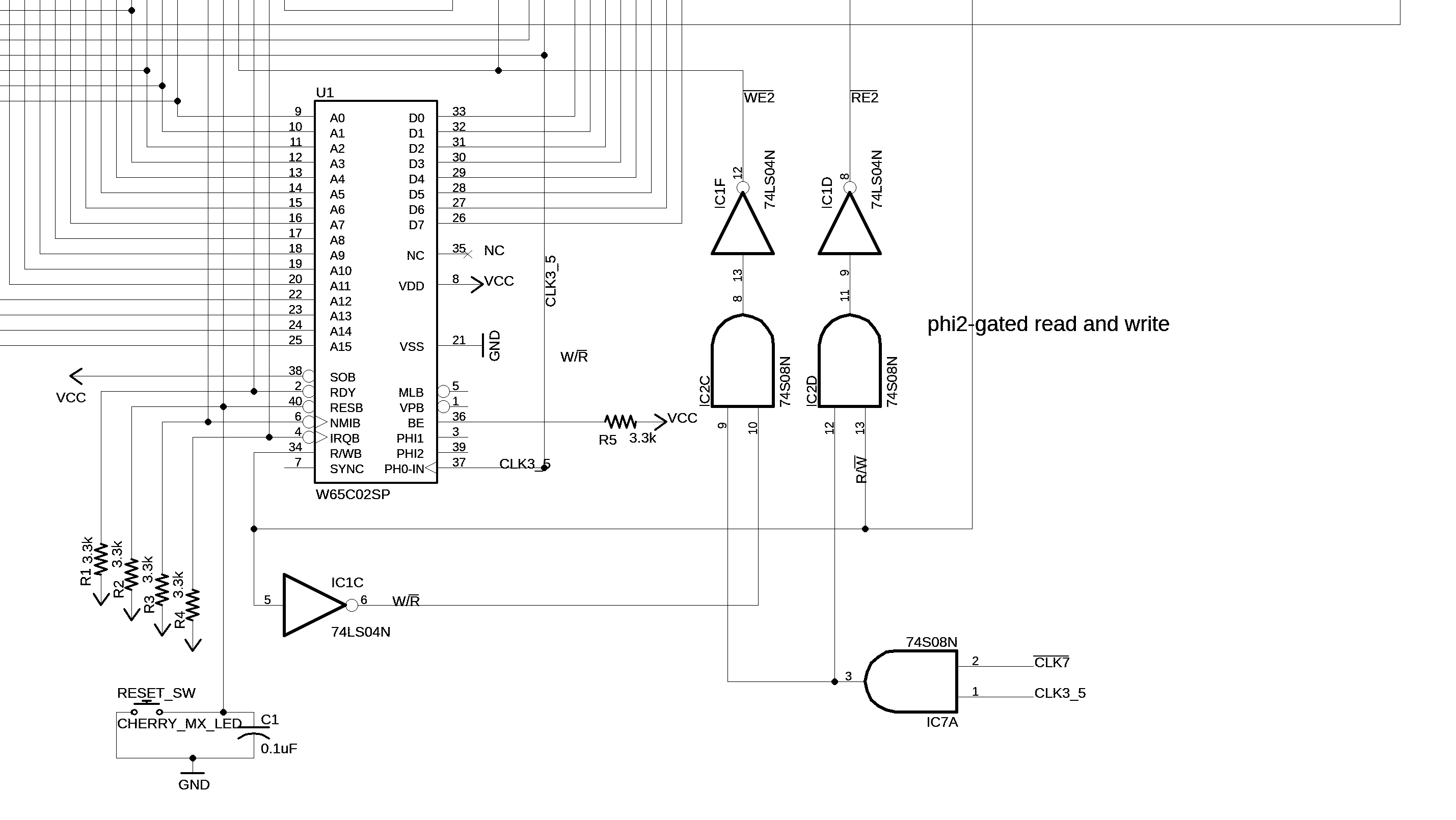

Alright, I have a few questions and suggestions. I'll begin with one that's fairly minor. Would it be acceptable to replace the oscillator with one that's half the frequency -- IOW, go from 28 Mhz (approx) to 14 MHz? That'd mean your CLK14 signal would be taken from the oscillator, not from one of the 'HC4040 counter outputs.
What is driven by CLK14? It would end up with the same duty cycle as the osc. -- ie, roughly 50:50 but not necessarily exactly 50:50. Do you know if that would matter? As you may've guessed, I'd like to replace the 'HC4040 divider circuit. Some sort of synchronous divider will be more appropriate than using a 4040 ripple counter, whose outputs don't change in unison. And, more options become available if the new divider doesn't have to supply CVLK14, only CLK7 and CLK3.5.
Okay, there are various ways of shortening write-enable so it only occupies the first half of the Phi2-high period. But shortening write-enable may not be necessary if you can instead find a way to shift its phase somewhat so the trailing edge happens a tad sooner, relative to CLK3.5 aka Phi2. Here are some options for that:
At "A" you could reduce the propagation delay substantially by replacing each AND-plus-Inverter with a NAND. And/or you could use AHC series parts here instead of HC -- this is something you could easily test, as the chips are socketed.
Another way to delay the phase somewhat is to break the circuit at "B" and insert two inverters or a single non-inverting gate such as AND or OR. And (although I didn't show this) it's not only the CPU that'd get the delayed phase; the VIA would, too, and really everything using Clk3.5 except the tinted area at A.
BTW, no matter how you derive the Phi2 sent to the CPU, it's best to have abrupt rise/fall times there. It's far from ideal that you're presently using an HC series device (the 4040) to drive the CPU's Phi2 input... and also driving the VIA Phi2 input and some other stuff! :shock:
An AC series device would do a far better job of driving all that, but a few simple caveats apply when using AC. If you prefer to stick with HC -- not really recommended, but you have, after all, gotten things working! :) -- then I suggest you dedicate one HC output whose only job is to drive the CPU -- nothing else. Probably the VIA could also benefit from this treatment for its Phi2 input. In both cases Phi2 is interpreted with significance attached to rising/falling edges. In contrast, abrupt rise/fall times aren't as important for those logic inputs which are merely level sensitive.

Thanks for the analysis!
The 28Mhz clock actually gets used by the video board for generating colorburst phases, and by the blitter for shortening its own write pulse.
The 14MHz signal is also used by the blitter as its pixel copy clock, and by the audio board to clock its own 6502.
The blitter assumes that an incoming write pulse to its "start" register coincides with the falling edge of its own clock, and lasts for a full 14MHz cycle.
However, it sounds like switching the divider to a synchronous counter would still serve these clocking needs and make these assumptions valid. Replacing it with an AC part also seems like a good idea. Maybe a 74AC163, and pass the oscillator's output through a 74AC04 to maintain the expected phase relationship. This could even be implemented before the next full motherboard respin, if I build it on a board that sits in the 4040's socket.

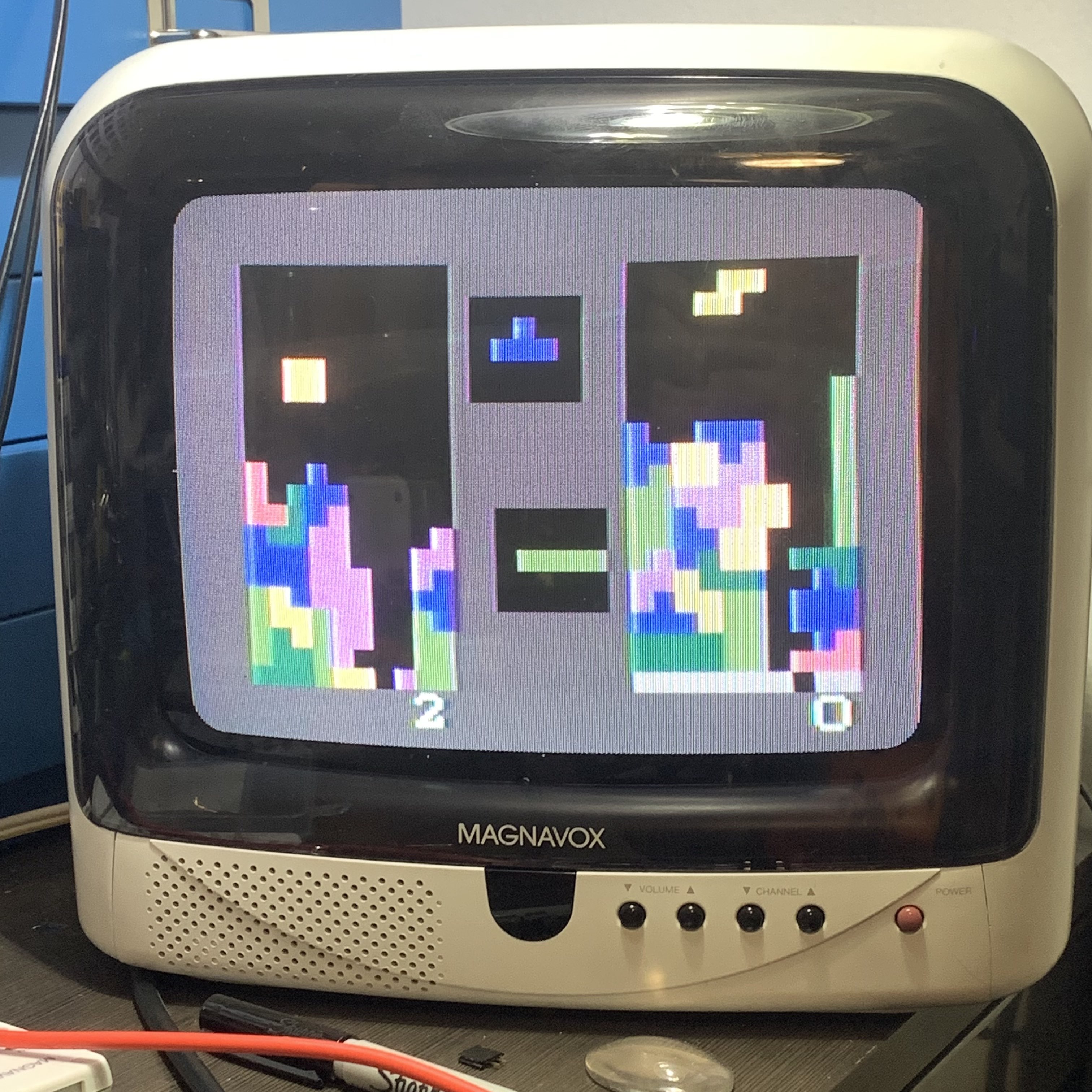

Well, I had to slow the blitter down to 3.5MHz instead of 7MHz but it is finally drawing the correct number of pixels every time. The delay from the 74HC40103 was just a hair too slow to run at 7MHz, but I might be able to get it working at that speed by delaying a certain clock phase. I'm satisfied with the result enough to call that a "wishlist" item rather than mandatory for moving on towards the "form factor" version. (i.e. the one actually shaped like a game console)
Screenshot attached to show the blitter working its magic for my Tetris clone, drawing the pieces and interface mostly with colored rectangles but also using a font stored in G.RAM to print the score.

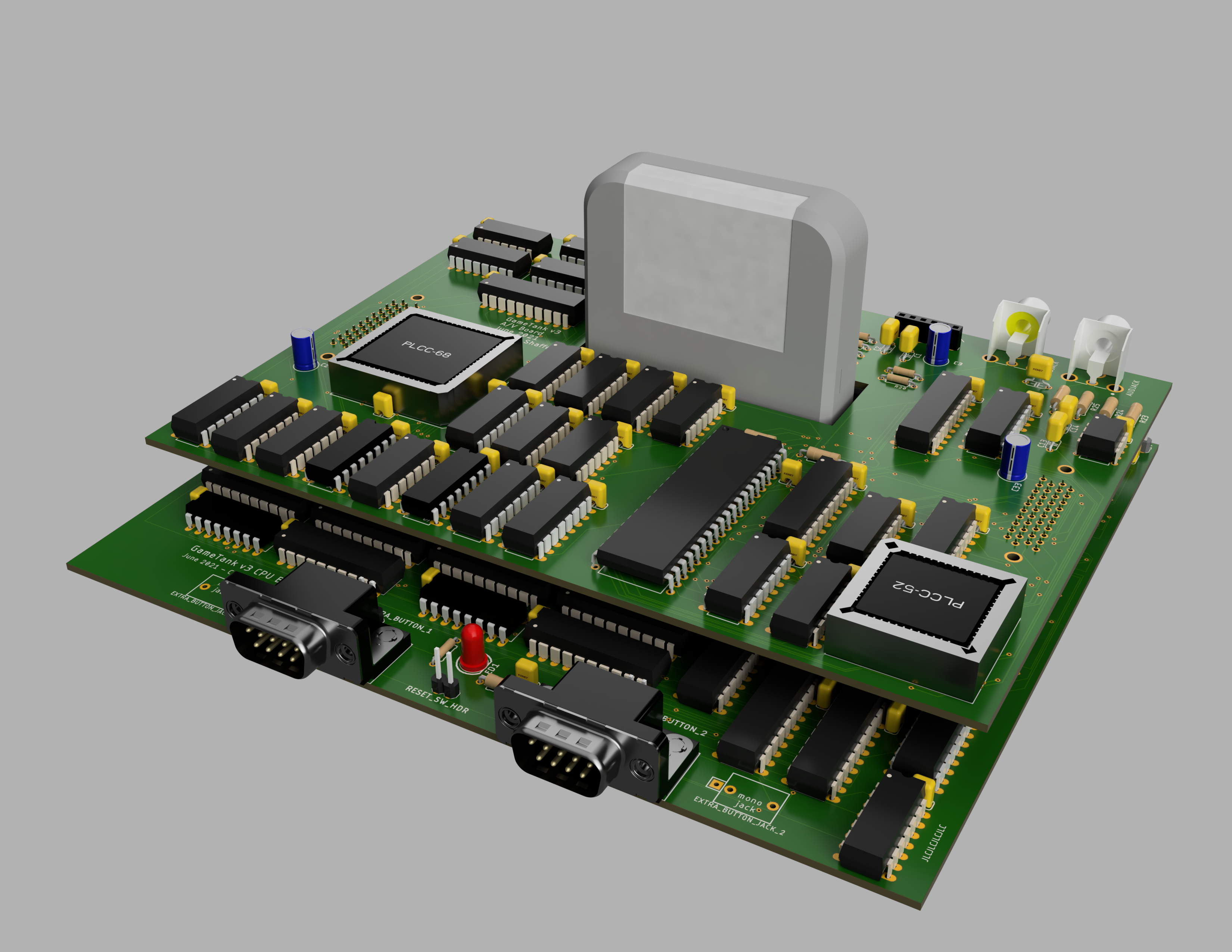

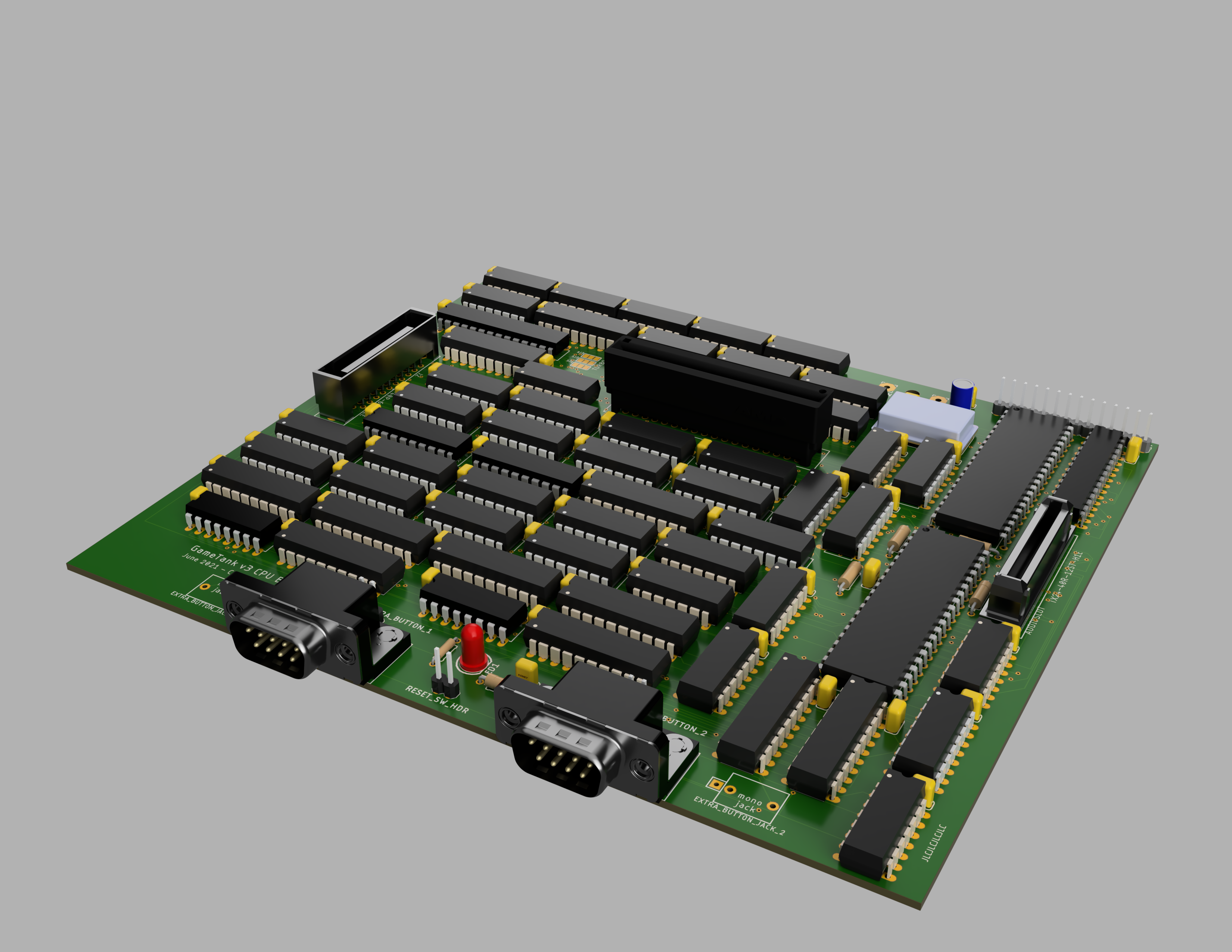

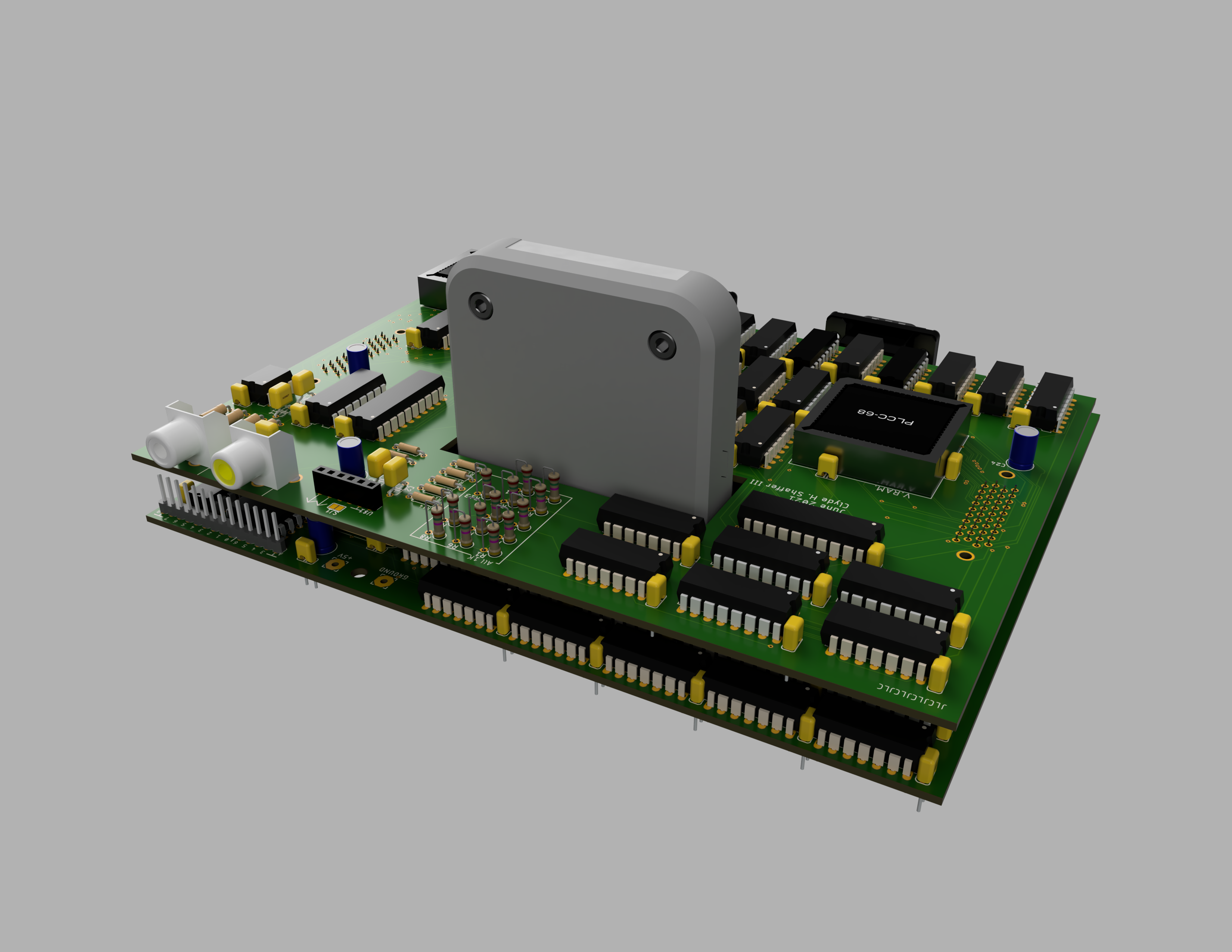

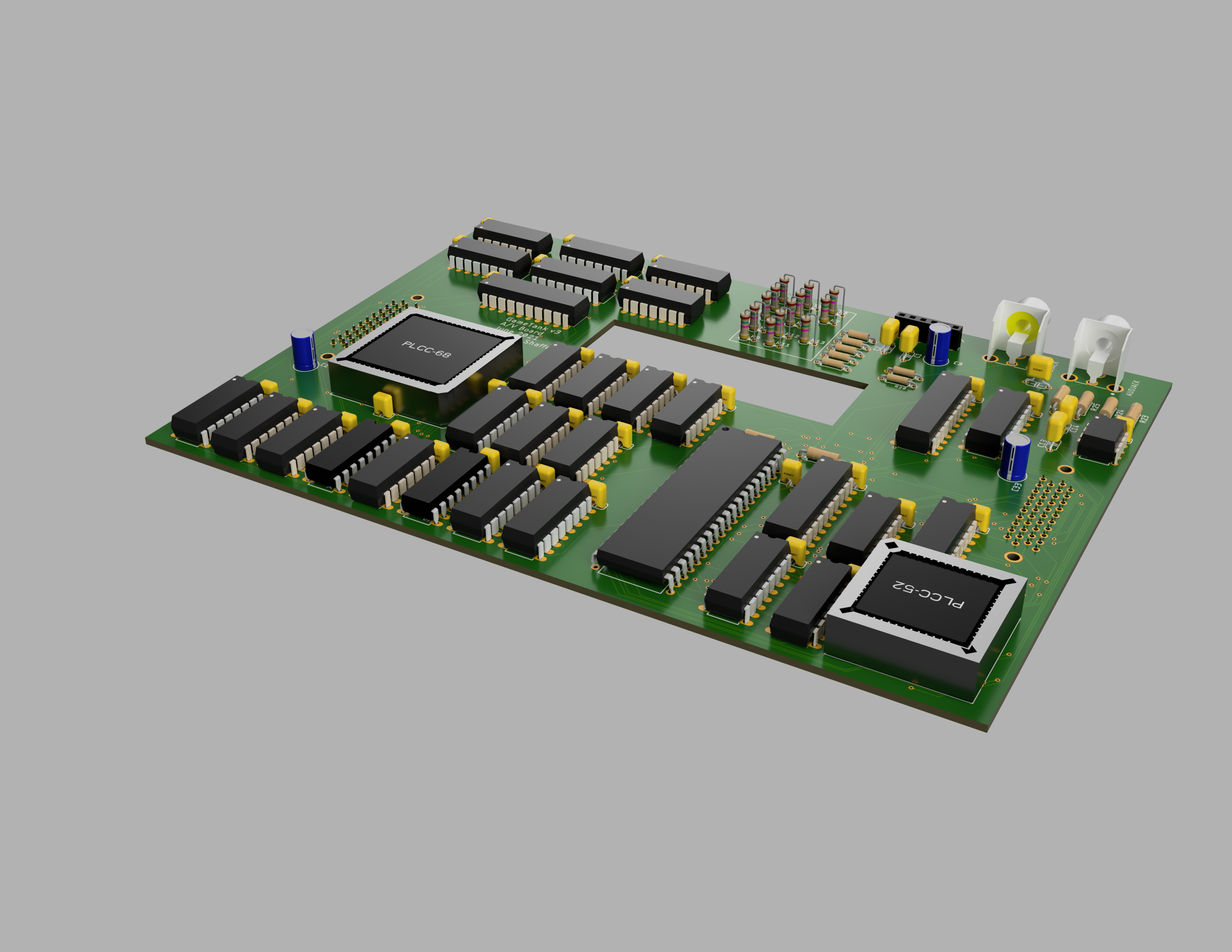

I got excited after getting the blitter working, so I sat down and combined the four board designs of the V2 prototype into a surprisingly compact two-board stack. Combined PCB footprint is 7"x6" and hardly an inch and a half high.
The bottom board combines the blitter, address decoding, CPU, input ports, cartridge port, and VIA.
The top board holds the composite video circuit on one side and the audio coprocessor on the other. So I call it the "Signals Board".
The Signals Board has a hole in the middle to accommodate the cartridge, which site on the bottom board for structural stability.
The keyboard switches used for Reset and two extra input buttons have been replaced with headers, to connect to case-mounted switches.
I've also left a footprint open in case I wanted to use a 3.5mm mono jack for the extra input buttons. This would, for instance, support connecting to certain exercise bikes. I think that would be kind of hilarious.
In the corner near the RCA connectors, I put a header that exposes twelve otherwise-unused VIA pins. Besides eventual expansion hardware, this is handy for debugging and profiling
I haven't actually tested out the tweak that would bring the blitter speed back up to 7MHz, but instead included it on the new board with a trio of solder jumpers that would either enact the 7MHz fix or simply route the 3.5MHz version that would still be sufficient for games.
I've also elected on this version to remove the existing linear regulator and instead leave a place to solder in a power module that I'll design later. This could either stick out the back a little, or go underneath the lower board.
Initial testing could be easily done with a bench power supply, or I could just solder in a barrel connector and use a wall wart that already outputs 5V.
The reason I switched from the regulator is mainly that it got very hot, even with a heat sink attached. I'd like to switch to a switched regulator instead, but still have some reading ahead of me to comfortably understand how to use one in a design.
So that I could start designing the case, and also have something to post on my website, I exported the boards to Fusion360 and created a fairly detailed rendering. (After a couple hours' worth tracking down STEP models for certain components!)
barrym95838
Posts: 2056
Joined: 30 Jun 2013
Re: Game console prototype "GameTank"
Post by barrym95838 »
That's a very handsome kit! Nicely done.
Wow! How many layers did you need in the board in the second picture to get it all routed?
