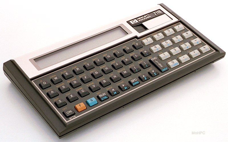

My HP-71B hand-held computer only has 55 keys, with two shift keys (f and g), and a number key pad. Everything is re-assignable, with three kinds of assignments possible, and you could have lots of different key-assignment files and copy one or another into the KEYS file for one application or another, usually for typing shortcuts. The keyboard is about 2/3 normal size (the entire HP-71B being only the size of a large calculator), and with narrow fingers, I was able to touch-type 30wpm on it back when I was doing it a lot.

That HP-71B does look interesting. I'm reading the manual, and there are plenty of ideas there for how to handle a sophisticated mode of calculator input.
and the basic manual hardly scratches the surface as to the power of the 71 had, some of which came through really outstanding LEX (Language EXtension) files contributed by the user groups. I have about 350KB of memory in mine, half ROM and half RAM. I'd still say the 71 is not as practical to use as a calculator as the 41 is though. The 71 is more of a hand-held computer. The 41's keyboard is not suitable for fast typing like the 71's is though, even though I use my 41cx's text editor for entering notes, phone numbers, and Daytimer information. I have an 80-column monitor that works for both though.

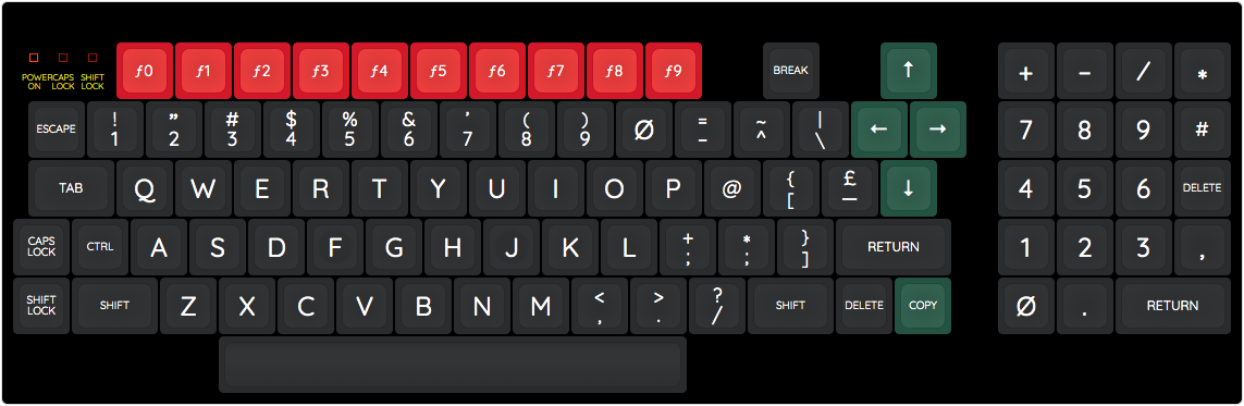

Finally got around to sketching a key layout, to see how it might fit together in practice. As a warmup, I started by trying to replicate something more familiar:
The typeface isn't quite right, but I'm sure many of you recognise that for what it is. Things get somewhat more interesting when I let my creativity out to roam:
The three orange and three blue shift keys are all ganged together, so only take up two spots on the keymatrix in total. Together they facilitate a calculator-style extended keypad on the right, an alphabetic and symbolic group to the lower left, some navigation keys, and 27 function keys that are not yet assigned functions. The large gap to the upper left seems like a convenient place to put a display.
Close examination of the secondary legends should demonstrate that I'm going for an engineering/programming emphasis with my calculator, rather than the financial/statistical emphasis of most existing "scientific" calculators. The upper half of the keypad allows specifying SI prefixes (deka, hecto, kilo, etc. - and of course deci, centi, milli as well), while the units those prefixes apply to can also be specified via the alphabetic keys, thus allowing robust dimensional analysis to be implemented (often very useful for checking the correctness of an equation). The reciprocal units are specified by including the blue shift with the orange, as illustrated by the hertz and siemens legends on the same keys as seconds and ohms respectively. I should also be able to find a way to incorporate the English engineering unit systems as scaled versions of the SI ones, consequently getting straightforward unit-conversion functionality almost for free.
At the same time, all of the printable ASCII character set is included in one way or another, so using this keyboard to enter a general-purpose programming language should be quite feasible. The numbers and +/- symbols require moving to the keypad, but all of the brackets are present on just two keys with appropriate modifiers. (The green legends indicate using both of the shift keys together.)
This should actually be quite fun…
