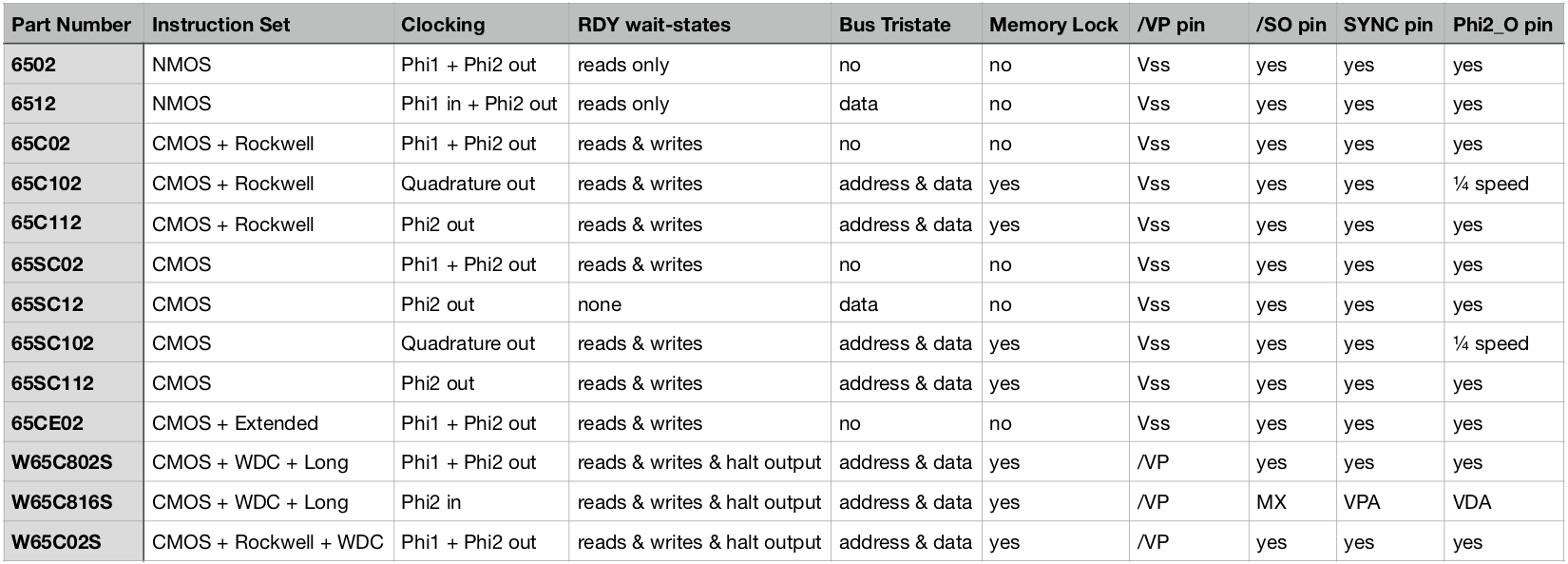

And I came across a very useful table listing all the pin-compatible 40-pin 6502 variants. I can use that!

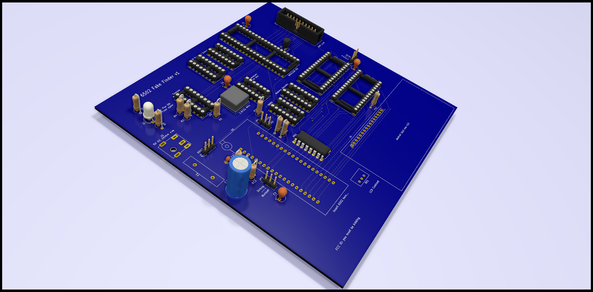

A day of hard work later, I have a 6-inch square, 4-layer PCB layout that passes design rule checks.
I'm not 100% happy with it, as I think the address and data buses would have been easier to route if I'd organised the devices in a different order, but I only had to eat into the VCC plane for a few address lines, and the GND plane is still completely continuous. I may try again tomorrow, after making a backup of this version, and possibly swapping some signals around on the sampling mux and the NAND gates.
But I do have a nice rendering of it…

Meanwhile, here's a distilled version of that model table I found:
