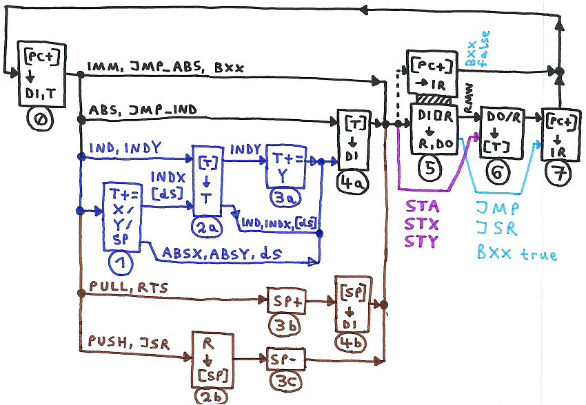

Now for tossing in something different:
Somewhere up in the thread, we had a few words about how difficult the 6502 instruction decoding is,
and this had brought me to the idea of playing the "what if" game:
6502 has a 16 Bit address bus and an 8 Bit data bus, and that's what adds a lot to the complexity of the 6502.
What, if the address bus _and_ the data bus for a "6502 styled CPU" would be both 16 Bit ?
Had tinkered for a week with this idea, and here the results:
PC is a 16 Bit counter, all the other registers are just registers.
The blue shaded registers are not visible to the end user.
The blue bus line is the internal data bus of the CPU.
Now for the state machine diagram:
No more zero page addressing, but all the other addressing modes seem to be there
(just had to add stack relative data and pointers, you sure can imagine how to implement
stack relative pointer with Y register as an offset).
For Bxx false, the ALU does nothing in step 5 while the next instruction word is fetched,
for BXX true the 16 Bit immediate value fetched in step 0 is added to PC in step 5.
Compare this to a rapid transit map:
In step 5, the train is at the station, and "something" happens to the chargo (data).
Adding PEA, PEI and PER to the state machine diagram is left as a homework assignment to the experienced reader.
Point is: we now have a 16 Bit instruction word,
and if one would be using mostly the lower part of the instruction word for controlling the sequencer (telling it which steps to skip),
while using most of the upper part of the instruction word for controlling ALU, registers and flags in step 5,
the layout of the opcode map somehow would resemble a bit the layout of the opcode map of the 6502.
For a 65C02 (and for our TTL CPU), a state machine flow diagram would be at least 4 times as big,
and a lot more complicated because a 16 Bit address has to be calculated with an 8 Bit ALU,
one needs to test for edge cases like page crossings etc.
When trying to implement an instruction decoder\sequencer for the 65C02 functionality plus some extras
by using 74138 decoders, 74151 multiplexers and logic chips, I think this would take more than 150 chips in total,
limiting the speed of a design which has a 2 level pipeline to maybe less than 10 MHz.
Downside of the state machine flow diagram is, that all of the instructions take at least two memory words and two machine cycles.
If one would add a little bit logic which detects single word instructions in step 0, then prevents that PC+ is written into PC at the end of cycle 0 if this is the case
(like in the NMOS 6502 and in our TTL CPU), single word instructions would work, but they still take two machine cycles.
Questions to Drass:
First:
We currently seem to generate the control signals for step 0 by hardware.
If _all_ of the microcode sequences would contain that [PC+] read for step 0, is there a chance for simplifying this circuitry ?
Second:
We now do ALU operation and flag evaluation in the EXECUTE machine cycle.
In which cycle the status register P is pushed on stack when the CPU responds to an interrupt ?
In theory, it might be possible to do just the ALU operation in the EXECUTE machine cycle, while latching the ALU outputs into a temporary register
for doing the flag evaluation and the status register update in the machine cycle that follows EXECUTE.
But I think this would complicate implementing cycle exact BXX false.
Re: Ideas for a faster TTL CPU //6502 related
Posted: Mon Apr 22, 2019 5:07 pm
by whygee
ttlworks wrote:
<musings>
It almost looks like ttlworks is reinventing RISC :mrgreen:
Good luck people, but don't forget to KISS ! 8)
Posted: Tue Apr 23, 2019 1:28 am
by Drass
There’s a bit of logic which kicks in during the FetchOperand cycle (cycle after FetchOpcode). It looks at the opcode and makes decisions as follows:
1) If the opcode is a single byte-opcode, PC + 1 is inhibited
2) If the opcode is a single-cycle NOP, the currently executing FetchOperand micro-instruction is changed on the fly to a FetchOpcode, and a FetchOperand is scheduled for the following cycle.
3) If the opcode is a branch, it evaluates the branch condition. If false, it triggers a FetchOpcode to execute in the next cycle, and schedules a FetchOperand to execute in the cycle after that. This is the “Branch Exit”, which is invoked when a branch is not taken.
FetchOperand is an all-zeroes micro-instruction, and FetchOpcode has only two control bits high, so both microinstructions are trivial to synthesize on the fly. One flip-flop is used to trigger a FetchOpcode in the next cycle, and another to schedule FetchOperand thereafter. So, one 74AC74 does the trick. The real gate count is all about decoding the opcode. This is one reason I suggested using a RAM to decode the opcode in the new pipeline. Another alternative is using something like a PAL, 16V8 would do.
I think the flag evaluation can be done after the EXECUTE cycle while still maintaining cycle accuracy. The flags-logic itself is pretty efficient, so we can clock the P register with PHI2 in the cycle following the ALU operation. (I called this the WRITE_FLAGS stage). The flags would then be available for the second half of that cycle, and can be tested then.
This is the critical point. The branch test occurs during the FetchOperand cycle of a branch instruction, but it happens in the second half of the cycle. The flags would also be evaluated during that cycle, but in the first half. They can be ready in time for the branch test. I’ll post up the timing analysis on this when I get a chance. It’s very tight, but I believe it can be done.
Posted: Wed Apr 24, 2019 4:24 pm
by ttlworks
For the microcode sequences of all 6502 instructions, microcode ROM places a "read from [PC+]" into the control pipeline during an instruction fetch for the next cycle (which would be step 0).
Additional hardware forces a "read from PC+" into the control signals during step 0, overriding the microcode.
And I just can't remember why we had added that hardware...
Aha: you are out to write the flags in the middle of the cycle "step 0".
I think that there is an alternative for writing the flags at the end of that cycle, but it would add some chips to the design:
Drass wrote:
The MT15 carry chain looks great, and it’s much faster for 16 bits. Does it help with an 8-bit ALU?
Spent some thoughts on this by tinkering with other ALU designs for a week, unfortunately it had turned out that they all would be slower (regarding the worst case timing).
Hmm... with 8ns 512kB RAMs, one sure could build a fast 8 Bit adder, but initializing that RAM after power up would require some additional circuitry.
My first TTL CPU had two EPROMs working as 4 Bit ALUs...
