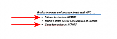

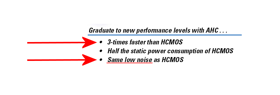

jmthompson wrote:
I'm actually going to be ordering some 74ACT245's this week since I don't have any in my collection
AC / ACT series chips have less propagation delay than HC / HCT (also LS) but their outputs exhibit very fast rise and fall times, and it's well known how troublesome those can be, especially in a poorly controlled environment such as a breadboard.
Luckily, AHC / AHCT chips also have low propagation delay, but without the noisy output transitions. I suggest you consider ordering some 74AHCT245's instead.
IMO this family deserves more attention in our community, especially as it's a "have your cake and eat it, too" solution to the speed vs noise conundrum. :!: AC / ACT series does have its place (such as when driving low-impedance transmission lines) but that implies a special need and a well-controlled environment. For our purposes, AHC / AHCT is usually a much better choice.
Some of the less popular devices are only available in surface-mount packages. But I'm happy to report that mainstays like the '245 and others are also readily available in through-hole packages. :)

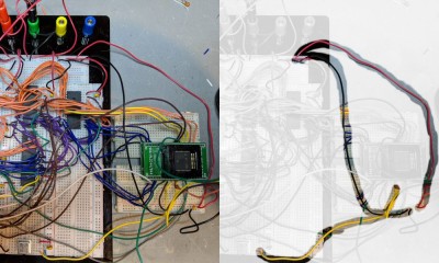

jmthompson wrote:
Someone is going to scream at me now when they see that prototype construction... :)
Um, well.... :roll: :P ... This is a good chance to remind everyone that it's impossible for signal wiring to carry current without the ground and VCC lines also carrying current (in order to establish a complete circuit). In other words, for every signal there will inevitably be a return path. Most of us know enough to avoid a signal path that's longer than necessary, but what's sometimes forgotten is that the ground / VCC wiring, in addition to supplying DC power to IC's, also participates in carrying the AC signal -- ie, it provides the AC return path. And it's best to ensure that the return path is close to the signal path. ("Close to the signal path" generally means "short," because hopefully the signal path is short.)
For example, the yellow wire near the bottom of the image evidently carries a clock signal from the oscillator to the PLCC on the right. But the return path -- the red and black power/Gnd lines -- offers only a circuitous route back to the oscillator. I didn't highlight the entire path back to the oscillator, but we can easily see it's suboptimal. There should be additional power/Gnd wiring that hugs closer to the yellow wire. (Multiple return paths are permitted -- indeed, encouraged.)
In an ideal world we'd have power/Gnd wiring that runs from everywhere to everywhere -- in other words, a ground plane. But, as a compromise, the power/Gnd wiring should include enough redundancy to form a rudimentary grid. This tends to ensure that, for any signal traveling from hypothetical Point A to hypothetical Point B, there'll be a matching return path nearby. This post examines another breadboard project, with respect to the same issue.
ps- among other benefits, bypass capacitors tend to strengthen the grid because, with regard to AC, a cap is "just a piece of wire." Thus the Gnd and power wiring get linked together in every place where a cap appears. You could think of it as being two grids -- Gnd and power -- and the caps interconnect them, resulting in mutual reinforcement. For example if the power grid has a gap somewhere then that deficiency gets patched over by nearby caps and the Gnd grid.
