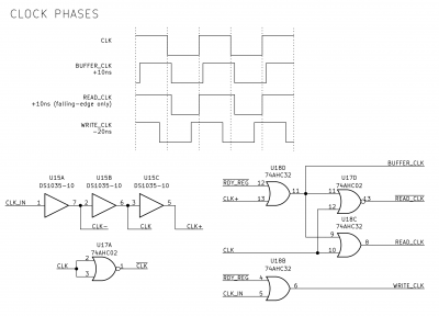

Proxy, I go into the RDY pin in great detail in my video series, starting with Episode 5 and Episode 6 where I talk about what it is in the context of the 65C816 bus demultiplexing, and continuing in Episode 18 and Episode 19 where I use it to generate Read and Write pulses. I specifically pay close attention to the timing delays it generates. You might find this interesting!
I have yet to use it for wait states, but at this point, given that my glue logic has been designed with this pin in mind, it will be pretty easy to do. Mostly connect the slow I/O chip select to RDY_IN with a flip flop or a counter. I just have to make sure that the address decoding + the wait state counting don't delay the signal past the rising edge of the clock.
Here is how I handle the RDY pin, turning it from a bi-directional pin to two unidirectional pins RDY_IN and /WAI. I'm also making the input go through a flip flop, so the logic can stabilize before the CPU reads RDY and stay consistent throughout the cycle
Here is how I generate my clock phases, taking into account the registered RDY input. I've had to generate a few phases to satisfy the hold times on reads and on writes. All phases are OR-ed with RDY similarly to what you're doing.
And finally, here is how those phases are used for read-write pulses
This is in discrete logic and so relatively slow. I could scale it up to probably 6MHz in spec, more with overclocking. At the moment my address decoding is the limiting factor. But if you're on a CPLD I suspect it can scale quite a bit more.
All in all, I think this is a good base to have in the glue logic to be ready (!) for wait states! :wink:
Re: Generating Wait-States with Clock Trickery
Posted: Thu May 12, 2022 9:29 pm
by Dr Jefyll
I'm not sure why you feel the flip flop is necessary. Its input comes from a memory-address decoder, isn't that right?
My own approach would be for the decoder output to directly (ie, w/o any flipflop) cause the CPU's RDY pin to be pulled low. And if you pull the CPU's RDY pin low then you're assured that the address won't change when the cycle ends, and hence the decoder's output will remain stable.
Posted: Thu May 12, 2022 10:00 pm
by akohlbecker
There is a window around the falling edge of the clock where the CPU is reading RDY. It can happen that RDY goes low during this window and whether the CPU actually registers it is then undefined. However, the rest of the glue logic will still change state. Specifically, with my 65C816, I want the bank address latch to open if the CPU is proceeding with another cycle, but stay closed otherwise. The Latch Enable signal is combinatorial and not synchronized with the CPU's view of RDY. Similarly, the read-write pulses also need to toggle if the CPU is proceeding. So I added a flip-flop in front to ensure either all of them see a low RDY or none of them, in a given cycle.
You're right that wait states are synchronized with the clock and probably don't need this safety, provided your signal propagates outside of the CPU window. However, other use cases can trigger RDY at any moment, like DMA. Ben Eater's VGA card, for example, pauses the CPU while the display is active and it is reading from memory, independently from the main CPU clock. Thinking about RDY and BE from the perspective of using this card and making it safe, has been an interesting challenge for me!
