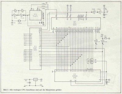

Rockwells circuit is the typical standalone TTL crystal oscillator. Completely independant of anything else. The same here:
(called (C)EPAC, a publication from the German monthly c't)
Using this autonomous oscillator circuit allows to insert a clock divider (which in turn permits the use of smaller and/or cheaper higher frequency crystals). They use LS14 or HC14 (schmitt-trigger) that performs a little better for the reset circuitry (upper right corner) and not worse within the oscillator.
I think the older MOS circuits are created to minimize the amount of glue logic. In 1975 each gate was valuable :)
Re: Clock circuit for NMOS 6502 - Gate Delay on Phi2?
Posted: Wed Jul 25, 2018 11:14 am
by BigEd
Might be worth noting that these days clock cans are much preferred - they are encapsulated oscillators, literally.
Also might be worth noting that a clock divider gives the possible advantage of a 50% duty cycle, and control over the edge rate and drive. (Clock can specs can be 40/60 or similar, IIRC.)
Which is what I've decided to use in my build (see first post). And the double inverter can stay where it is, so I hopefully won't be creating any new timing issues.
