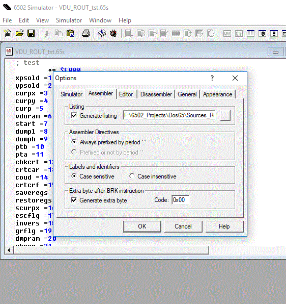

Today I've solved another misery.
The assmbler would crash after the 2nd pass. "Program has stopped working"
It was caused by the path to the listing being invalid(From a previous setting on a memory stick)
The place to do this is attached.
(And it was a nuicance to find. :evil: )

Guus Assmann wrote:
The first part, using the BRK instruction compiles into two bytes. And I think it should be just one byte, like I get using the .DB directive.
As Ed noted, BRK (and COP in the 65C816) is a two-byte instruction—the WDC data sheet actually mentions this. However, in the Kowalski simulator, there is an option to make it assemble (not compile!) BRK without a signature byte. Click on Simulator on the menu bar, select Options and then click the Assembler tab in the dialog box that will open. Near the bottom of the dialog box you will see the appropriate check boxes.

In the case of the Kowalski assembler, it's not a bug. It's a design feature that gives the programmer the option to have any signature byte assembled after a BRK instruction. The default if this feature is enabled is to assemble $EA (NOP) as the signature byte. If this feature is disabled, only $00 will be assembled for a BRK instruction.
