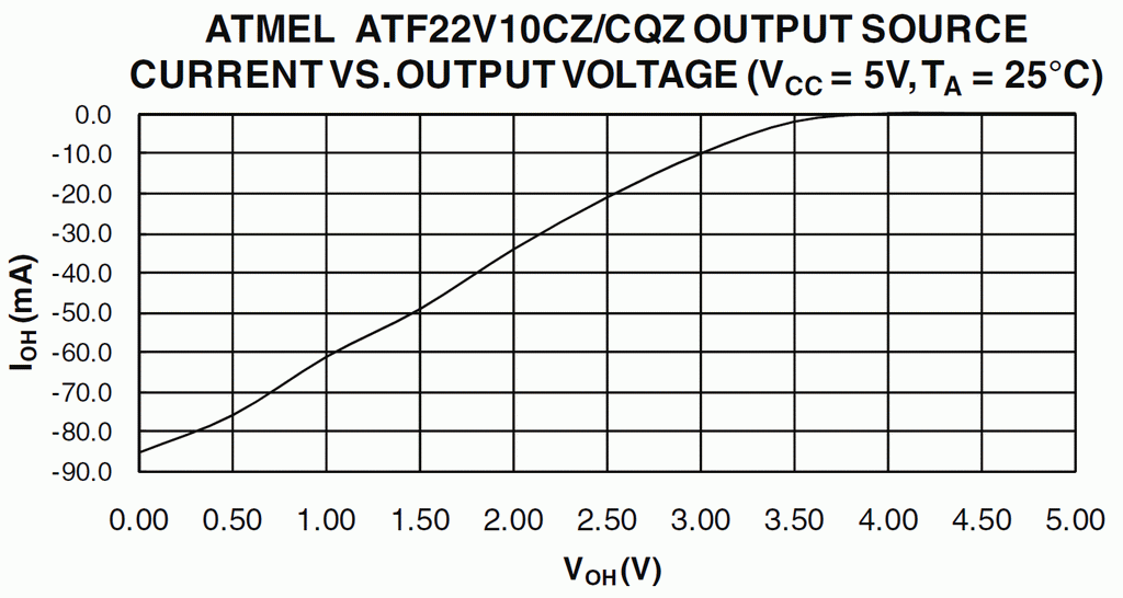

Note that the final board is using the newer low power version of the AT22V10CQZ...
According to the Microchip (Atmel) data sheet, Voh minimum for the GAL is 2.4, which is below what would be considered a solid CMOS logic 1. Interesting...

For the benefit of others, here's the graph to which Bill is referring:
GAL22V10 Voh vs. Ioh
Note that the GAL's Voh doesn't get anywhere CMOS logic 1 territory until Ioh is vanishingly small. While a CMOS input draws virtually no current when the circuit driving it is quiescent, the GAL has to contend with transitory loading by the circuit's parasitic capacitance. Although the above graph indicates that the 22V10 will produce 3.50+ volts as the load approaches the microampere range, much more current will be demanded while the parasitic capacitance is being charged to Voh. Unavoidably, signal edges will be rounded to some extent, creating the potential for unreliability at higher clock speeds. The result is the Fmax for any given circuit could be much less than what timing calculations suggest it should be.
Incidentally, the 65C816's data sheet indicates that Vih must be at least VDD × 0.8 to be recognized as a logic 1. That's 0.5 volts higher than the theoretical Voh of the 22V10 when loaded at the microampere level. On paper, it shouldn't work, an observation that gets back to a past topic concerning the true nature of the 65C02's and 65C816's inputs (TTL or CMOS).

I beg to differ BDD. That diagram is not accurate nor precise enough to see what is happening at the low uA range (~1-25uA) which is what we'd typically see in our little systems. I mentioned that diagram only to note that the spec of 2.4V is for unusual conditions. Vcc at minimum and Ioh at 4mA.
I'd be willing to bet the price of a shiny new W65C02 that if you loaded one of these GALs with 50K resistor (~20ua) you would see better than 4V at the output. I'd go further to let you test 1000 of them to see if you could find one that did not deliver better than 4V.

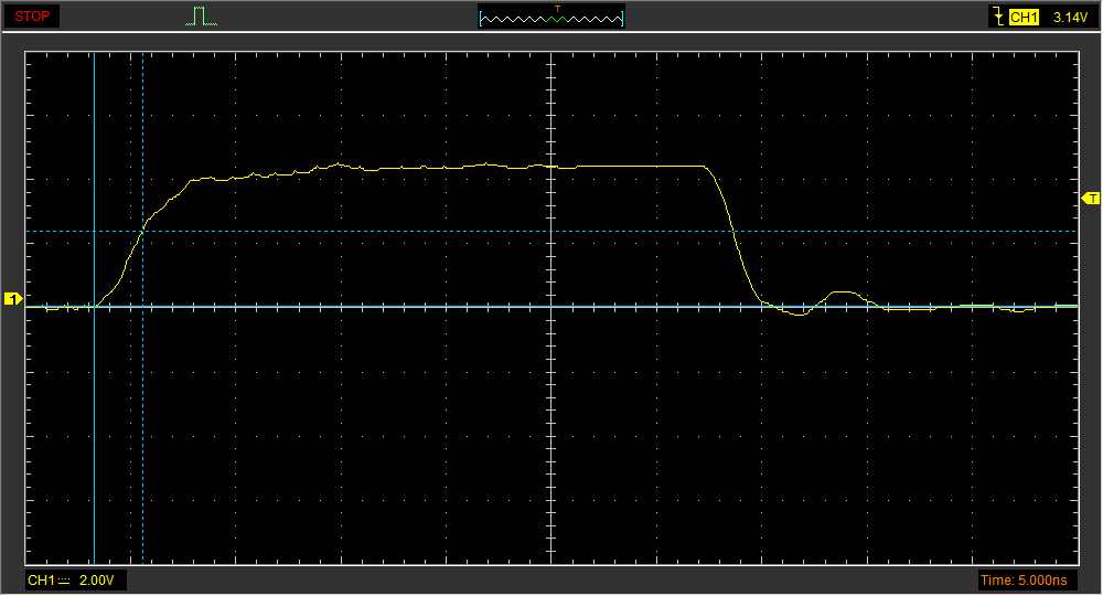

The below traces are the /OE signal in my recent project at 16MHz. This signal drives both the RAM and the ROM /OE and the line, with chips inserted, and scope probe attached measures at 55pF and 257K ohms, both measurements taken at 10KHz. We can see the following:
1) Rise time (which is not very significant for a /OE signal) to 2.4V = 2.3ns
2) Rise time to 4.0V = 4.7ns
and, most significantly
3) Fall time from 4.46V to 0V is only 3.4ns
(not sure why the actual measurements don't get put in the trace image files - a bug in the scope software?)
1) and 2) demonstrate an important characteristic of MOSFETS. That once turned fully on, (~1ns in this case - see where the rising edge turns most vertical) they can and will pass significant current until thermal effects begin to take hold and increase their resistance. Using the formula Garth gave us, we can see the initial current (0V-2.4V) averages at ~57mA and that the average current to drive the line all the way to 4V is ~47mA. Considerably higher than the 3.2mA suggested by the data sheet of this Lattice GAL20V8C which, as usual, gives us less information than we really need to determine if a device will actually suit our needs.
3) Shows that in this rather typical situation, the GAL will indeed produce a valid CMOS Vih of 4.46V. Not only that, but it will assert the /OE signal from that 4.46V all the way to 0V in just 3.4ns - an average current sink of ~72mA.
Now, after having said all that, the scope probe itself adds a measured 16pF load to the line, so the actual performance will be better than depicted here.
