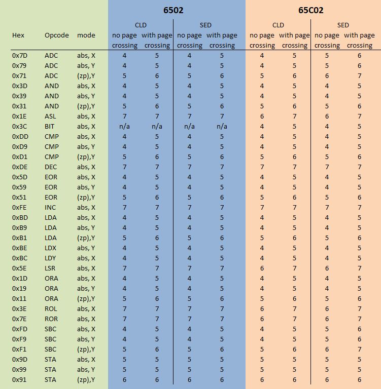

Well,
I ran the Visual6502 this morning using this code:
	*=	$0000
	LDX	#$80
	LDY	#$81
LOOP	LDA	#$21
	ADC	$0080, X
	ADC	$0080, Y
	ADC	($80), Y
	SED
	JMP	LOOP
0080	.WORD	$0082
0100	.BYTE	$22
0101	.BYTE	$23
0102	.BYTE	$24
The first time through, the ADC instructions used the extra cycle for page crossing, as expected. After the SED and jump, they used the exact same cycles. I thought that if decimal mode was set, these will use an added cycle for any BCD adjust. I even tried it with a carry past 99 but the extra cycle does not appear.
I adjusted X & Y so a page was not crossed and I used 1 less cycle as expected. The BCD math did not add a cycle in this case either.
Am I missing something, or is this a Visual6502 bug?

I think only the 65C02 takes an extra cycle for BCD. It was one of the innovations of the 6502 - the sole patent I think - that it takes no extra cycles for BCD.

Ok, thanks! The Kowalski simulator is adding 1 cycle for both 6502 and 65C02. More artifacts to document.

I've updated the V1.2.6 source to correct the cycle counting for both the 6502 and 65C02, based on as many sources as I could find. I also fixed the Command Log so it would show the disassembled line and resulting registers on the same line. Before, the resulting registers were 1 line below the source. I also added the number of computed cycles for each instruction as well.
It went from this:
1000  A9 90     LDA #$90       A:00 X:00 Y:00 F:20 S:1ff
1002  85 90     STA $90        A:90 X:00 Y:00 F:a0 S:1ff
1004  A9 02     LDA #$02       A:90 X:00 Y:00 F:a0 S:1ff
1006  85 91     STA $91        A:02 X:00 Y:00 F:20 S:1ff
to this:
1000  A9 90     LDA #$90       A:90 X:00 Y:00 F:a0 S:1ff Cycles=2
1002  85 90     STA $90        A:90 X:00 Y:00 F:a0 S:1ff Cycles=3
1004  A9 02     LDA #$02       A:02 X:00 Y:00 F:20 S:1ff Cycles=2
1006  85 91     STA $91        A:02 X:00 Y:00 F:20 S:1ff Cycles=3
Here is a chart of the resulting timing of the instructions that cross page boundaries and/or are affected by the decimal flag:
A black & white pdf version is attached here:
cycle counts.pdf
(314.05 KiB) Downloaded 180 times
I am attaching the modified program, which carries version 1.2.6.1 for now.
6502.zip
(539.28 KiB) Downloaded 169 times
Daryl
For what it's worth, JMP (ind) and JMP (ind,X) also involve possible crossing of page boundaries.
This is wonderful work you're doing, Daryl. Thank you! :)
One other point has to do with 'C02 undefined NOP's. (Unlike undefined NMOS ops these are very simple.) Dunno if it merits your attention, or if the simulator even recognizes them, but some of those instructions *are* occasionally useful (as a trick to avoid coding a BRA instruction). Details here.
